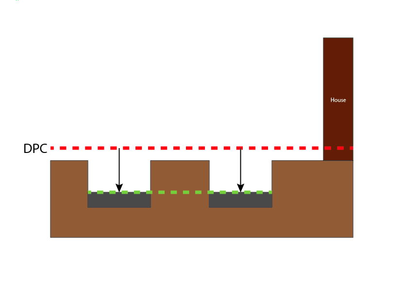

Hi,
I am due to start digging foundation trenches very soon, and it will have to be done in sections due to being in quite soft clay. What I'm trying to figure out is: what is the easiest way to ensure the tops of all the concrete foundations are perfectly level with each other, so they all eventually join up to form one continuous level slab?
I've attached an image to illustrate. I need to ensure all the sections have the same concrete level (green line) - an equal depth down from the DPC level (red). Someone suggested a laser level but didn't elaborate on what to buy or how it should be used. They seem to range from under £100 to over £1000. Are there alternative methods?

A laser level with a sensor-on-a-stick is ideal. Put the laser on a solid surface so that the beam is shining across the site and is in the 'sensor' setting. You then set your first datum peg in the ground at the desired height and set your sensor to this peg. All the other pegs can be set from this datum point using the bleeping sensor.
Has that foundation been designed? It's a very poor foundation that will not form a continuous strip for load bearing - which is exactly what you need on soft ground.
As for leveling, a level string line above ground and use a gauging rod not a tape.
This method was given by a structural engineer. 600mm wide footings and quite deep (final depth of concrete TBC), interconnected with reinforcing bars. Structure is a single storey extension with flat roof, so not excessively heavy.
That's ok then. Btw, it's not the weight of the extension that matters, but the stability of the ground.
I level a profile or stake and run the line from this to the DPC.
