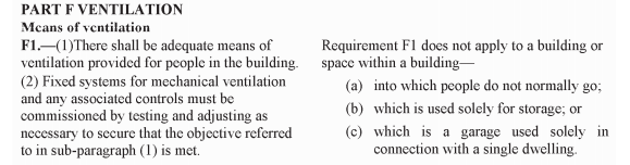

The room is about 7.5 cubic metres and has no opening window so to meet building regs needed an extractor fan.
Not entirely correct.
Building Regulations:

I'm only doing this to satisfy the very fussy building regs inspector who is visiting shortly to sign off the kitchen.
In that case the utility is nothing to do with it so he can't refuse to sign off the kitchen. But anyway he's not going to come round everything time you do a load of washing to check is on so don't bother with the timer and just leave it switched off.
If you're really set on a timer just get a plug in one and wire the fan up to a plug.
