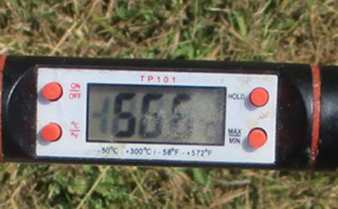

What would be an appropriate de-rating factor for the cable when inside a black conduit that was being heated by solar radiation ?
Just conducted as experiment, 2 feet of 25mm black conduit horizontal in free air and in direct sunlight with a mercury in glass thermometer inside the conduit, .... After 10 minutes the temperature inside the conduit was 110°F = 43.333°C.
I've just had a go with some flexible black conduit, and, even with the haze (virtually no shadows), got figures very similar to yours. Assuming tomorrow is less hazy (and even hotter), I'll try again tomorrow and report back!
Haze now gone, and garden air temp about 32.2°C . After about 10 mins in full sun (hard to photograph because of sun - reads 56.6°C) ....
View attachment 274789View attachment 274790

Haze now gone, and garden air temp about 32.2°C . After about 10 mins in full sun (hard to photograph because of sun - reads 55.6°C) ....

In attempting to investigate that this afternoon, after about 5 mins in full sun I got this ...
However, when I looked again about 10 minutes later, the electronics of the thermometer had obviously got rather overcome by heat and it was displaying gobbly-gook :)

No, I'm not forgetting the other side of the equation - as you say, the ultimate temp achieved will represent an equilibrium between heat acquisition and heat loss. However, as you say, at any given temp the heat loss by convection from from a white tube will be less than from a black one, whilst heat loss by convection and conduction will presumably be about the same - so the total rate of heat loss will be lower with white.
However, it seems that that is not enough to make my thinking work, since you seem to be correct in your view of the situation. Having cooled down my thermometer and taken steps to protect its electronics from heat, after about 30 mins I'm currently seeing ('only') about 47 degrees. I obviously don't know what is going to happen subsequently, but the sun is starting to 'go down' - so that might well happen to the tube temp as well (and, as previously said, tomorrow will probably be 'useless'!
