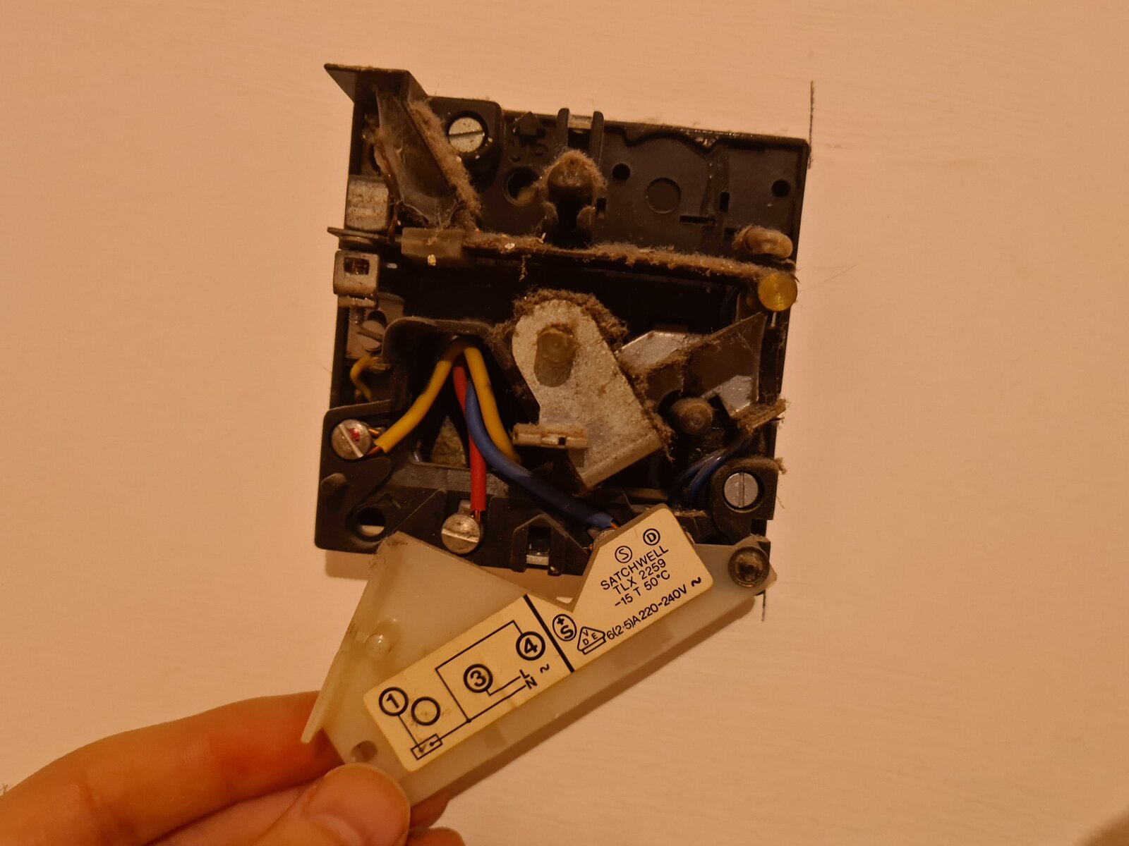

I'm in a similar boat and looking to replace tlx2259. Wiring looks like this - can anyone give me a steer on what is is/isn't compatible with? Ideally I'd get a Google nest. Newbie here - any help much appreciated!
At the moment no images, got a feeling it is the site being slow. However gas boilers come in two flavours, non modulating and modulating, the latter is either controlled by a thermostat connected to ebus, or the TRV heads. Seems unlikely yours connects to ebus so the TRV is likely king.
However unless linked to the wall thermostat, the TRV head can't turn boiler off/on it can only turn it up/down, so a wall thermostat is normally fitted in the hall, and its only job is to turn off heating on a warm day.
But I found out the hard way, setting up central heating to work with TRV heads is not as easy as it seems. Very likely nothing wrong with thermostat, just not set up right.
