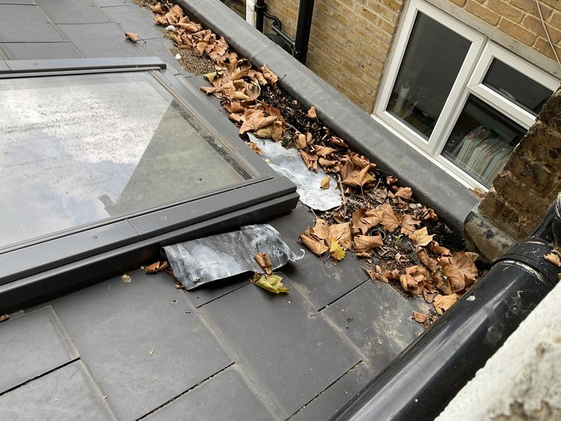

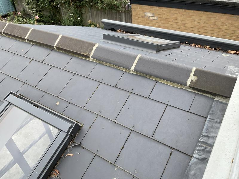

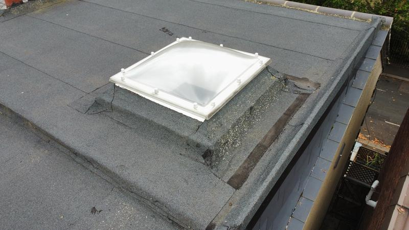

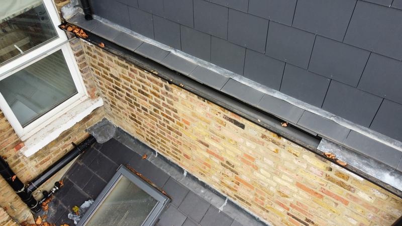

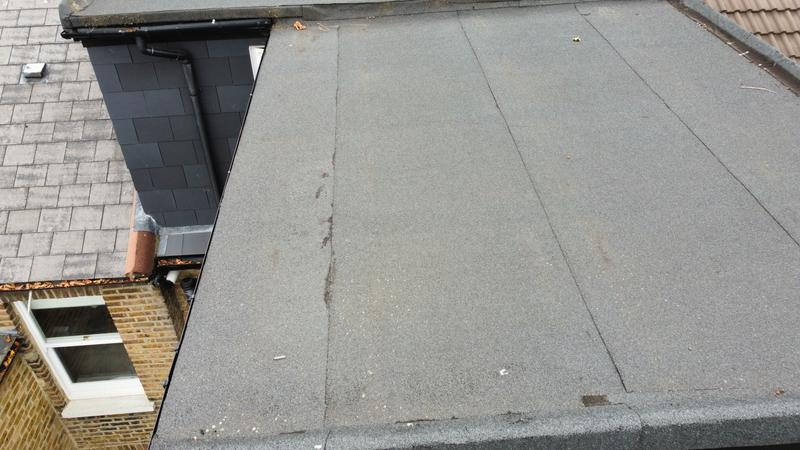

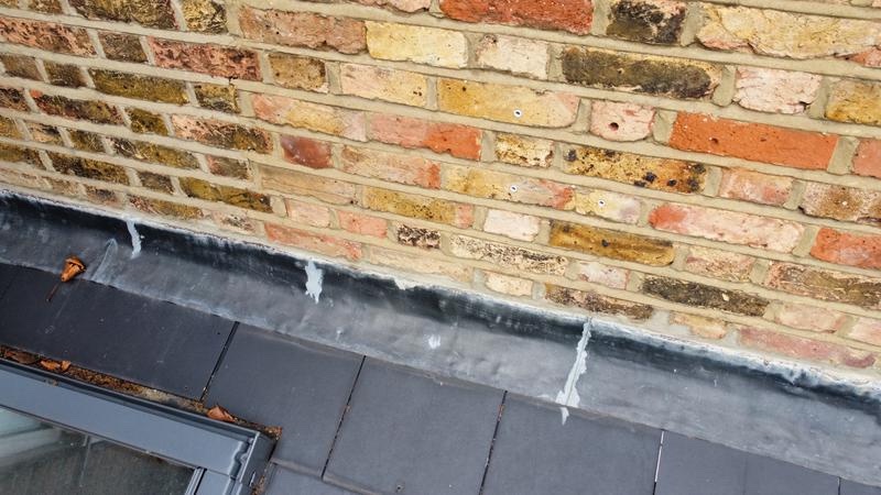

Survey says "poor workmanship" on recent loft/ extension roof, how bad does this actually look?
20 Sep 2026
Buying a Victorian house in London that had a loft conversion and rear extension done around 2019.
We've had a Level 3 survey and structurally the house seems broadly fine. There's no current evidence of leaks, and the surveyor says the main roof coverings are in adequate/good condition.
However, he's pretty critical of some of the newer roofing work and says: "The quality of the workmanship undertaken to the roof is poor. Recognised good practice has not been adhered to."
Main things he's flagged are:

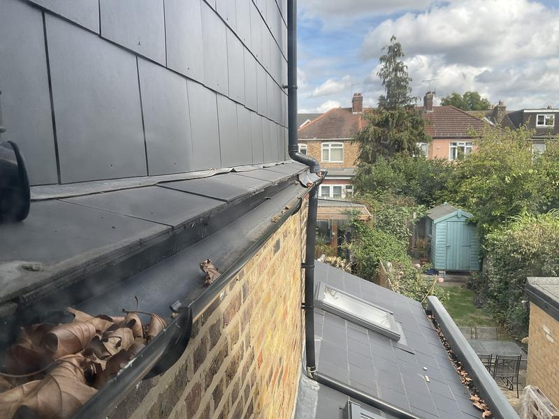

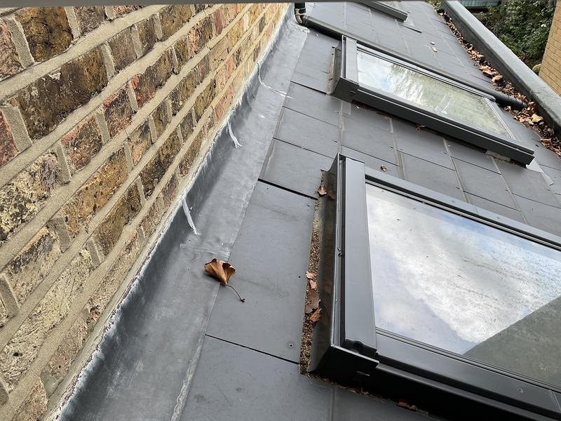

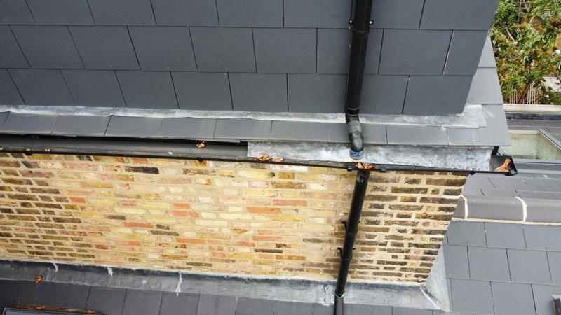

overly long lead flashing, with some splitting poor detailing at the eaves, including loose lead being used to direct water into the gutter
split lead on the rear extension that's previously been patched with mastic
questionable flashing/detailing around rooflights and wall junctions
inadequate gutter support / some debris getting around the soffits and hoppers
Photos attached.
For anyone who knows roofing/leadwork, does this look like fairly localised poor workmanship that a decent roofer could rectify, or would you be worried about the installation more generally?
And very roughly, what would you expect the necessary remedial work + scaffolding to cost in London?
I'm getting roofers to inspect it before exchange, so mainly looking for a sense-check on whether the surveyor's wording matches what you can see in the photos.

The flat roof light flashings looks like a lash-up. Some of the weather detailing looks suspect especially the hidden gutter trapped behind the parapet. None of it looks easy to maintain. None of that lead looks easy to get at.
I'd run a mile just from being asked to have a look at it.

The photos show details worth resolving, but they cannot establish whether the whole installation is defective. Before exchange I’d ask for:
• a roofer experienced in leadwork to list each defect, likely water path, and whether it needs repair or renewal — especially the rooflight flashings, parapet/hidden gutter, split lead and gutter support;
• dated close-up photos and a fixed written scope/quote, including scaffold, making-good and VAT (not a blanket “re-seal” allowance);
• invoices, guarantees and Building Control/completion paperwork for the loft and extension, plus any maintenance history;
• a second independent inspection after wet weather, with roof-void checks where accessible.
Keep the survey, photos and quotes together and agree exactly what will be remedied before exchange. The roofer should explain falls, outlets, laps and flashings, and how water is kept out of the brickwork — not just propose mastic.
