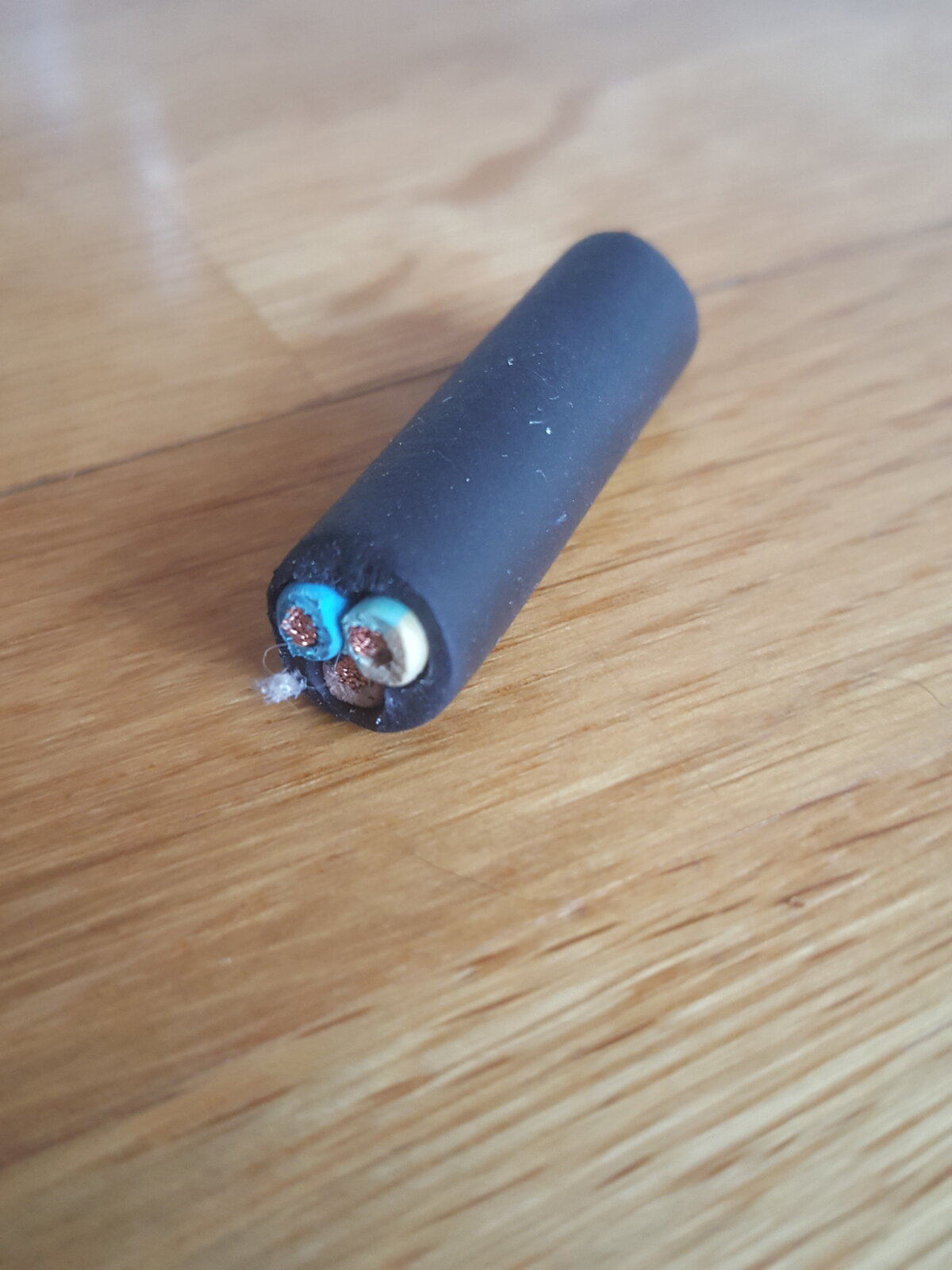

I've now disconnected the aerial cable that was crossing from the house to the garage, it was 2 x 1mm t&e wired off the lighting circuit so it was inappropriate for the job. Presumably done by the house builder to provide lighting only in the garage. And now it's disconnected the property is compliant per the Certificate.
I asked an electrical wholesale shop what cable is best to use so I can have a socket & lights in the garage and he suggested either a) a 2.5mm t&e Rubber cable (photo attached) which looks like a larger version of a flex cable as it won't deteriorate in the sun or b) what looked like an armoured cable but with a silver / translucent outer sheath, again in 2.5mm.
I'm still going to use the tensioned wire to support the span to avoid digging up the patio and I assume the armoured cable he showed me will be the better choice ?
If I terminate it at either end in a Jcn box inside each building there's no need for glands etc. Then run normal 2.5mm t&e from the attic jcn box to a fused outlet or a socket fed from the ring main and at the garage end run normal 2.5mm t&e from its jcn box to a double socket and a fused spur to the 2 garage lights.
Nice & simple, no need for a garage CU and can be unplugged / isolated in the attic if ever I need to.
Does that sound ok ?

That cable "what looked like an armoured cable but with a silver / translucent outer sheath" sounds like SY cable and should NOT be used outside as it is generally not suitable for the UV (although some brands are) - I would not use it.
For the length you want why not go full SWA?
