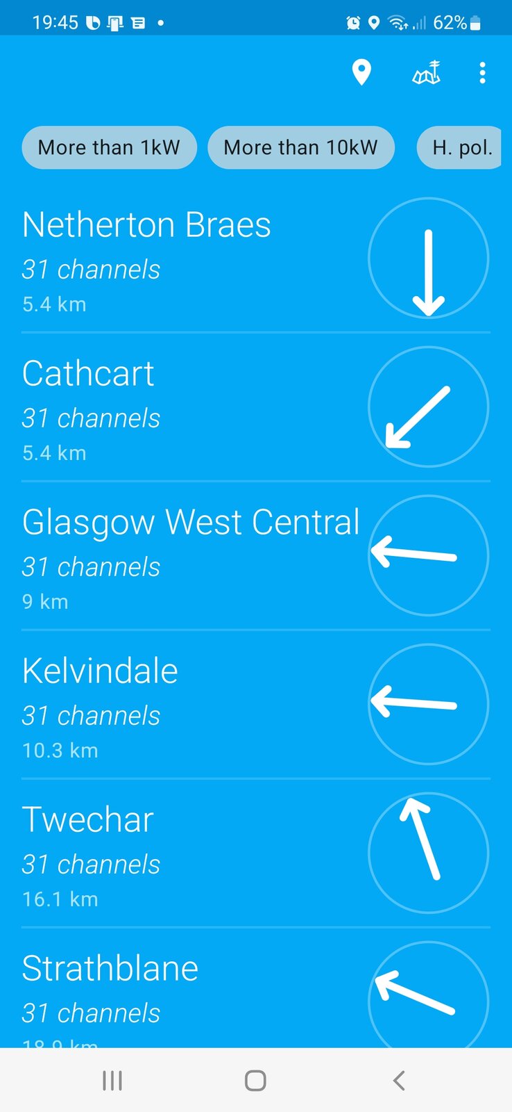

It won't work as my house is between the Summerhouse and the transmitter. I also have a caravan so I have an app on my phone that shows the direction of all nearby transmitters. The app is great when arriving at a camp site.

out of curiosity what is the app that you use?
The app is called "DTV Antennas"
The screen shot shows what I see at home. Clicking on a transmitter gives more info including is the antena needs to be vertical or horizontal, this is handy in the caravan
