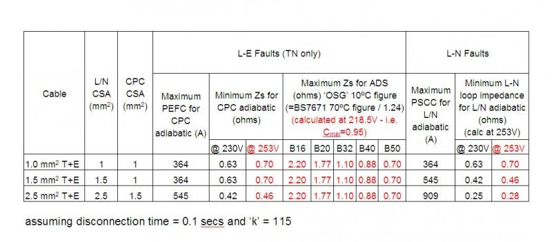

Indeed, that's what I said (or, at least, implied!) in the previous post. As I also said, per discussions (and calculations) we had a little while ago, a 'surprisingly small' cable gets adequate fault protection from a 40A MCB (IIRC, the calculations I did were for a 50A one) - so it's likely that, even if one is being 'pedantic', what the OP has is probably OK. I'll see if I can find the figures.
Kind Regards, John
The cable needs no overload protection. It needs fault protection. You need to decided/determine if it does.
Found ....
The red figures relate to what the situation will be next year if Amd3 of BS7671 sticks to Cmin=0.95, as in the draft, rather than the 0.94 which I, and others, suggested to them would be more sensible.
Kind Regards, John
