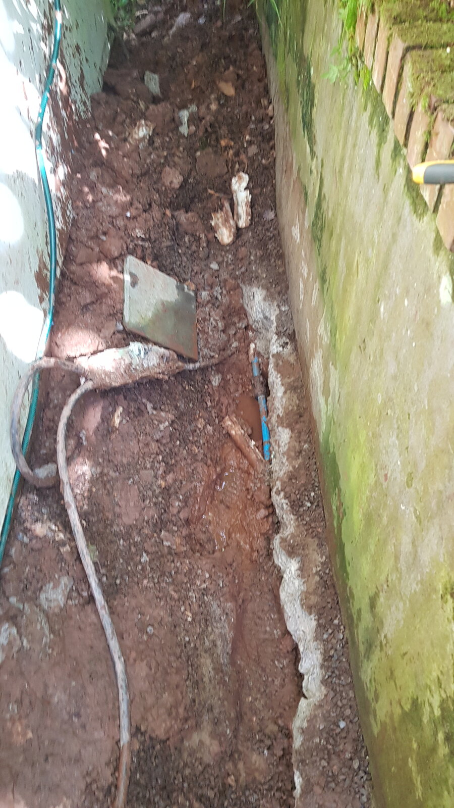

SWA failure.
Sitting right next to a leaking watermain...which has been leaking for months based on the ground I was digging out.
Howver, given that the garage (left hand spur) remains sound, how do I tell if this really is the problem...or do you agree based on its condition it almost certainly is?
Thought you might say that. I am not happy with how shallow it is..nor that it runs under a retaing wall. Would it be better for me to fit a junction box on the retaining wall on the right ( there is plenty of loop on the cables) so that it is obvious there are cables there ? It also dets it clear of the water main.
Also..the house is a PME fit, and currently the earth is exported to both garage and shed...about 100m away as the cable runs via the protective mesh. Would I do better to breat the earth and fit new earths at each?

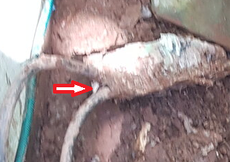

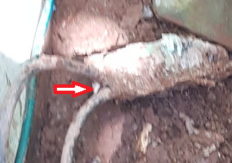

To me it looks like the seals have failed and the box has been flooded.
Inside the box there could be quantities of rust from corroded steel. This would be conductive and could explain the voltages on low impedance that you measured.
I would seriously look at replacing the entire cable as the amount ( length ) of corrosion of the SWA is un-known
As per my post near the beginning.
Water can travel uphill as well as down hill due to capillary action. This is particularly true if the cable is stranded wires.
I'd stop all the faffing and run a new cable in, making sure you keep both ends sealed until you are ready to terminate them.

That looks like it took some effort to expose! That does look like a proper Y resin joint compared to the butchered one you found serving the shed. It’s probably failing though and water has found its way inside and stared to corrode the connections or when it was connected together the joint wasn’t tightened well enough and its burnt out. Hopefully cutting that out and replacing it will fix your voltage problem (y)
I would install a new underground joint personally.
If properly installed, there is no better joint available. Unfortunately it appears your joints have not been installed very well.

Update. Joint was completly shot, and water had got in. But now the mystery. Can someone explain why there has been no problem with supply to garage, yet with the joint removed and cables rejoined to garage only, the mcb now breaks even with the wires open circuit? Currently inside an IP68 box in a terminal block to prevent damage. Tested voltage..fine. but wht would mcb go when open circuit when it didnt go when in the damaged join?
RF...in wales. Cannot use an underground joint ...cable only 10cm beneath path. So will put inside proper underground conduit, and use pratley orange box on retaining wall so it is clear it is there. If I can get the cable problem fixed that is.
