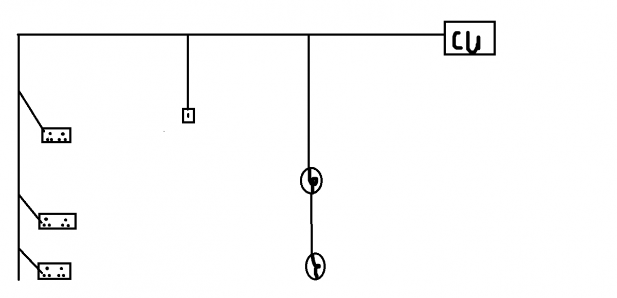

I think i might run a single piece of conduit straight from the consumer unit around the top of the wall and then tee off for lighting, switch and sockets with the 1.5 and 2.5 inside.
That's what I did for my last such job for a neighbor in England in a small workshop. Having the horizontal runs up out of the way and just vertical drops to each socket left all the wall space between sockets and switches clear for tool boards etc. Horizontal runs between sockets at a lower level would have gotten in the way rather more.
