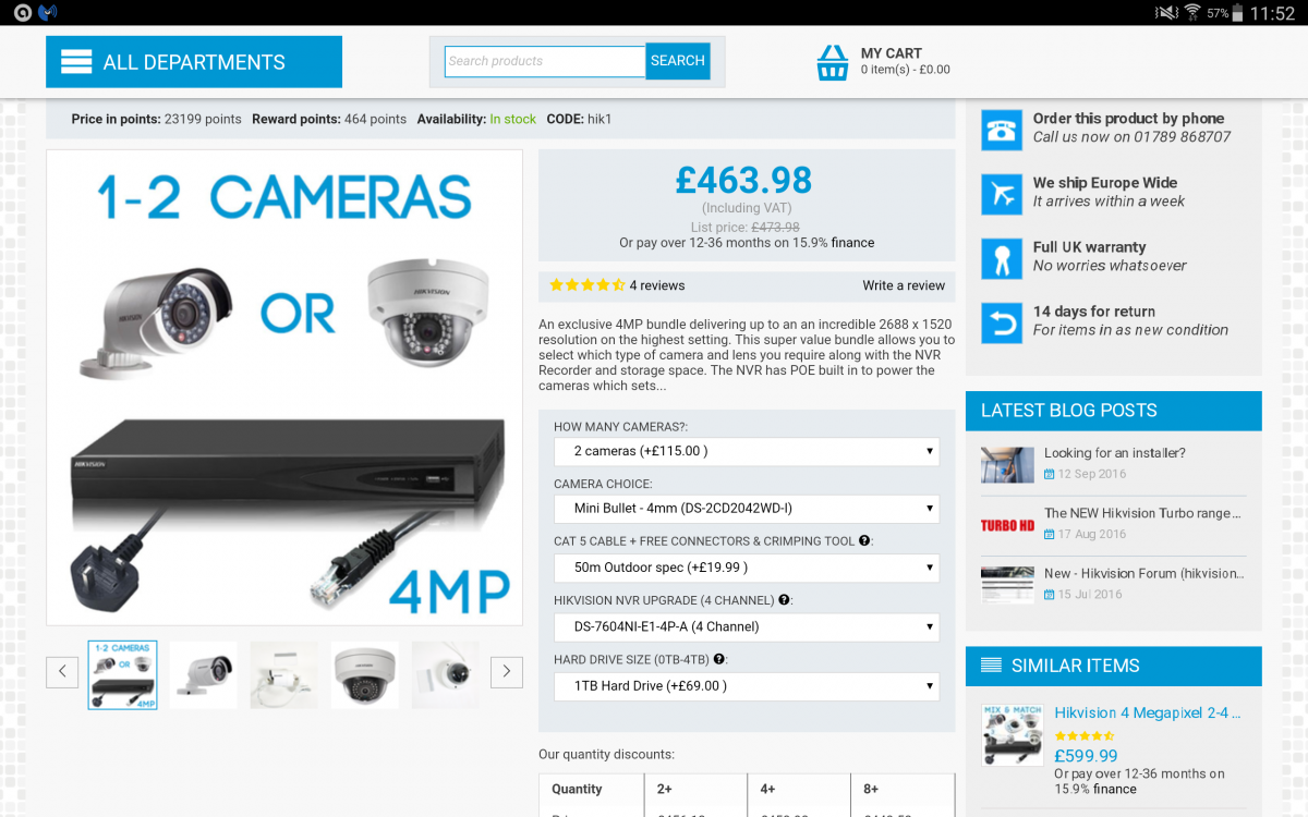

This is the Hik kit I looked at
Includes a NVR
Can you advise where you got your kit from

For a start you never said it was an IP camera system , are you sure the Swann is an IP camera system ? At 4mp recording that 1tb harddrive ain't going to last that long ...even more so a 500gig on the Swann system...!
