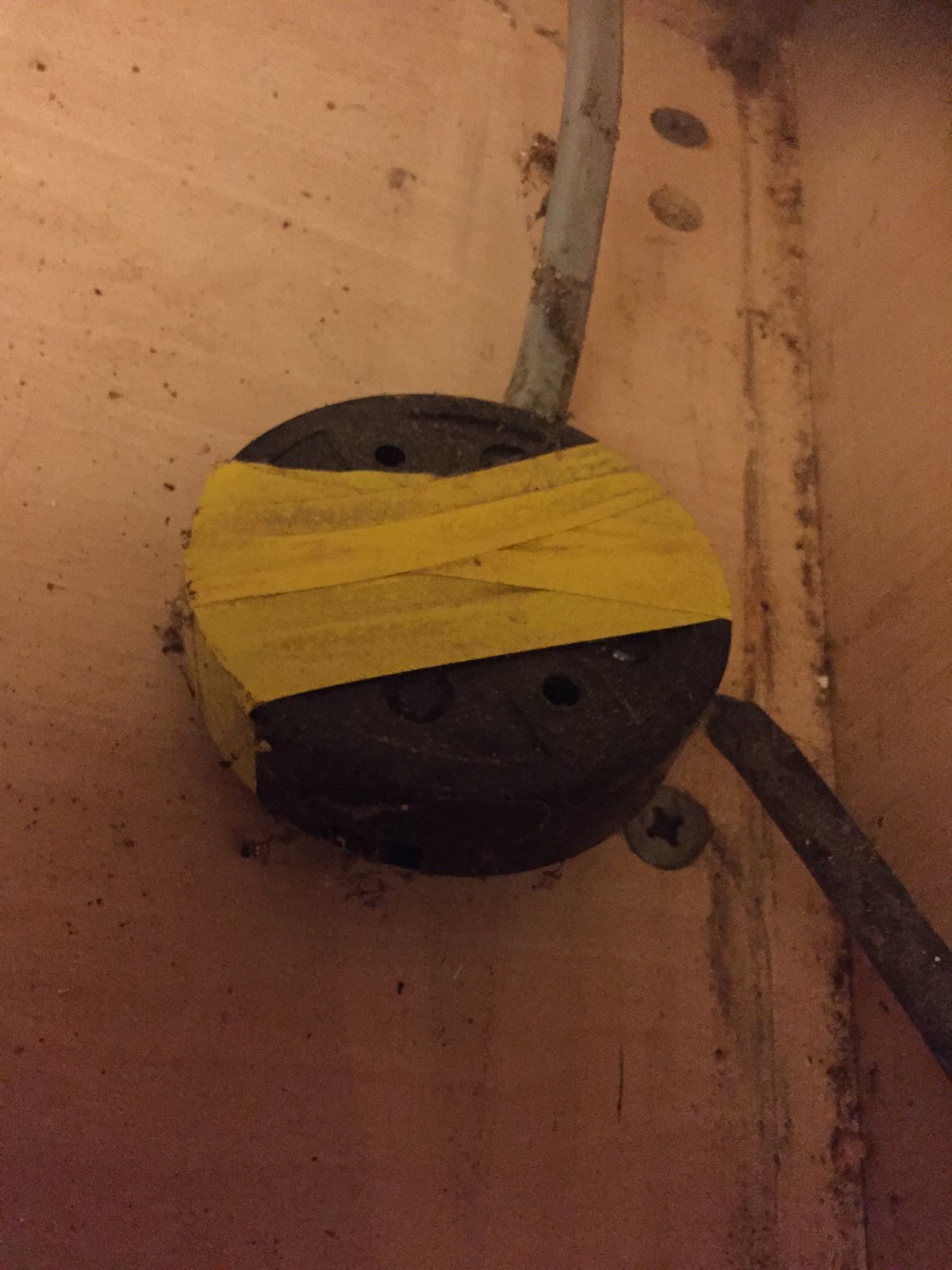

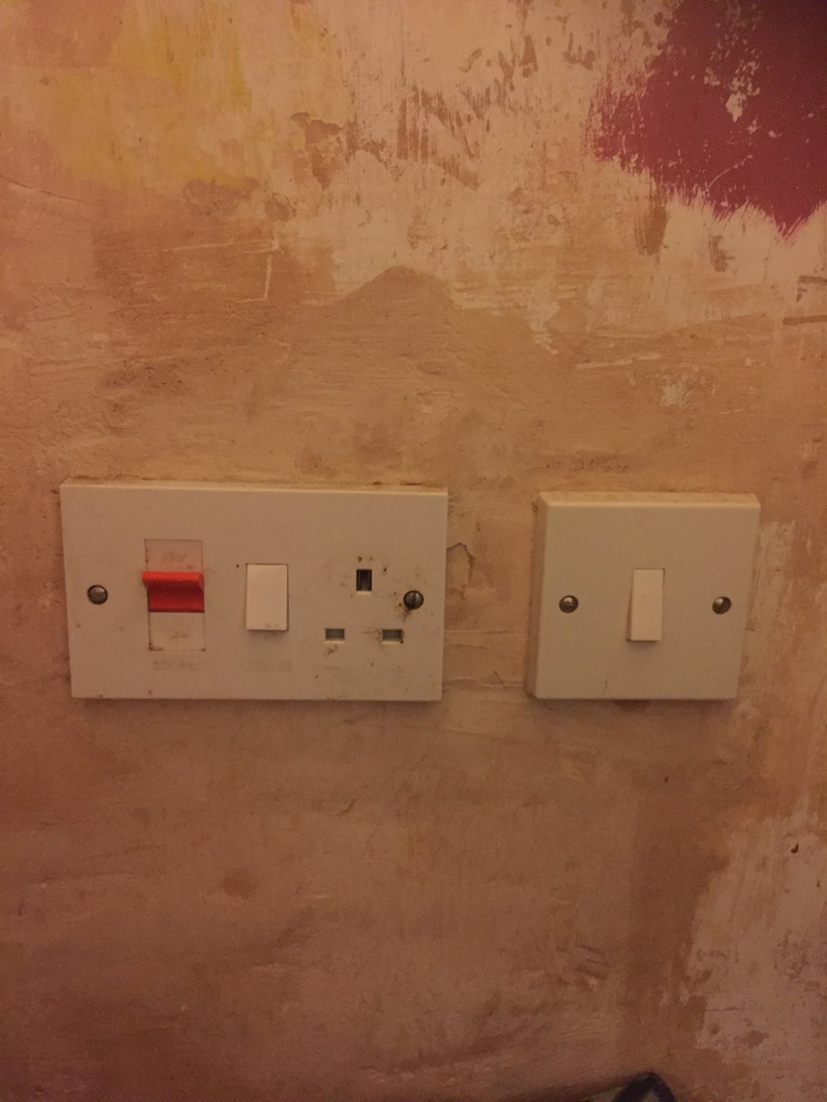

Hi all,
So our trusty old Ariston built-in oven has given up and the two of us here were both convinced it was plugged-in (a spark fitted it for us along with a standalone hob many moons ago, installed all the circuitry to replace our gas cooker). So we've (perhaps unwisely) gone out and bought a new one with a plug and, having undone some screws and pulled out the oven, discovered it's actually wired to some sort of junction box (see picture) which is in turn wired to a switch on the wall (see other picture, it's the switch on the right, the other controls the hob).
My question is, can I easily (and safely) connect the oven to the switch without removing the oven's own plug and if so, what would be the best equipment to use? Many thanks for any advice given!

You need a pair of side cutters and a screwdriver minimum. Wire strippers would be useful.
Remove or cut off the plug on the new oven and wire it into the junction box where the old one was.
Don't like all that tape over the junction box. Is it broken? Would be best to replace it if so, preferably with a cooker outlet connector.

We don't really want to cut the plug off as this will surely void the warranty, we were thinking more along the lines of replacing that junction box with a socket, like on an extension lead. Would that work? Thanks.
Yes. Make sure it's screwed onto something this time, not just dangling.
Do you have enough depth behind the new oven to fit a surface mount box?
Yes. Make sure it's screwed onto something this time, not just dangling. Do you have enough depth behind the new oven to fit a surface mount box?
Yes, there is some room. Can you recommend something that would do the job? Thanks

So much easier to cut off the plug and wire it in. Why complicate the issue?
That junction box looked switched by a 45 amp switch, it may well be fused at the fuseboard at 45amp, so may actually need to be fused down to 13 amp anyway.
Why? Most unlikely the cable on the new oven is only rated at 13 amps. Because that is all the fuse is required to protect.
