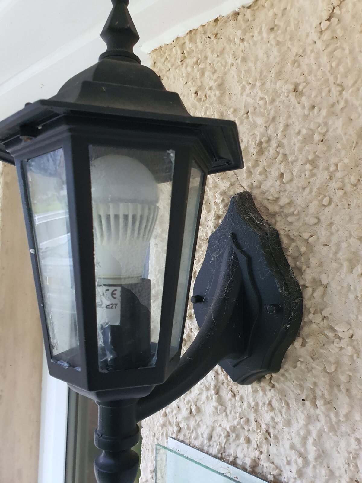

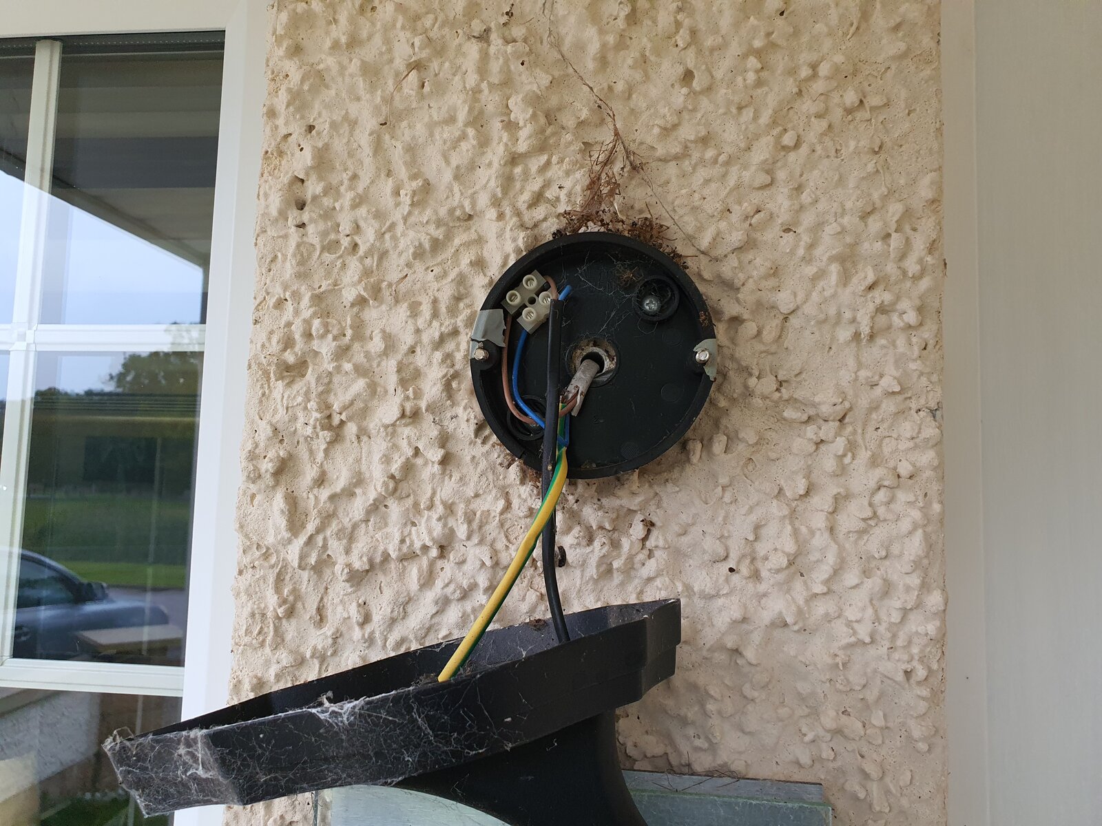

My daughter has asked me to replace this light with a security light with a P.I.R.
My idea was to put a junction box where the fitting is, and put the new light above it.
I'm sure there must a better way, would someone like to tell me it?

Because, I fitted two other lights for her, one on the back and one on the side, and they both came with a cable attached that was sealed into the fitting. My mate told me that they are all like that now.
Also, the cable prodruding from the wall is all that is accessible.

The worst thing that you can do is to install any "Security" light with a "built-in" PIR sensor.
The (relatively "Cheap") PIR sensor usually provided is quite likely to "fail" before the "Lamp" does !
Hence, one should install a (quality) PIR sensor separately from the lamp which it operates.
Most PIR sensors have internal connections which can act as a "Junction Box".
While connecting them together on a Wooden (Stud) wall is usually quite easy, the "trick" is to find how to connect the two together on a Masonry Wall - such as you appear to have,
Good Luck.

Using a separate P.I.R. and light might be the way to go. There is limited space above the hole where the cable comes out and I was trying to make the best use of what is available.
