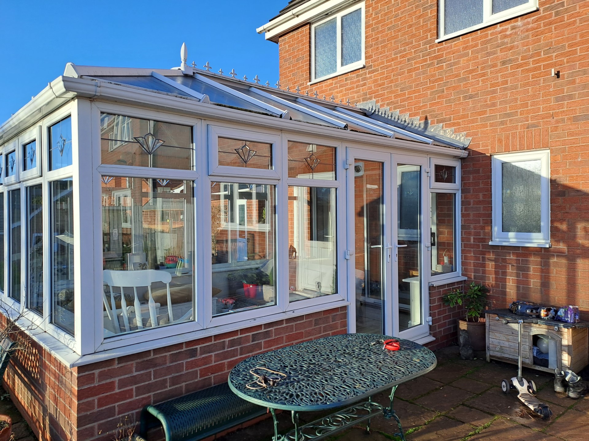

My conservatory is crap... Too big (stupid 45 degree corners for no reason!) and really poor quality.
Currently it's brick up to about 2ft, then double glazing, with a polycarbonate roof.
I'd like to knock it down, move the end wall inwards (I'm planning on digging out for new footings) building one side wall up to full height and going with glazing around the other two sides. I'd then like to put either a proper roof on (ie timber and tile) or a lightweight insulated plastic roof.
The door to the house will remain exterior standard double glazing.
Anyone know if I'm likely to need planning permission for this sort of thing?
I'll add some photos tomorrow so it makes a bit more sense!

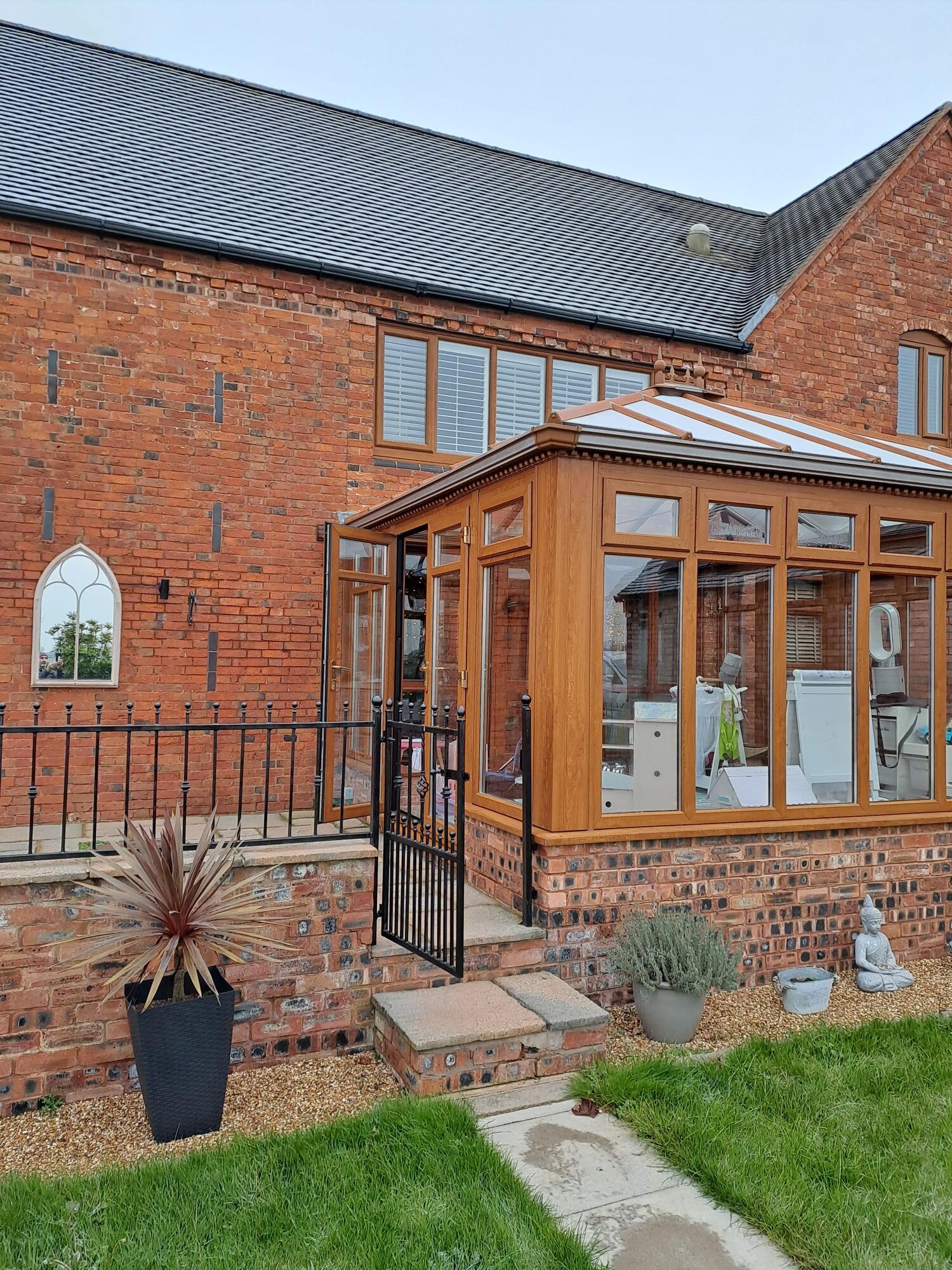

We are currently on our third connie knock-down and re-build, this year. I don't think any of them required P.P. as they all fell within P.D.

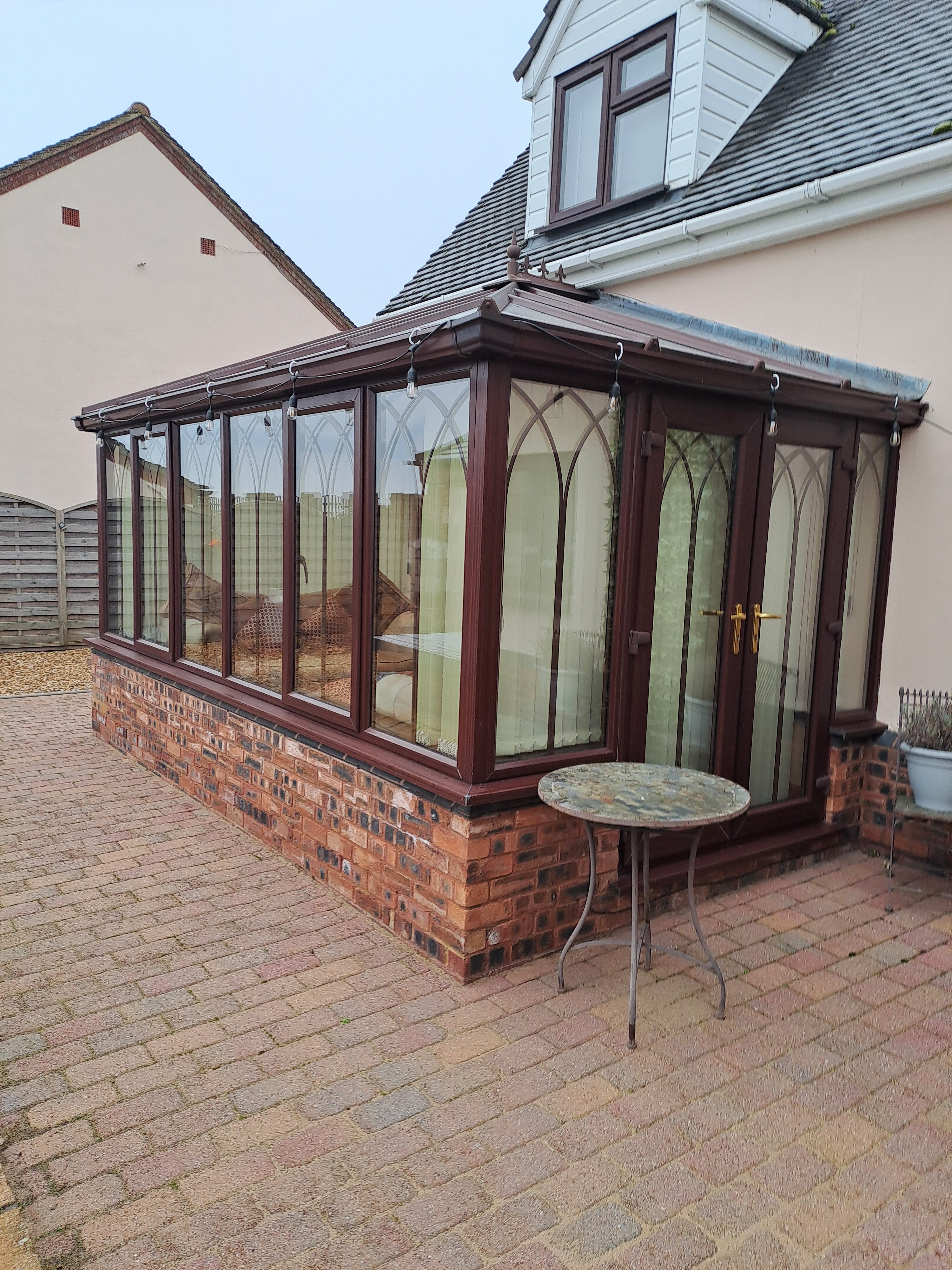

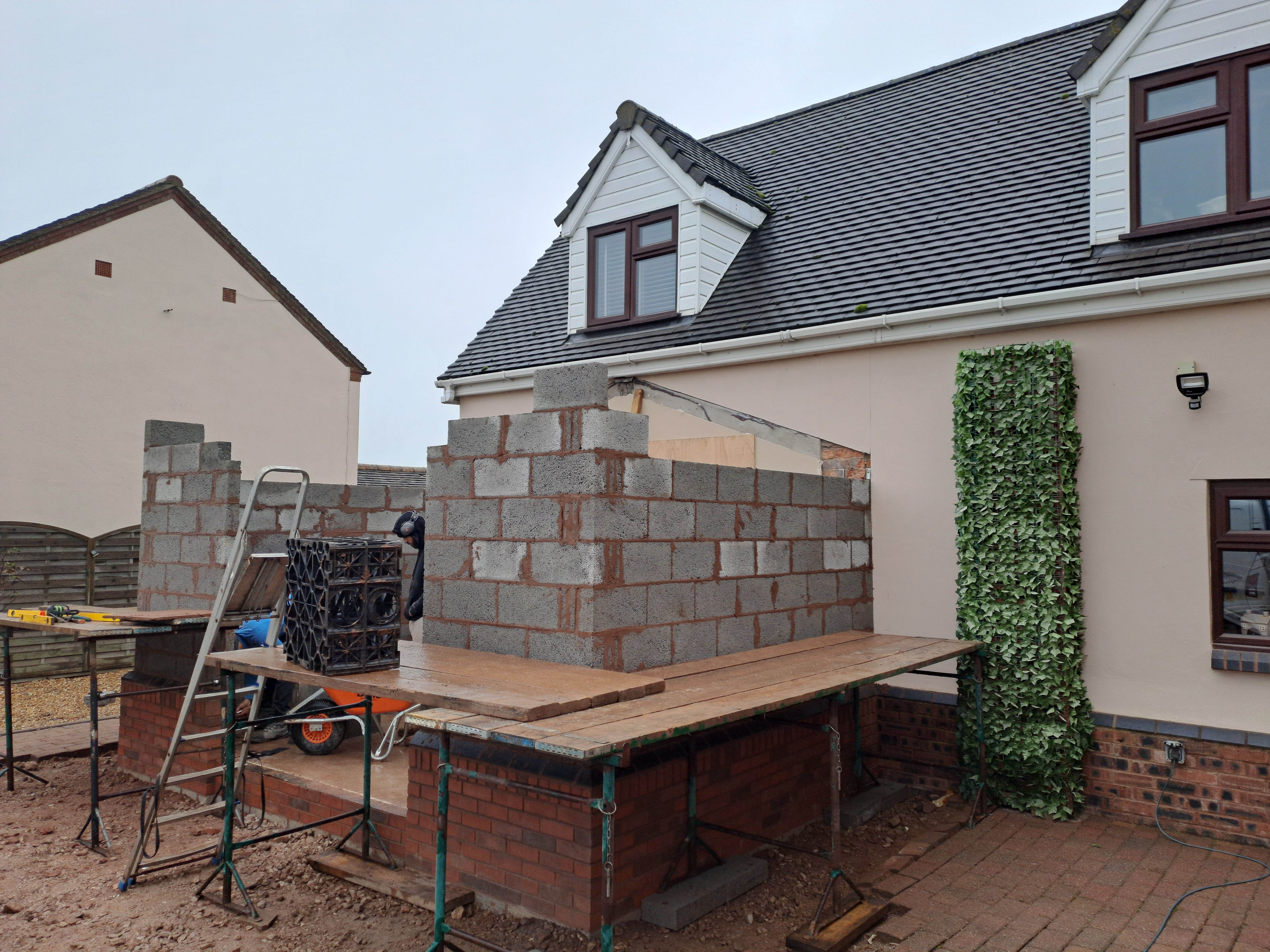

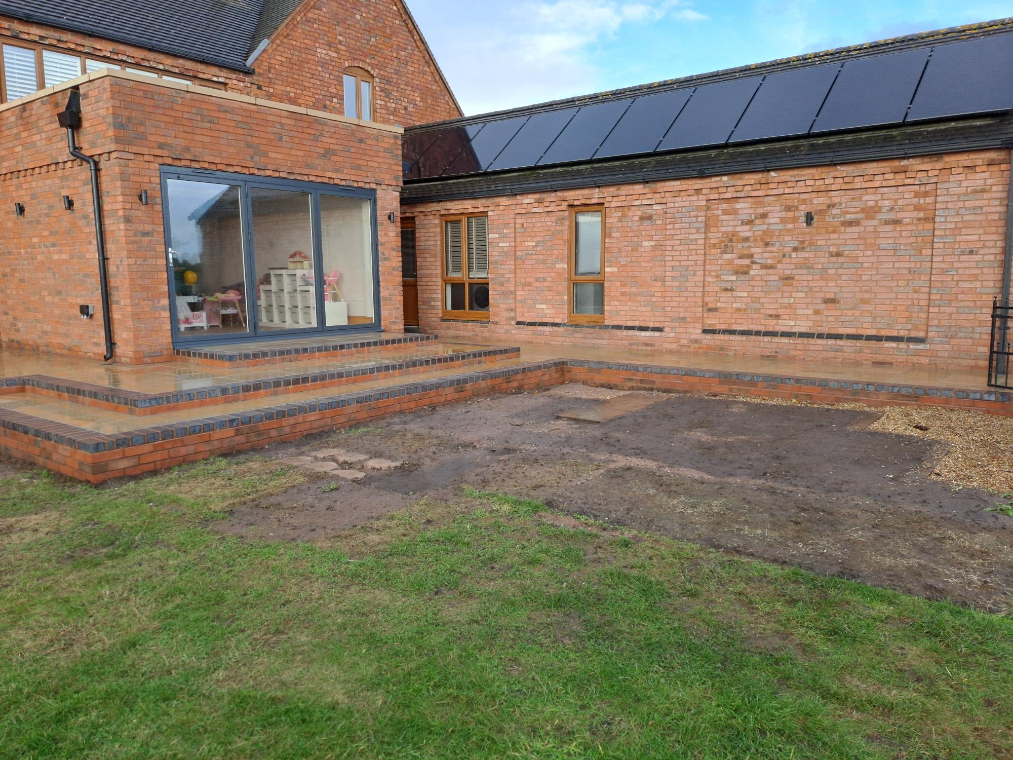

We're in process of replacing a conservatory (which had planning permission) with a proper extension, and our application for prior consent was knocked back as it touched a piece of the house which had been also been extended. Some 50% rule, quite surprised us really as we were not extending the footprint and we had planning permission for what we'd got.
Wasn't a problem getting full PP, but you do have to stop yourself thinking planning make it up as they go along.
