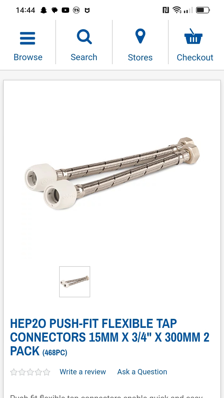

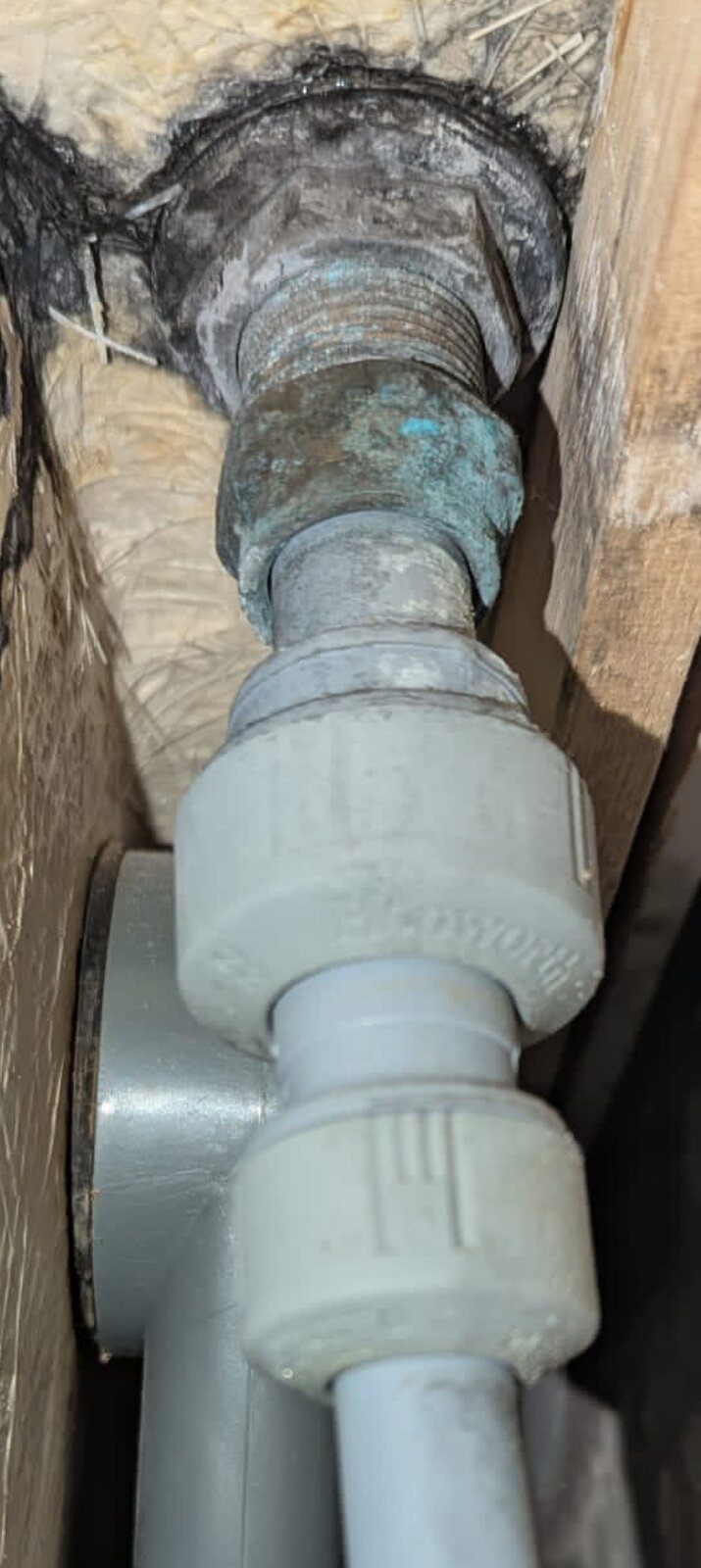

I have some bath taps to swap with some old hep2o tap connectors on am I best of putting new connections on when I swap the taps?
Nothing wrong with re-using them but as suggested, fit a new fibre washers/seal if re-using and make sure you remove all the old washer/seal first.
