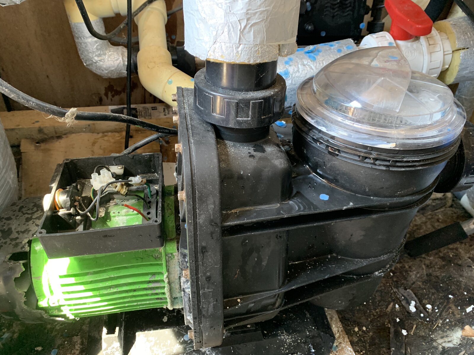

I need to replace the capacitor, but I have no idea about the diagram to plug the wires.
Could someone give some advice?
cheers

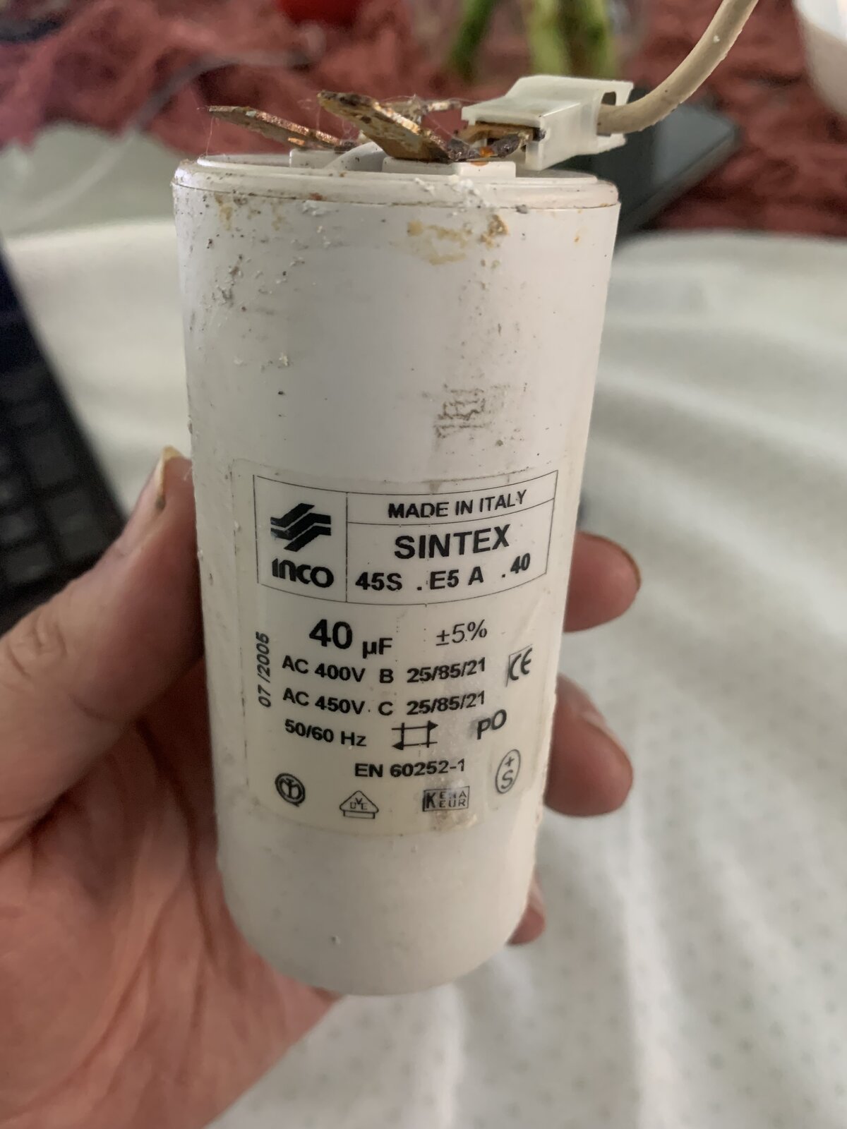

This is the replacment Capacitor (40uF at 450V).
https://cpc.farnell.com/europart/11-ca-40/capacitor-40uf-40mfd-450vac-uni/dp/WG22215
There are 2 pairs of 2 spade terminals (ie only two actual connections).
In this case Polarity is not an issue, so doe snot matter to which side the connection is made (as long oas they are on opposite sides of the capacitor).
So push wires/connectors back on to new one in same manner as they were taken off.

Hi, thank you for your help. Just bought the capacitor on the website provided.

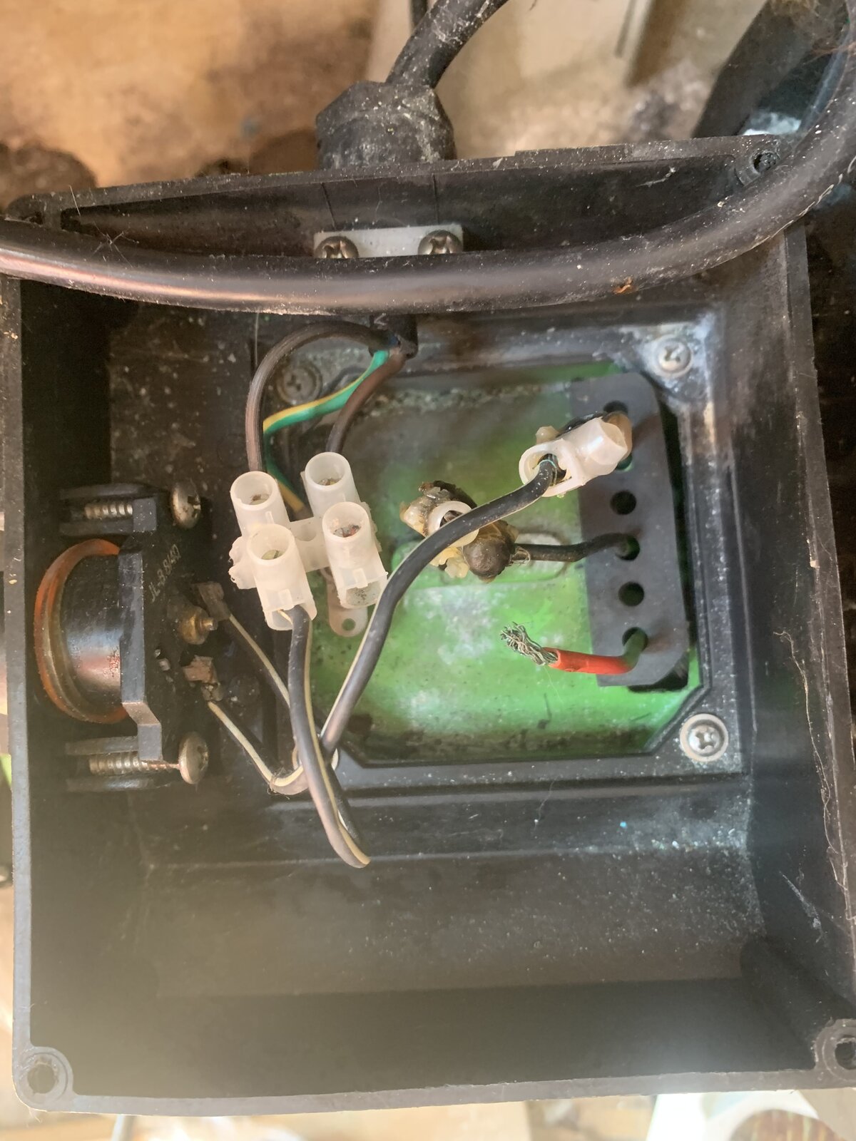

my problem is I’m an idiot, I’ve removed the capacitor from the pump and forgot to record the wire positions.
There are 2 wires from the power, and 3 wires from the motor

So FYI as there are three wires going to the motor it looks like you might have a "3 phase motor running on one phase power".
If this is the case lots of Circuit diagrams here:
https://www.google.com/search?q=3+phase+motor+on+one+phase
https://www.electricneutron.com/electric-motor/use-three-phase-motor-single-phase-power-supply/
The existing 1 wire from the power, going to 1 wires of motor is okay and corerct,
So you have remaining:
1 wire from the power, and 2 wires to the motor to sort out.
And to finish the wiring you have to have:
1 wire from the power, going to one of the two reminaing wires to the motor.
and
the Capaciator is connected between "one of the power wires" and "a motor wire that is not connected to a power wire".
I guess that the Red motor lead goes into the white teminal that does not have a wire going into it.
That then meamns you have both power wires going to the motor.
And no Capciator attached.
Q: What is on the end of the middle black motor wire?
Is that a spade terminal?
Q: What is on the end of the white wire that comes from the spade termnial on you old capacitor?
Is that a bare wire?
If it is a spade terminal on the middle black motor lead I would GUESS that the spade goes to one side of the Capciator.
And I would GUESS that the bare end of the White lead from the capcacitor joins the Red motor lead in the terminal block (and this is why the red lead is now loose).
Of course this is all guess work.
It is NOT a three phase motor. Just because the capacitor says 400v does not mean it is a three phase. 400v is the standard voltage for capacitors and can easily be used on 230v There is no way it would run on a 230 supply if it was a three phase motor without a complicated inverter arrangement.
Is there a wiring diagram inside the lid of the terminal box?
Can post a picture of the complete nameplate details? This may give us more of an insight to what type of motor you have.
Where do the leads coming through the block on the right connect to?
My assumption was from the three wires to the motor, not the 400V cap rating.
That is typical voltage rating of Capacitors for mains 220- 240Vac usage because with pure sinusoidal waveform the voltage that is generally referred to is the220-240V RMS voltage and that is equivalent to 339 V peak, and the Cap has to be rated above this peak.

Ive attached a picture
cheers

Alexandre
To slate my curosity and assist:
- what is on the end of the Black motor wire?
- What is the item on the left (that I saw as being either a switch or a cutout/fuse).
- What is on the end of the white wire that comes from the capacitor?

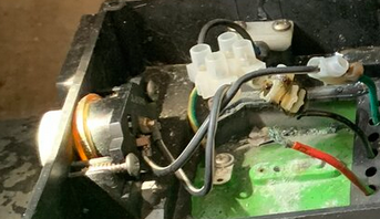

And looking more closely on bigger screen - is that a connector block that has melted?
And has the motors cooling fan enclosure been damaged?
Both might be indictive that it is time to to get a new pump unit.

Also as before - might be better to get a new pump after seeing the state of the terminal and damage to the casing.
Yes, looking at the state of the fan cowl indicates the fan is unable to do it's job.
It also looks as though it is positioned close to an obstruction of some sort, (wall or cladding possibly?), which will not aid it's ventilation capabilities even if it was in good condition.
Getting an electrician to have a look at it may not help unless they had experience of motors and their installation, (a lot of them don't to be honest, it depends on what their field is).
As SFK says, a new pump would be your best solution. If you have a pool company near you they may be able to identify the motor/pump and recommend a suitable replacement unit. If you take a number of photographs from various angles, both long shot and close up, you may not have to remove the pump unit until you get a replacement. Obviously having the unit in front of them is the best option if you are competent at removing it.
