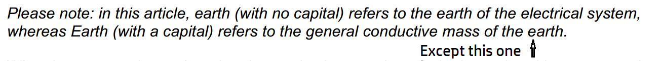

https://electrical.theiet.org/media/1471/swimming-pools-bonding.pdf
The implication is (I am not an electrician so I don't understand it fully) that in some very extreme circumstances bathers could receive an electrical shock, albeit mild. It says that to alleviate this there should be a separate TT circuit feeding the pool only. Is this normal practice, does anyone know? Although it doesn't look like a too onerous job, is it something I should worry about?

Secondly, under normal operating conditions, it is possible, due to small differences in potential between the earth of the electrical system and true Earth, for a small voltage to be present. This is usually due to the voltage drop in the PEN conductor creating the difference in potential. This difference is detectable, for instance, by a wet person touching a handrail and coming into contact with true Earth. This perceived electric shock is minimised by installing the additional earth mat or earth electrodes as recommended by BS 7671, however, the most effective method of removing this risk is to provide a TT earthing arrangement and completely isolate the pool’s metalwork and any pipework from the PME supply
Yes, that's the part that concerns me. I'm not sure though what circumstances would cause a person to be shocked. Would they have to be touching a metal part of the system, which is only the pump? How can someone receive a shock by touching a handrail as in the example above? The handrail is fixed to the ground and goes into the water - neither of which has any connection to the electrical supply. Wouldn't they have to be touching the electrical system earth and the real Earth underfoot?
