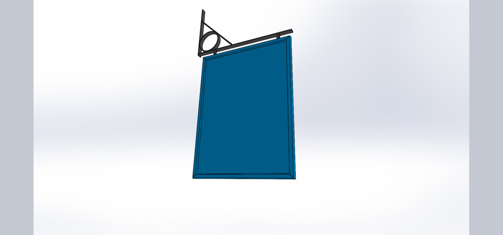

Hello all,
Im making a shop sign for the front of a small high street shop. Proposed design attached to this thread.
What do you all think to the sign being hung from the black wall bracket and being able to actually swing? Is that safe? Will it break apart over time? The center panel is going to be 18mm ply and solid wood outer frame with any fixings going through both the frame and center panel. I could quite easily add another smaller bracket below to fix it at the bottom.
If it was fixed does anyone have any reccommended fixings for the bracket to the sign?

Wouldn't last 2 mins and would be potentially dangerous, the torsional forces on the bracket would be unsustainable.
Suggest you have a look @ "Gallows Brackets"?
There are a load of metal designs out there, one of these metal brackets will possible be a lot more stable?
As for the hangers, suggest you have a look at fitting eye bolts to the bracket with chains down to metal clips on the sign?
Ken.
I have an ironmonger making the bracket and is beefing it up to be suitable so no issue there. I think I will make it swinging on eye bolts as suggested. Thanks guys.
