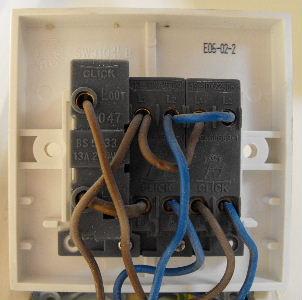

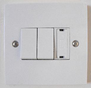

I am having problems trying to locate a replacement switch for our bathroom. The switch pictured does not switch for want for a better description so am trying to find a replacement. Not being an electrical person, I do not know what the type of switch it is.
The description on the inside is Scolmore SW310 31 32 B. Scolmore I have found on the web as the make but can not locate this type of switch. The fuse that is carried is a 13amp
If anyone can point me in the right direction of finding a replacement or alternative, I would be most apreciative.

I have never seen one like that (I am not saying they don't exist) but you can make up a switch plate to look like that using grid switches. If you do a search for grid switches, you will get an idea. MK and a few other companies make them.

On the brown connectors within the unit there are the words 'click' so I guess we may be getting there!!

Where abouts in the bathroom is this switch?
we're going to need a better description than "does not switch"..
how so.. the switch itself is not physically moving?
it's moving but nothing is clicking?
it's moving and clicking, but the thing it controls is not working?
and stupid question, have you changed the fuse?
why a 13A?.. what is feeding this?.. what's it switching?
That switches are from the "click mini grid" range manufactured by "scolmore"
It is a type of grid switch, although it does not utilise the traditional yoke method.
The modules are screwed directly to the faceplate with one screw at the bottom right of the module, as can just about be seen in the picture above.
They should be available from most electrical wholesalers, although, it seems they are only available rated to a maximum of 10AX or 13AX, which is a bit poo.

I'm pretty sure Scolmore do 20A double pole switches for the mini grid range. It looks like that's what is there. The middle one supplying the fuse unit is the double pole one by the looks of it. Good stuff the Click range and carries a 20 year guarantee so would be surprised it's failed. Essentially that is a bespoke item so you'll need to but the modules separately and fit them to the plate yourself.
