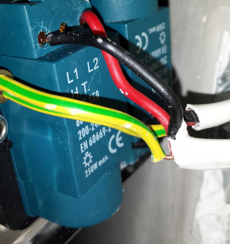

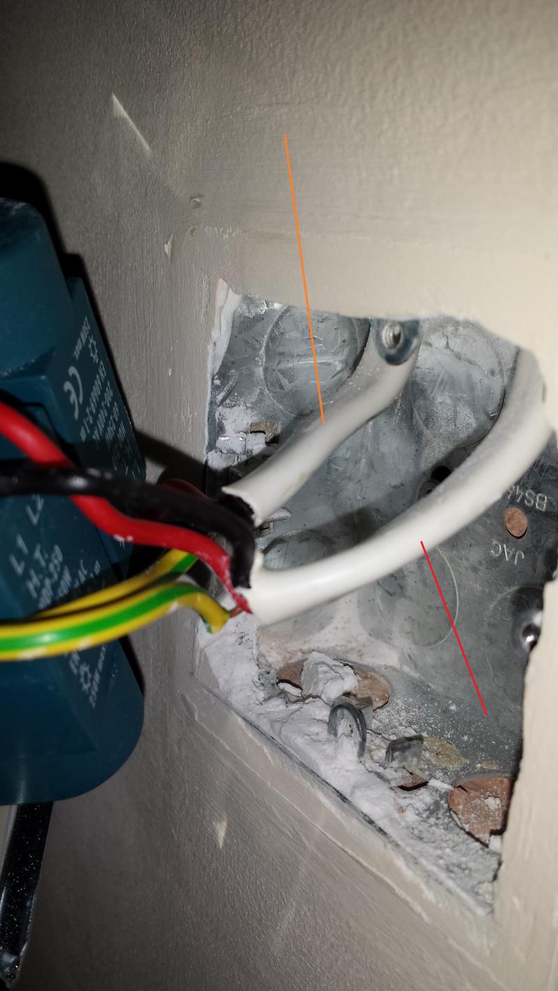

Ok. In the first photo the red arrow shows the cable from the ceiling rose and the orange arrow points to the cable that comes from both wall lights. As you can see, the wall lights are connected via the one cable.
The second photo shows how the cables are terminated at the switch. Both switches are terminated in the same way. There is currently no link wire in at the moment.
When the link wire is connected it is linked from COM (red) from the ceiling rose to COM on the switch that is connected to the wall lights.
I hope you are still with me and that the pictures in some way assist!
I assume you have two cables coming down the wall.
So 2 reds and 2 blacks (and the earths)
Assuming that is the case:
The cable for the ceiling light you have sorted. And you have a link wire from one of them to the wall light switch.
This should go into one wall light terminal on its own.
The second terminal on the wall light switch should have both the red and black in it (to power each wall light)
This worked. The lights now work as they should.
Forgive my stupidity, you told me to do this a few posts back but my silly brain didn't get it!
I appreciate both your help on this matter and for your massive amounts of patience!
