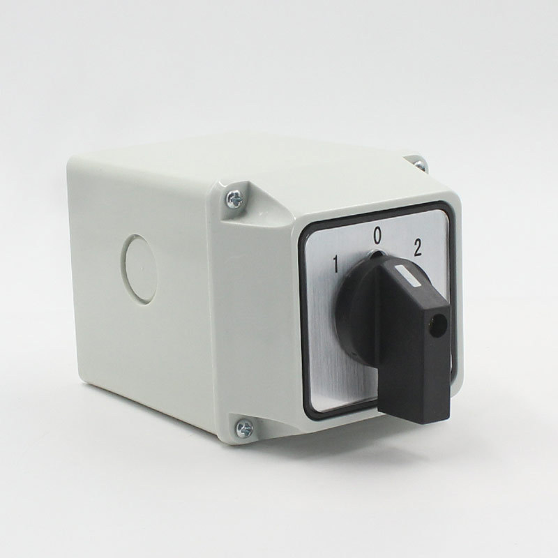

I have two Genny's both 240v, one runs a 63A consumer unit, the other one an 80A consumer unit.
I want to be able to run one single output 3 core wire, with two separate 3 core wires coming into this one outlet.
I want one single 3 core wire attached to both consumer units, where the MCB's on both consumer units are kill switches for current, if possible.
So, one only at a time RCD/MCB will be switched on manually.
Do i need to install a separate fail-safe for switching power from one consumer unit to the other, or is it safe to simply just use the MCB on/off switch on each consumer box to control which consumer box is pumping out the current to the final wire and appliance at the other end?
Yes you do need a separate change over switch.
Preferably a three position switch where the middle position is OFF where the "final wire" is not connected to either of the consumer units.
Your generators must never be connected at the same time as the grid supply, of course, and you must have a changeover switch that makes it impossible.
Drat, but thanks for this, was trying to give myself less work.
I had a feeling a switch would be needed and basically a must for safety.
The same type of switching done when installing a Genny into a house consumer unit basically.
I am only working with wiring after the consumer units, not before, so not 24mm²+
On this one off, using and splicing into 6mm²
I only need a simple manual switch, nothing high-tech or digital, and have this one which i'll use. 80A.jpg
both are nothing to do with grid supply, only for my garages to give me power tools and lights. All seperate from the house and grid. Both power different things, and both are independent for each garage, but i was hoping to have a single feed from both consumer boxes to power one single unit the other end, and as long as both MCB's's on each unit were not on together, it would be safe to do this, without a chnageover switch, but after asking here i realise it is daft and dangerous to do this, so will install the changeover switch. A lot of work for one 6mm² copper wire, unless i can use something smaller to do the same switch over.
