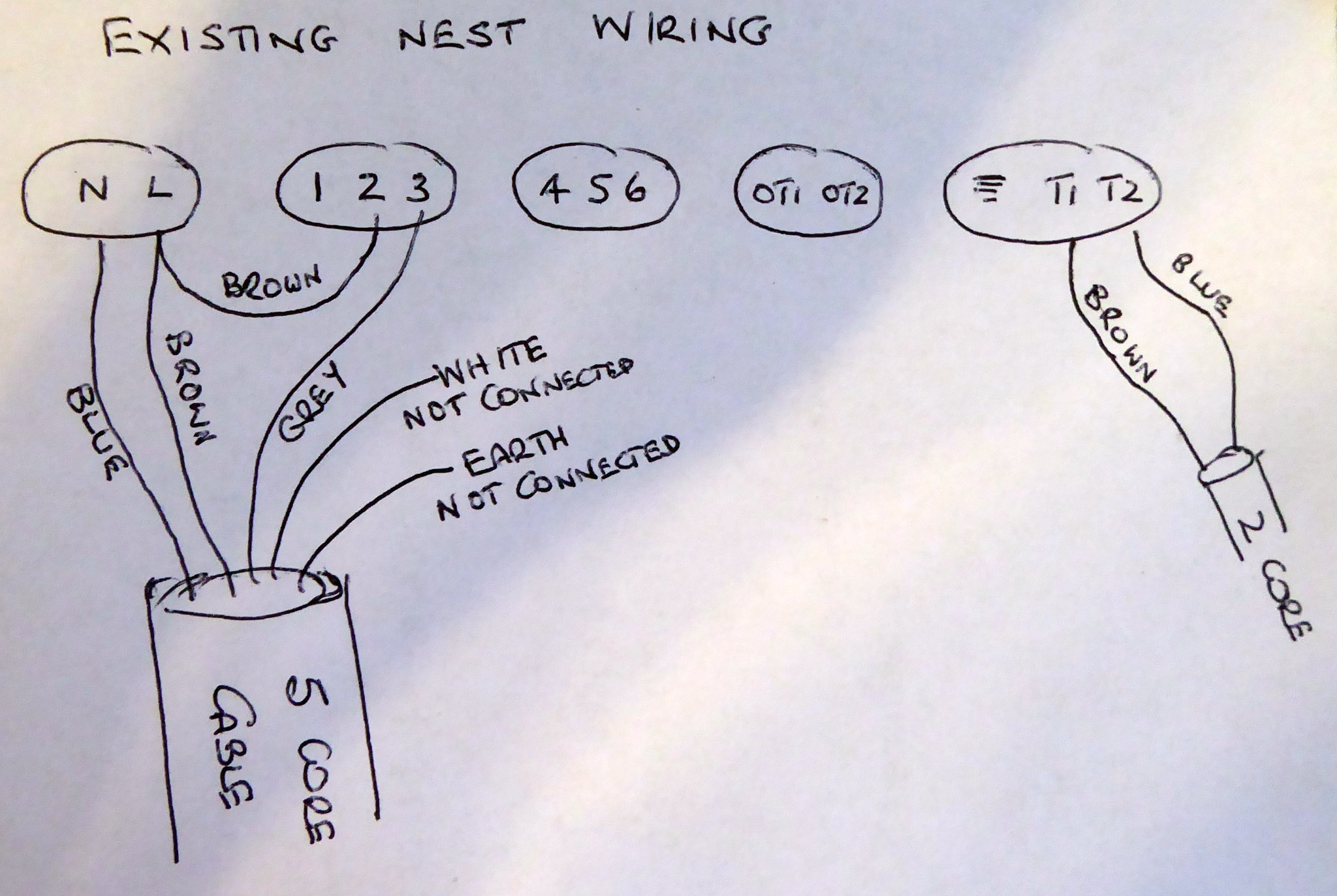

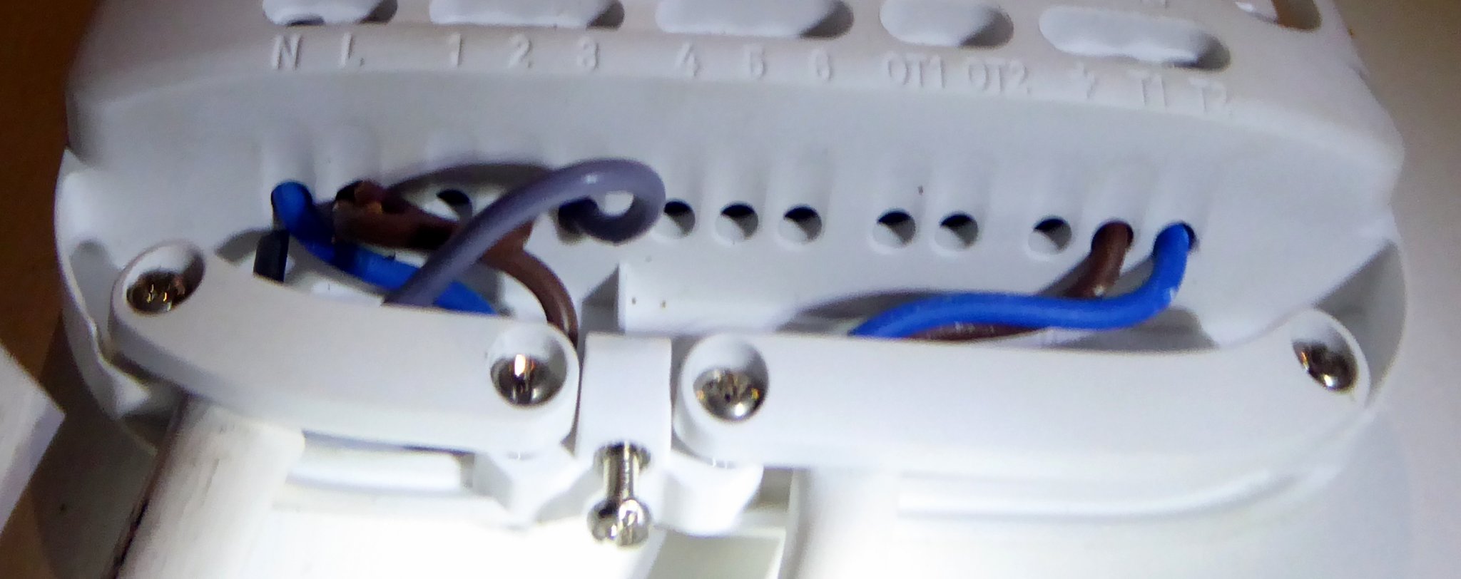

Hi, I am changing from a Nest to Hive Thermostat and would like some advice on the wiring. It is a Valliant combi boiler and I am installing a single channel Hive. I believe I can dispense with the T1 & T2 cable but would like advice on where the 5 core cables connect to on the Hive. (see attached photos)

L and N to L and N, 3 to 3 on the Hive (so all the same). No links required in the Hive.
