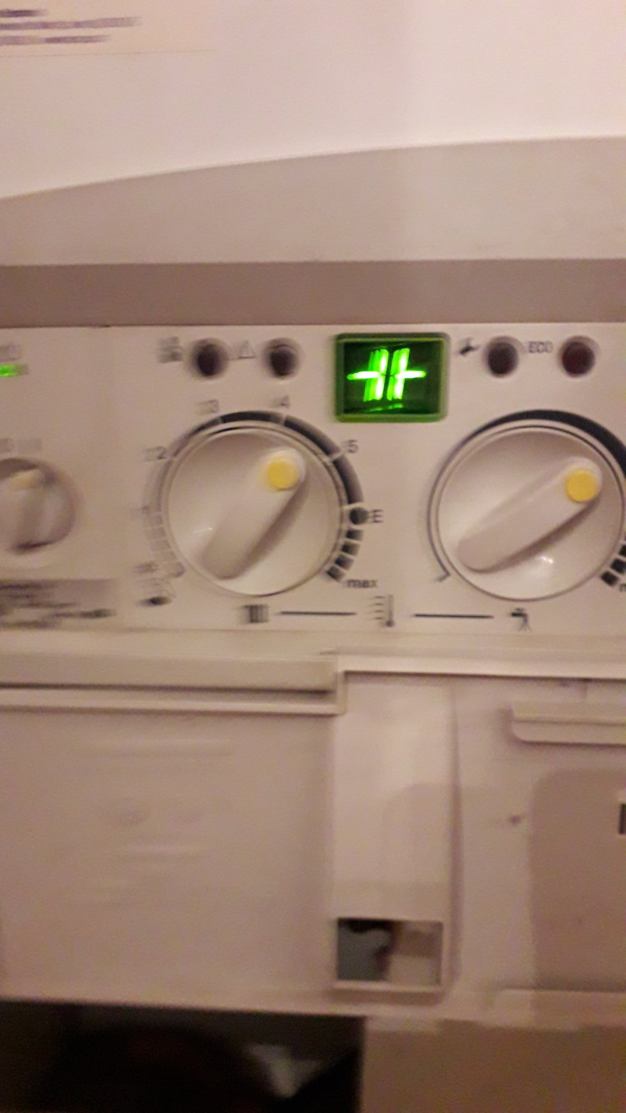

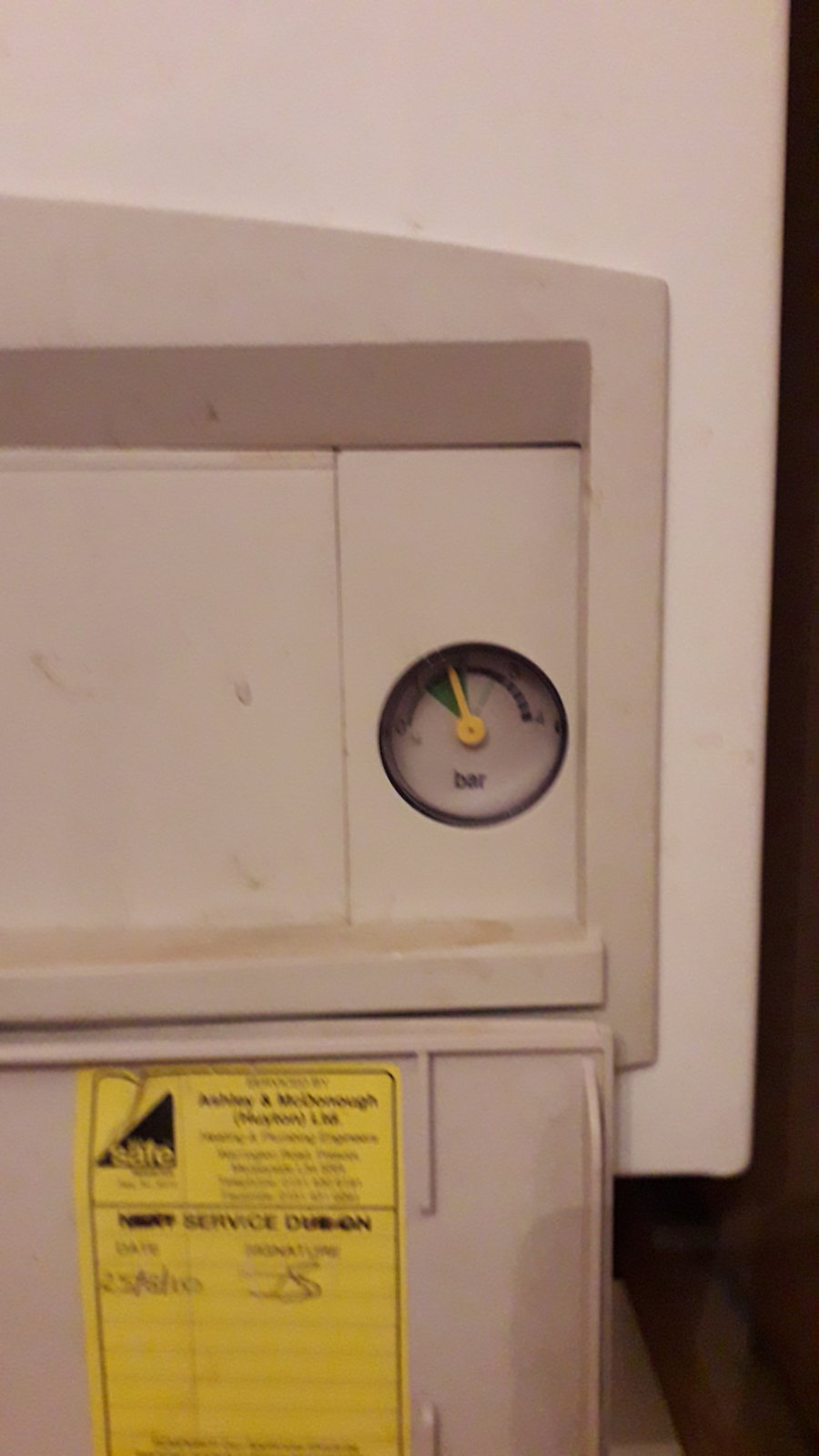

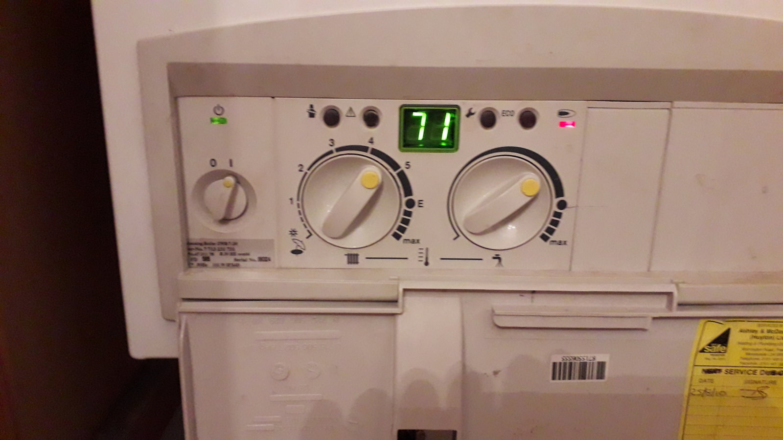

20190120_165813.jpg 20190120_165730.jpg 20190120_165808.jpg 157122[/ATTACH] my boiler just went off so I held the flashing red button down till it came back on and now it is showing a number and then flashing onto a symbol is this normal .. radiator all hot and water ok.
Condensate siphon refilling.
It will disappear after a short time.
Appears to be massively overdue for a service, as the label says 2010.
your boiler will do that for a short time every time the power supply is interrupted
it was serviced on the 3rd of January but I have no idea why it went off...
