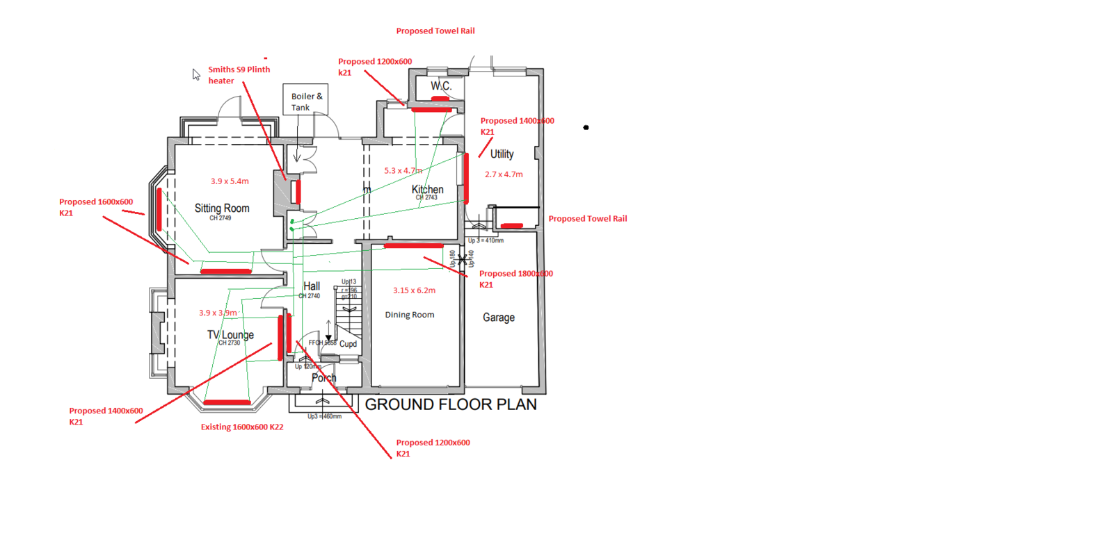

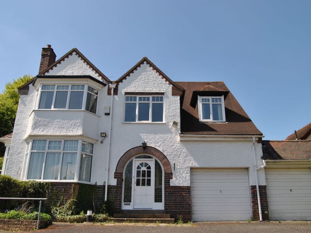

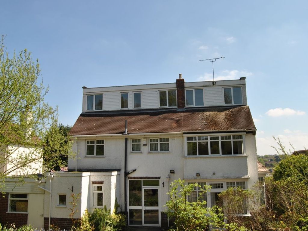

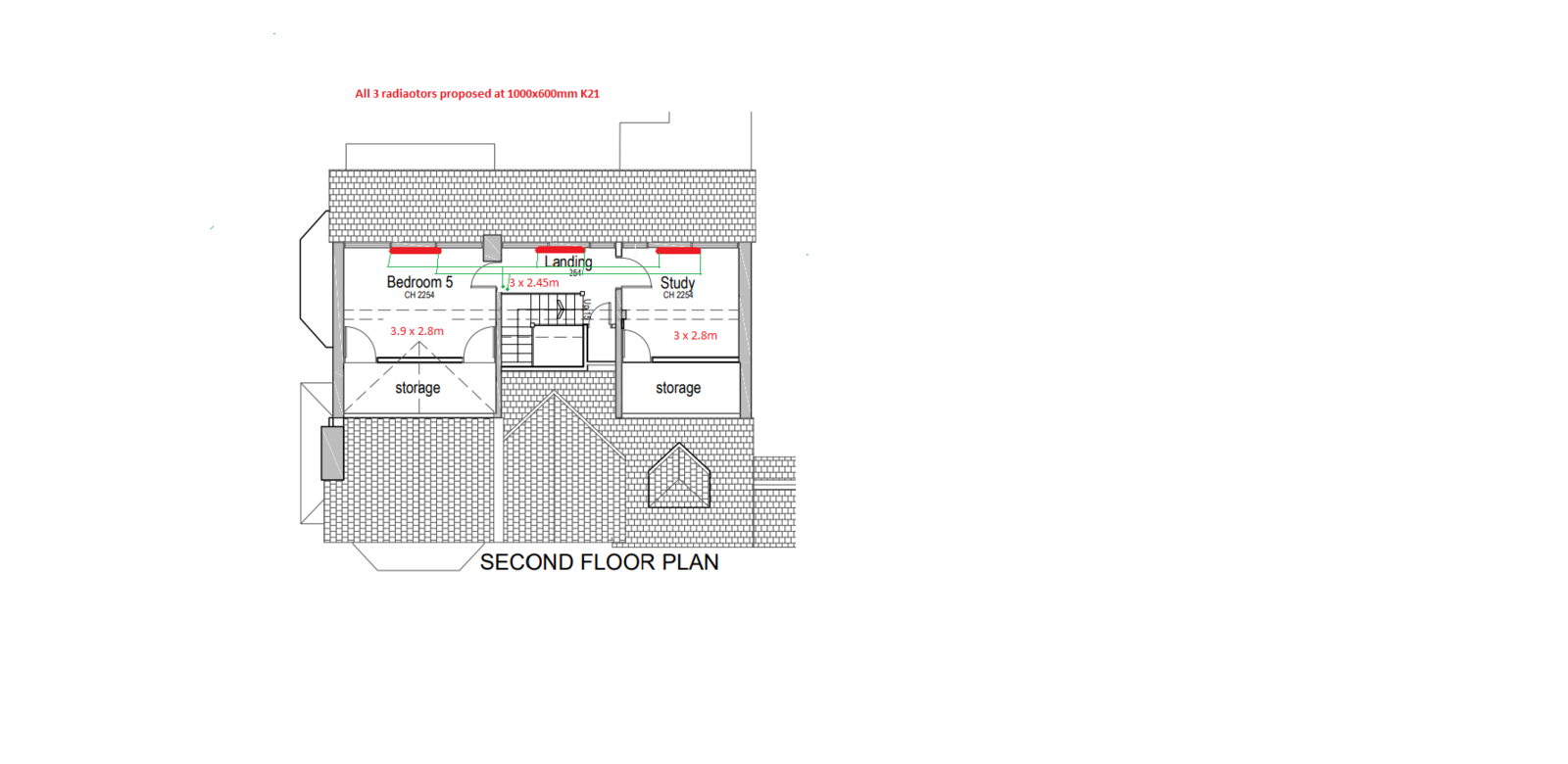

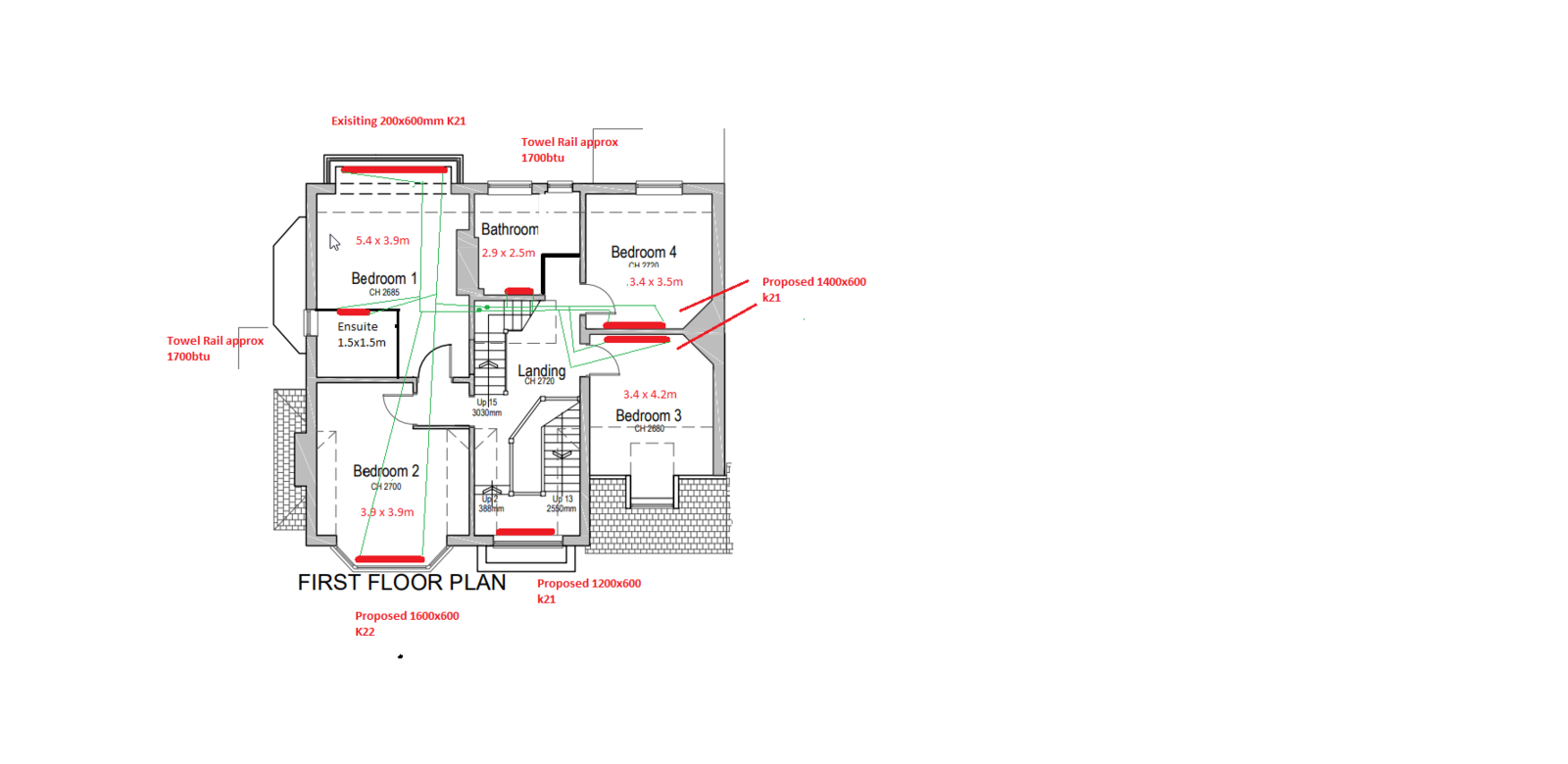

Thanks for taking this on for a bit of fun, it's much appreciated. I've added pictures of front + rear and floor plans of proposed radiator locations, rough new pipe locations and sizes. Currently 22mm comes off zone valve and I'm 99% confident changes to 15mm / 1/2" pipework under the floor. My plan is to run 22mm throughout and reduce to 15mm just before each radiator. It's a S plan+ with zone valve for HW, Heating D/s and heating for 1st & 2nd floor
Its a solid brick house with no cavity and approx 50mm loft insulation (hard to tell as don't have access to loft space). Please excuse the crude drawing, I'm no artist :)

Just looking at it now I'd say as a 5 minute guess, forgetting your written radiator sizes but going on heat loss of 19.5kW and if 22mm and 15mm pipework probably 857l/hr@ΔT 20°C 2m index circuit. Priority domestic hot water.
All a guess as I say, I'll assume more and try to calculate this weekend.
I'm interested to see how close I'll be.
How will you get access to the dining room ?. I cannot see a door or a window in the plan,
Sorry the dining room is currently a garage and part of the plans to convert into a dining room with the door off the hallway.......well spotted ;)

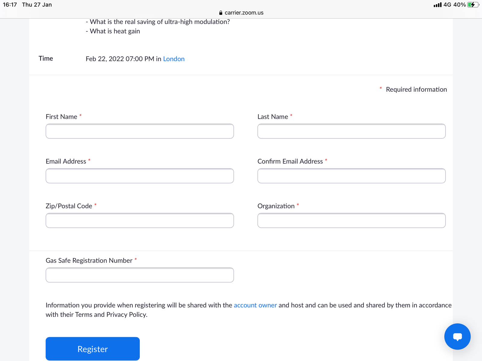

Are you doing another one? The link is asking for gas safe details, with an asterisk denoting mandatory.
The other issue I have is old radiators with old valves which are stuck open so can not balance radiators as a temp measure. All the rads need changing anyway apart from the 2 I’ve already changed
Shame you missed it. That shouldn't have been on there, it's not mandatory. The guy that does it is relatively new and running the whole show for the first time.
