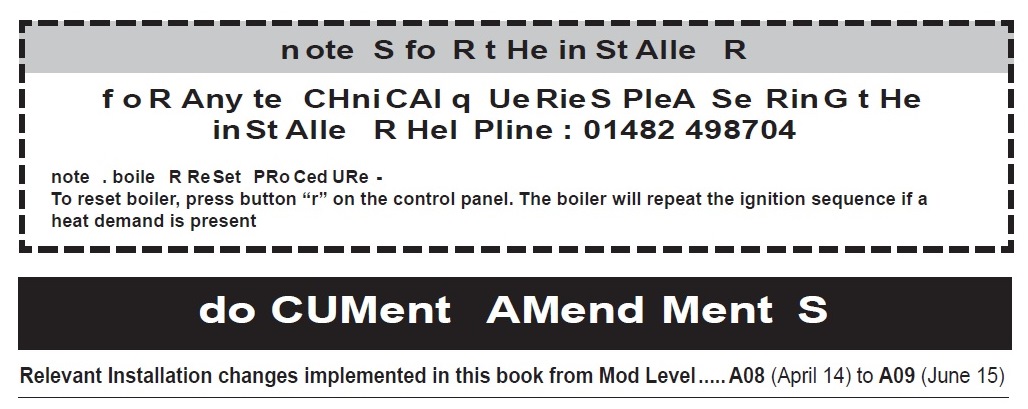

Incidentally, I hope Ideal's quality control of the manufacturing process is better than of the publishing process. This is just one appalling example from the Vogue System Boiler Installation Manual. The book is full of similar mistakes.
DH, if you are an installer, I suggest you fit a logic or a vogue. Cracking boiler operation, features and thought that has gone into it. What if there are a few errors in the MIs, does that mean the appliance is not worth consideration?
But it's not just a few errors; there are hundreds of them. Almost every page has one or more similar errors. What is worse, similar errors occur in other Ideal manuals. If Ideal care so little about the quality of their documentation that they, apparently, leave it to a illiterate school leaver to typeset, what will a customer (who will see the manual as it is left with him) think about the quality of the product?
