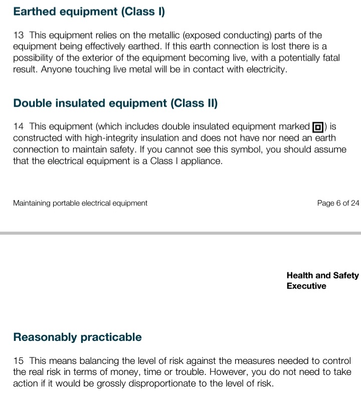

...and I'm afraid I would disagree! ;)

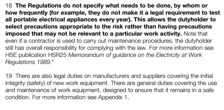

Again (disregarding any other 'standards'), PAT law only requires:
And the 'Guidance', states 'if you can not see the symbol, you should 'assume' that....is a class 1 appliance'.
But, as the tests performed and frequencies are completely up to the tester, based on the RA, we can still test and pass an appliance, if it is safe! :)
Why are you disagreeing with me, given that you go on to write ...
.... And the 'Guidance', states 'if you can not see the symbol, you should 'assume' that....is a class 1 appliance'.
... which seems to be identical to what I wrote, and the point I was making.
Are you perhaps merely quibbling about the fact that the 'Guidance' is not law (in the same way that BS7671 isn't)?
Kind Regards, John

I'm sorry, may be my misinterpretation! ;)
I read it as it is 'only' the marking that matters.
My point is, that given the freedom we have to make our own judgements (under the HSE guidance), we can still legitimately pass a class 2 item that has lost its label.

I'm sorry, may be my misinterpretation! ;) .... I read it as it is 'only' the marking that matters.
Well, up to a point, that is what I was saying - given that, as we have both said, the absence of a Class II marking means that the item must be consider (and inspected/tested) as Class I.
... My point is, that given the freedom we have to make our own judgements (under the HSE guidance), we can still legitimately pass a class 2 item that has lost its label.
That's really a pretty 'special case'. If one truly believes (and has good reason to believe) that a Class II item has 'lost it's label', then it would seem perfectly reasonable to use discretion to accept that it was a Class II item, and inspect/test it accordingly. However, if one has no particular reason to believe that it ever did have a Class II marking, then I would question whether it would be appropriate for a PA tester (or anyone else) to decide (by personal judgement) that it could be considered (and inspected/tested) as a Class II item.
