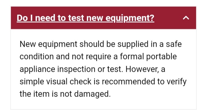

The keyword there RG, is "should"....and as no one has mentioned it so far:

I think part of the issue, is there is no suggestion that the OP's appliance has been provided in an unsafe condition;The keyword there RG, is "should".

@RandomGrinch point about testing new equipment we found a problem as if we found there was a fault a year latter, then it was too late to return under guarantee.
