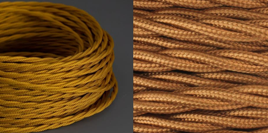

I do see the point, we have cable designed to look good, be it gold outer, clear outer or other it is designed so cable looks good, and common for the markings if any to be few, internet hunt and two came up
where clearly no marking, the one on right said only Cable Diameter: 7.3mm Cable Spec: 3×0.75mm but one on left said EN 50525 - 2 - 31 plus more details, but it is clearly OK to use the cable for a standard lamp.
From what you say seems yours is like this
the advert says "All are 3 amp, 300 volts rated and made in the UK to British Standards BS7655 and BS6500."
So can't see how one can fail an item simply because it has that cable, however it is hard to show the cable does comply without the manufacturers declaration, so we have to use our judgement. Does it look tough enough for the job.
