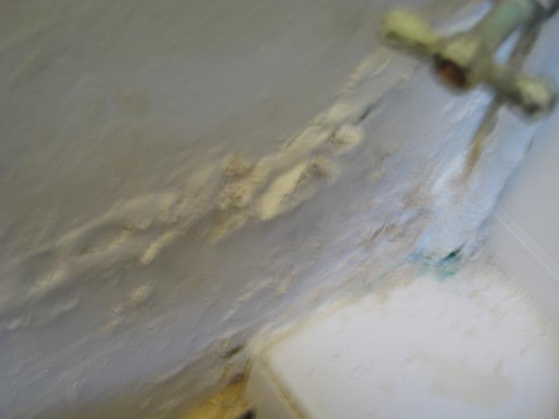

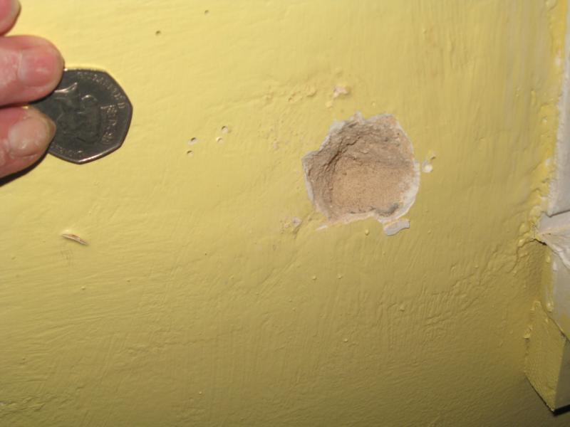

Which is best. I have had a builder in and he said tanking would be fine. As stated in the other post my neighbour will not respond to a party wall notice so I cannot use a DPC on that wall so I thought I would have it replaster with Sika!
I am uploading photographs from the other thread which has been locked so I cannot upload them on/in to that thread!

It doesn't look locked to me. If it is, click on "Alert Moderators" and ask for it to be released.

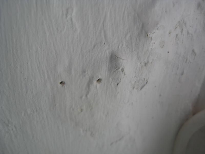

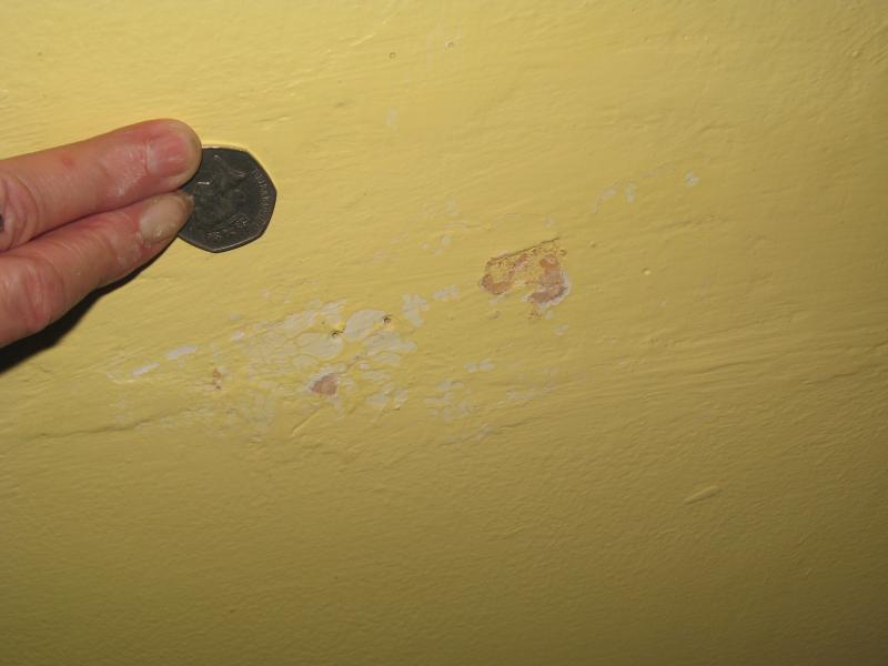

The pics are all a bit close, can you stand back a bit for a wider view, and put something in the pic like a hand or a cat or a 50p piece to show the scale?

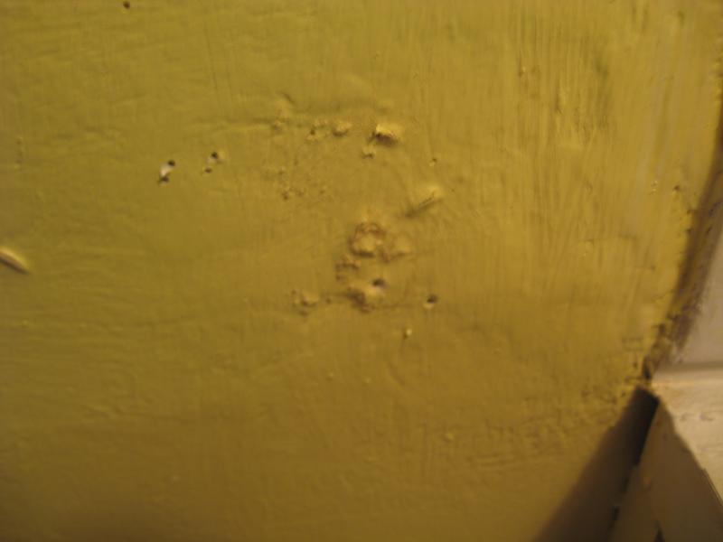

Where the wall is very lumpy it puts me in mind of a Victorian house with lime plaster that has been whitewashed or distempered and then painted over the top. Do the blisters pick off easily?

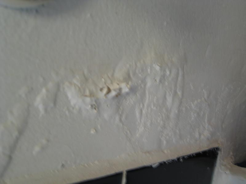

In one of your pics I see a brass stop-cock. Wet walls next to pipes and taps are very often due to leaks.
OK I will do that John. Yes the loo has been leaking and also there was condensation from the shower.
The areas are small however the bubbling up is all over that one internal wall. It was all replastered in 1989 when I had the first damp proof course put in so it is not lime although I know what you mean!
Apart from that the areas affected are small but lots of them. But in the bathroom and kitchen the tanking seems fine.

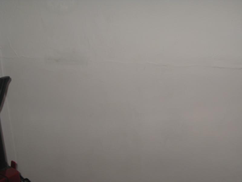

I have managed to take some more photo's and will now see if I can upload them :p
Thank's so much for your help John I honestly dont know whether I am coming or going with all this damp proofing, membrane or tank situation :rolleyes:

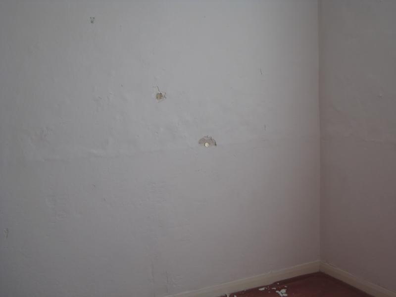

The one on the end is another internal wall. That is the handle of the hoover to give some idea. Just appears that damp is coming over the top of the damp proofing that I had done 20 years ago!

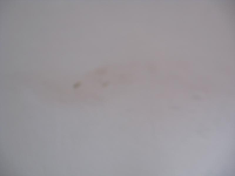

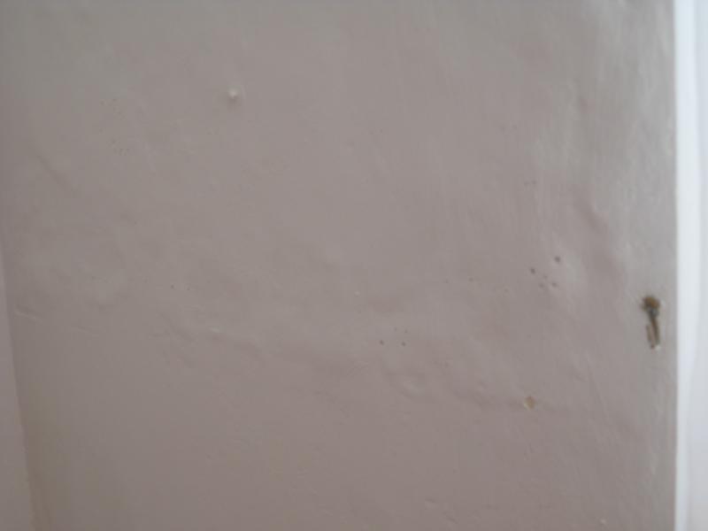

I was particularly interested in picture 3.
The plaster looks OK until a few inches above the windowsill.
Has that section been replastered or tanked? What is on the otherr side of that wall (is there a source of damp such as wet earth, leaking gutter?)

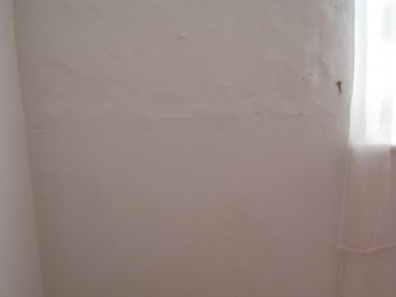

picture 4 seems to have a similar line.
Yes I had a damp proof course put in years ago and below that the plaster is fine. What the surveyor said is that the damp has risen above the original damp course!
You can see the window and possibly water has come in through the wooden pane but that doesnt account for the rest of the flat ie the two internal walls. The tanking in the kitchen and bathroom seems to be fine even though the surveyor said it had rising damp too but he put his meter right above the cistern which had been flowing over. I have removed the tiles etc and the bathroom is drying out. The floor was also wet from the drain which gets blocked and brings water back in. I have had that cleared.

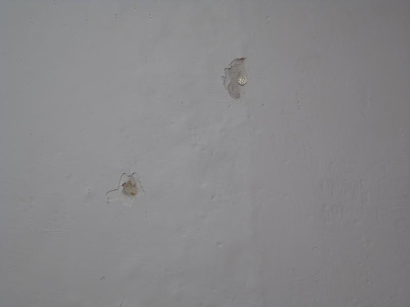

I am still interested in the idea that the new plastering looks OK but the old plaster looks rough and blistered. Does it seem to you that the new is drier than the old? Was it done with a water-repellend sand and cement mix?
We may find a plasterer has something to say.
Hi John It was all plastered at the same time but as you can see from the photo's where there has been a DPC and the room has been tanked up to a hieight of one metre, all that area is OK it is the plaster above the tanking or water proof plaster which is blistering.
It does need to be re-plastered but should I put in a DPC or just tank up to the ceiling!

The walls will have been lime rendered originally, some are left and the brick is just lime washed.
The soil has been removed from all except one side from what I can gather, this will help matters.
If you want this to be dry it needs to be redone in either lime render or board it all out. I would use gypframe if I was to board, adding vents to allow the wall to breath. I suspect the outside walls have been pointed with sand and cement, this should be ground out and repointed in lime.
If you seal the walls like what has been done, you will get problems down the line like what has happened. The walls have been sealed and because the water can't evaporate it's soaked up the wall and since the bottom half is water proof it's broken through further up. It will also be causing the brick to degrade....
