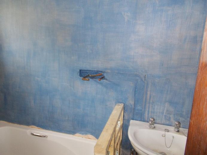

Hi. I wondered if anyone's had this issue with tanking before? After applying a certain tanking kit featured on a youtube ultimate handyman video, I peeled off the masking tape I'd put along the edge of the bath...to find in places the tanking membrane peeled off the wall too (see below).

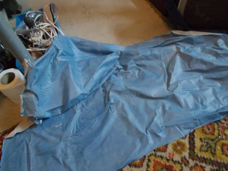

I followed the instructions - two coats of the tanking primer with drying in between, 2 coats of tanking with drying in between. Wall is bare plaster that was wiped down with a damp cloth before I started. I've now ripped the lot off, which was depressingly quick as it came off in large sheets:-
I'm pretty sure tanking should stick to the wall better than this? I think the primer's come away with the tanking, as the suction is back/the wall looks like it hasn't been touched once peeled off.

also tanked recently - on top of newly plastered/SBR'd wall and have found that the tanking membrane is very prone to nicks/holes with the likes of masking tape or the edge of a tile offered up if i'm careless :( never attempted to see if i could peel the whole lot off, perhaps mine would have done that too if i tried :eek: how long had you left the plaster to dry?
i think its just the nature of it - to be flexible enough it means it isn't very tough. never really considered how this would relate to its strength to hang tiles off
I sent a sample to the manufacturer and got this reply:-
'The back of the sample looks very dusty which has obviously affected the adhesion.
This could be for one of 2 reasons:
The primer has been applied to a dusty surface thus preventing it from penetrating the surface, or the wall is so porous that the primer has been sucked straight into the wall leaving a dusty surface preventing the membrane from adhering.
Re priming should remedy the problem, but it may be wise to carry out a water test before applying the membrane to ensure the wall is sufficiently primed.'
I don't think it's the former as I wiped down the wall with a damp cloth before priming...I could believe the suction thing though. The wall was plastered maybe a couple of years back but I've only now got around to doing the bathroom, so it's had a long time to dry. Manufacture dates are only a couple of months ago so fine there, followed instructions as far as I know. I've sent them another e-mail to check what they mean by the water test, and I'll try repriming and testing a small area with several coats and then tanking it to check I can get it to stick properly before I do the whole wall...fingers crossed!
