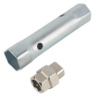

Hello all, just bought new basin and bath taps.
The basin is easy access but the bath is going to be a swine!.
I orignally fitted the taps to the bath before fitting the bath in due to how tight it is.
So I need a decent spanner for removing the flexible tap pipe connector (1/2 inch?) plus the tap base nut.
Any recomendations?, needs to be quite long by the look if it.
Taking bath out is not an option!.
https://www.toolstation.com/monumen...MIorqv0rGf4QIVmpntCh0_zgfaEAQYASABEgIWWfD_BwE
I much prefer box spanners to basin wrenches where isolation isn't an issue.
£10, Screwfix.
Found a set of Jaw Droppers for £45 (used once), they're on their way.
Look like a worth while investment!.

Jaw droppers worked a treat, don't think I would have managed to do the bath taps in situ without them so money well spent!.

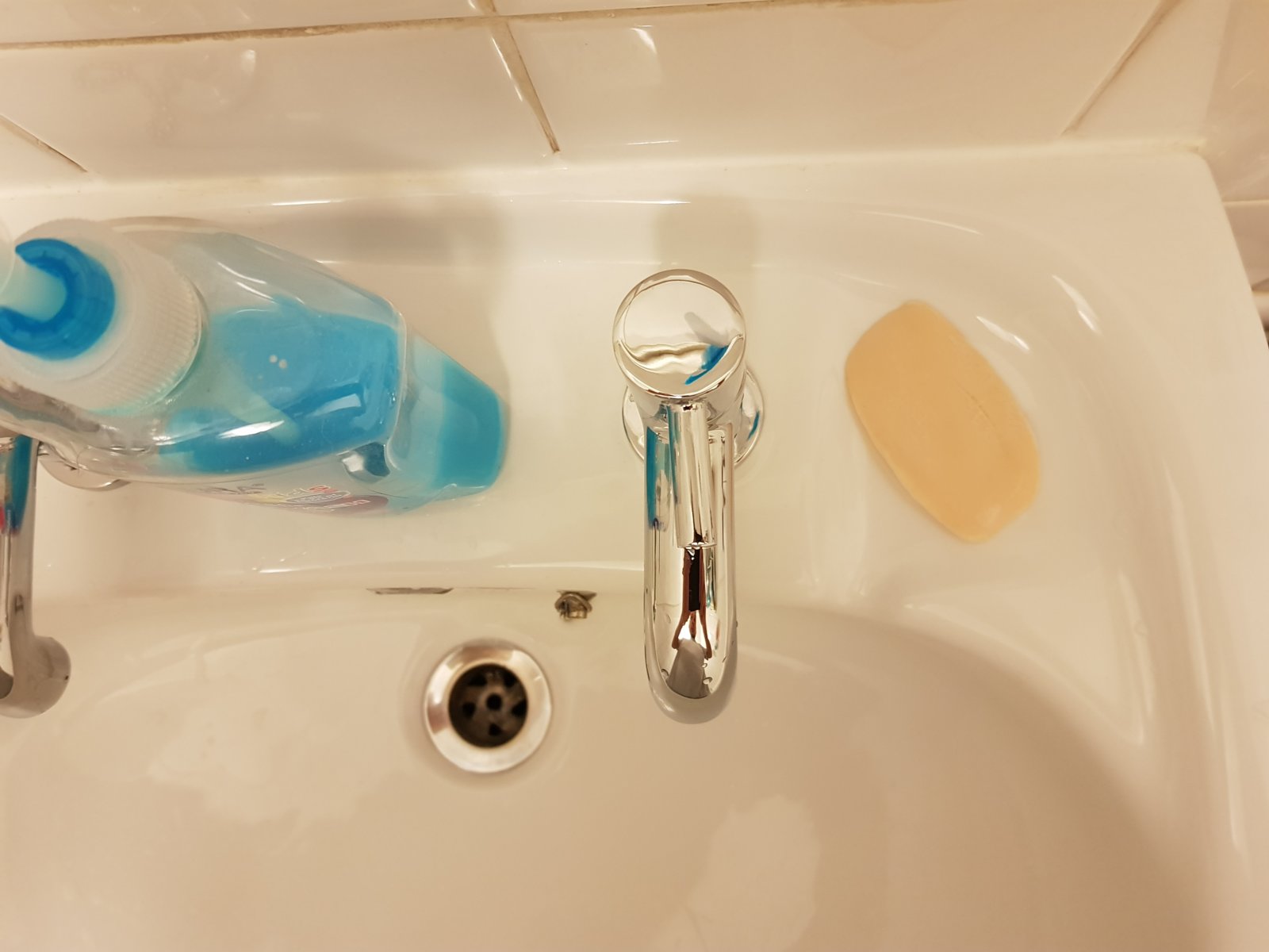

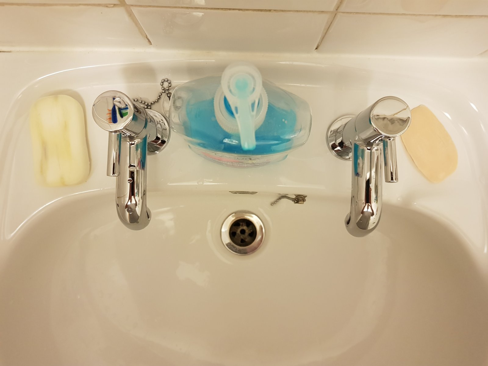

Put it all back together and did the sink taps. Checked for leaks and then noticed the cold tap handle isn't square!.
Probably take it back on Sunday for a replacement, don't fancy taking a brand new tap to bits..
