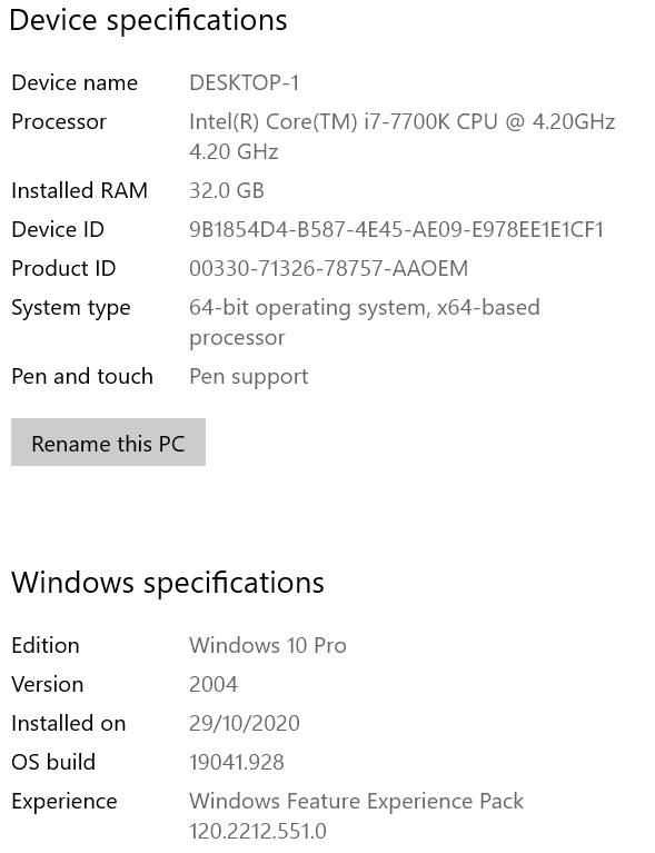

Ac.cording to Program Manager, my PC never uses more than a small amount of its CPU or memory. About 20%, apart from a browser, but the RAM figure for that doesn't make sense to me. 3.7MB isn't 46% of 32GB
But if say I have Youtube playing and I'm doing something in Photoshop, it's noticeably slow in Ps. Same if I have Acrobat pro doing much.
Are there settings to say Use more memory" or "Use more processor"?
Does this tell y'all enough:

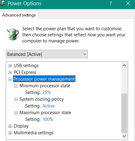

The thing used to have a liquid cooler but it packed up so I can hear the fan increase in speed now, not much makes it speed up.
Checked this:
I know it's over-clockable but I don't have any games so it's not life or death.

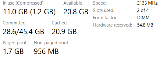

Those processses don't add up to anything like 46% of 32GB ram though - should they?
So the ram may not be set up correctly. Even so, why doesn't it use that ram?
Not surprised the graphics isn't fast - cheap card, as no games, tho I'm not sure what the percentages mean exactly.
The reason it doesnt add up to 46% is that it isn't showing you everything. The windows RAM management system is pretty complex, it is designed to run with insufficient RAM and also to take advantage of excessive RAM.
When it has more than it needs, as you have, then it tries to gather up as much as it can reasonably make use of for caching. That is where your missing RAM has disappeared to.
if you hop over to the Performance>Memory tab you'll probably see roughly 10GB in use as a cache, as well as a few other uses. Now if you started using more RAM then windows will release some of that RAM for other applications, reducing the size of its cache until you hit a point where it'd start using virtual RAM.
Tldr: Nothing seems wrong about your RAM.
