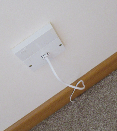

this was where our copper telephone cable entered the house and connected the rest of the wall-sockets throughout the house - the cable coming out of the front went to my router
Just been connected to fibre this morning and have lost all of our telephone outlets, our telephone now has to be plugged into the back of the router!
if I ran a male to male cable from the router to this outlet, would it connect up the rest of the house ?
(we have two telehones and never use both at same time) having a telehone next to the router is no good for us, won't hear it) elderly parent who will only ever use land line

The plug in your picture needs to be into the router dedicated phone socket.
Nothing connected to the BT socket will work now that you have fibre
No.
If that cable plugged into the socket is what connects to the other sockets, then plug that into the router,
If not, then they will be wired to the back of the lower half of that socket. Remove the two screws, pull the lower half away, and there should be wiring connected to that.
That wiring would need to be connected to a cable with a plug on the end, so it can be plugged into the router.

All working
I didn't understand why it wouldn't work, I was thinking of some people power an AC circuit with a genny by plugging the genny in via a 3 pin plug (dangerous but people do this) should be the same with a home telephone system
Anyways, what I found (and I don't get this at all) in the master socket the two wires being used were (1)Green/White and (2)Blue/White, and in the rest of the house all the slave circuits were using (2)Blue White and (5) Blue/Blue ...(in brackets is the terminal number)
So I connected the master socket up so it was the same as all the slave sockets and also disconnected the external feed
Plugged the routers telephone output into the master socket, and hey presto, all the phones on the slave outlets working as normal. It is only logical it would

The external feed might have been shorted (joined) when it was cut and replaced with the fibre.
So when you disconnected it, it removed the issues - perhaps.
