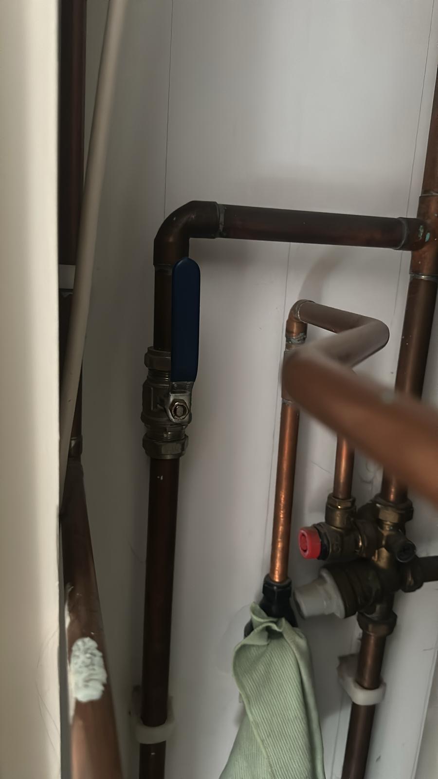

Hello
I have a situation where my fuse box has tripped and drove me to look into why…..
I’ve discovered this drip of water which must be linked to the electric trip
Has anyone experienced this? The boiler has low pressure so that’s been turned off but how do I stop this drip?
I would really appreciate any input - do I turn off water supply to the hot heat pump?
Many thanks

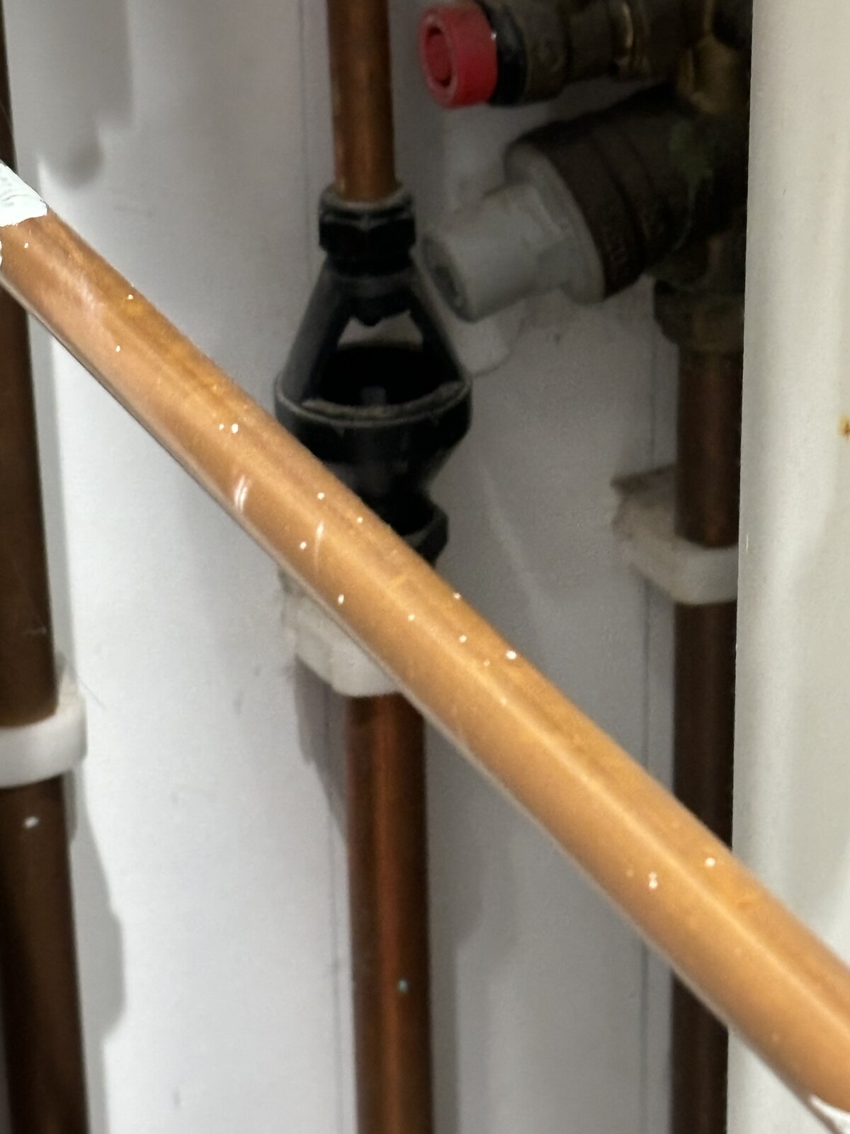

1. No drip is visible in the photograph.
2. If there are drops of water visible in the tun dish (black plastic open sided item in your first picture) then the the hot water cylinder needs servicing. The drip can come from the combination valve (grey cap below red cap in picture 1) or from the Temperature and Pressure Relief Valve (TPRV, not visible). If drip cold, likely to be combination valve, if hot / warm, likely to be TPRV.
3. Those cylinders are meant to be serviced annually to check that all safety devices are operating correctly. They can be dangerous if faulty.
4. Servicing may only be carried out by someone with a current "G3" accreditation. This is not the same as a Gas Safe accreditation, although Gas Safe, along with a few other organisations, can accredit people.
5. May or may not be anything to do with the circuit breaker actuating in the consumer unit.

Can I stop the drip? (By turning off the attached blue taps to the pipe work?)
I’m concerned the drip will cause an overflow

Yes blue will shut off cold feed to HW cylinder and the drip into the black tundish will, eventually, stop. (Release pressure by opening a hot tap and it'll stop quicker.)
You should remove that rag... and allow the drips to fall down that pipe.
The pipe should likely go straight outside the house where you may see the end dripping, or into a drain.
Under some fault conditions that pipe may carry a good fast stream of (very hot) water.

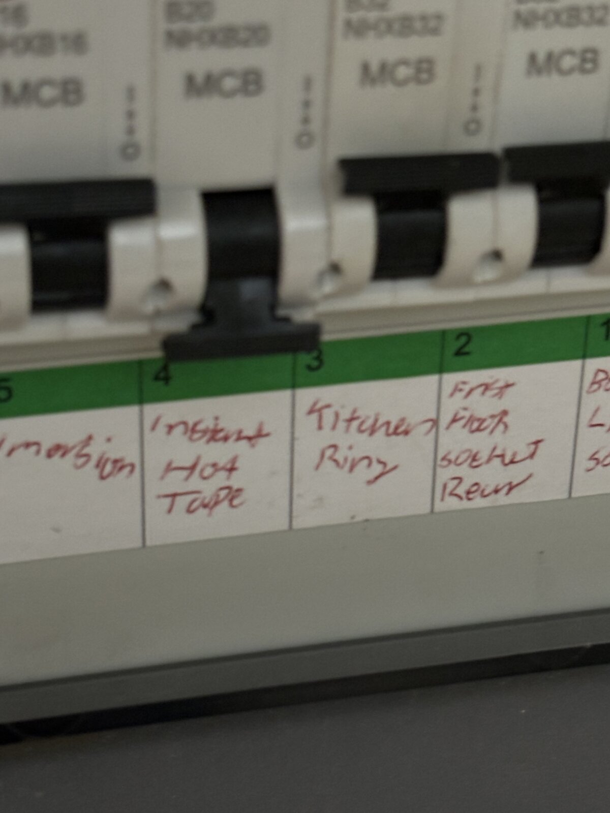

NB That MCB trip is labelled "instant hot tap" and will be feeding a Quooker or similar instant hot water heating device. It's 20A which is almost 5kW capable.
It will have tripped because of a fault with that device, most likely, whatever it is.
The MCB to its left is labelled "Immersion" which will power the HW cylinder immersion via another switch near to the cylinder and is 16A, the usual rating for a 3kW immersion heater supply.
The drip in the tundish is unrelated to the MCB trip.
