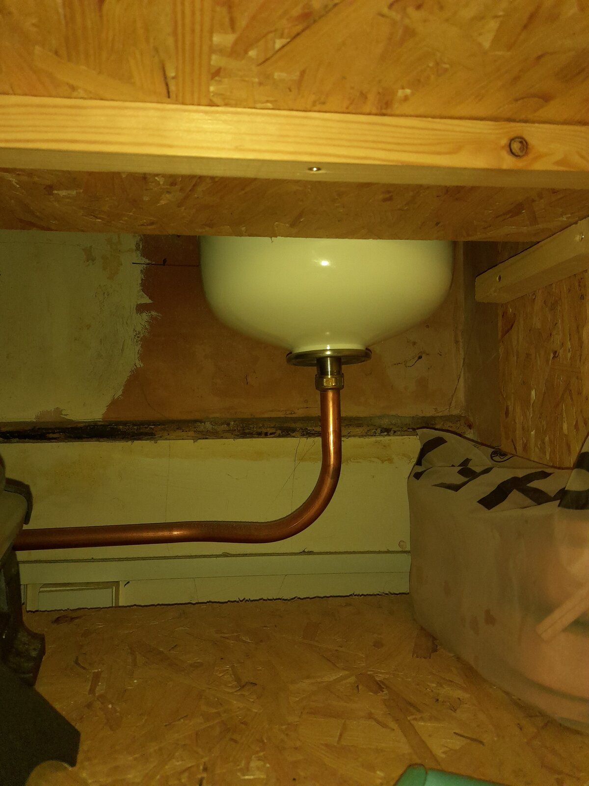

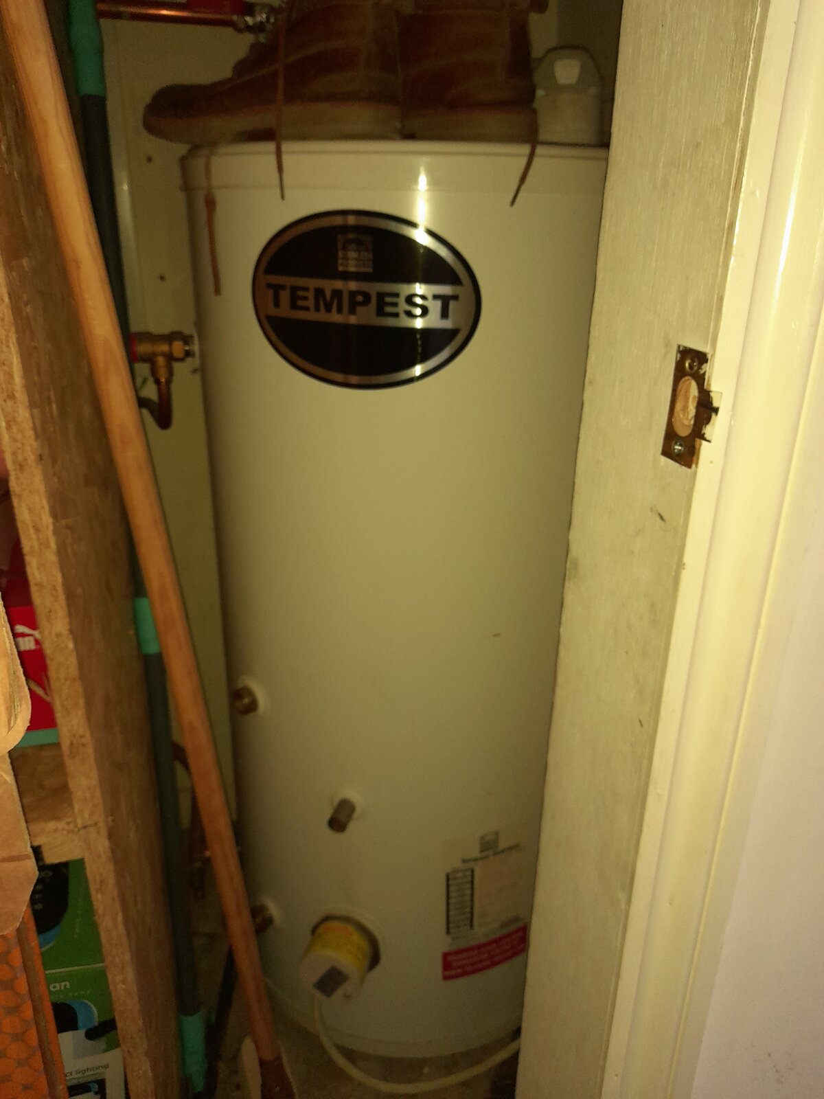

Hi all,
I'm considering buying a flat which has a Telford Tempest hot water cylinder. There is what seems to be an expansion vessel sitting above it and an immersion heater below. I've not seen one of these before, can someone explain how it works?
Thanks, Chris.
Some pics
Looks to be an indirect unvented cylinder being used in electric direct mode.
Mains pressure CW in --- HW electrically heated out from top. Expansion vessel has air in and flexible bladder to absorb the water expansion.
Unvented HW cylinders need regular maintenance of EV pressure etc.,. Google/Bing will explain more fully how they work if needed.
Mmm, Thanks for your response Rodders. So the system is designed to pump water heated in a boiler through a coil to heat the water in the tank? Thing is, there is no boiler in the flat so it must be using the electric element only to heat the water no?

That would just be the unvented version of the same (cyclinder with the coil blanked off and using electric elements for heat). You would loose the pressure advantages of the unvented set up and also have to find somewhere for a header tank (unless you went for a fortic type cylinder)

Is this efficient?
It's as good as you can get for electric only. Hopefully it also supplies a shower as well as the taps.

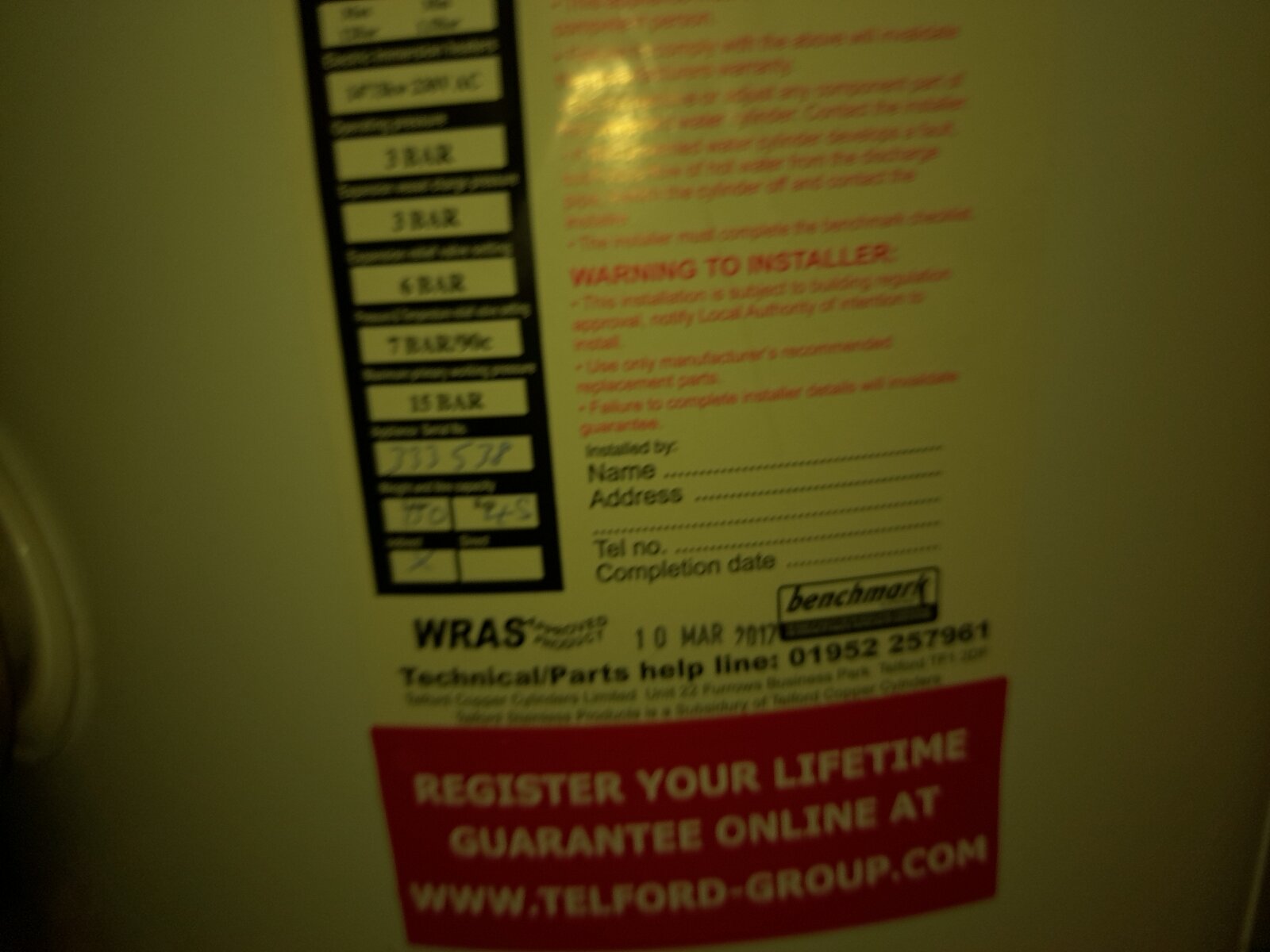

I think the cylinder was put in in 2017 (at least that's the date written on the cylinder itself) so I guess it will be relatively well insulated. Can someone confirm this please?
Seems like the cylinder is a plus point.

Read the Tribune link... it specifies the heat lost per 24 hours for all sizes...
But those style are about as good as you get.
Never any harm in adding extra lagging and on the HW pipes exiting especially as they'll be additional loss sources.

However it looks as if this cylinder already has a secondary heating coil and so could be heated by a gas boiler if you had one installed.
