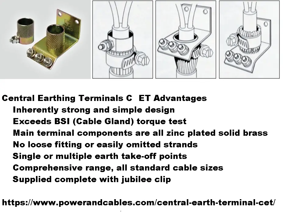

Another purpose designed product for the job which will likely be easier within your restricted space:

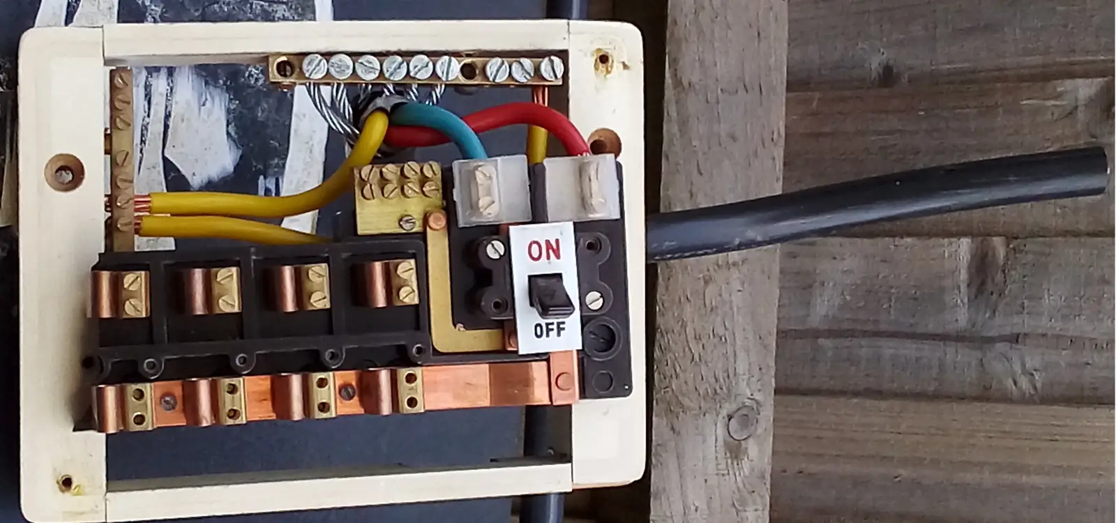

Brass glands are not the only method, it is permissible to treat the steel wires like any other wires, twist a few into bunches, sleeve and terminate.
As an example:
looking at the terminal with the bracket, if the bracket just had a hole in it and you then glanded the cable to the bracket it would be neater
I don't quite follow your comment. These products are used instead of brass glands, where a brass gland is not a suitable or too big/bulky product.
A 20mm gland would probably fit to that bracket and to me at least would be a better termination than bent over wires and a jubilee clip
Any old bit of bent metal will do that just as well.
The whole point of these is to use in situations where a brass gland is less appropriate for whatever reason. These are commercially produced and many thousands of such systems have been in use for years, As said before a brass gland is not the only way.
To fit inside the OPs enclosure the device without the bracket may fit, where a brass gland is less likely to, and yes I have been in that situation and all too often.
