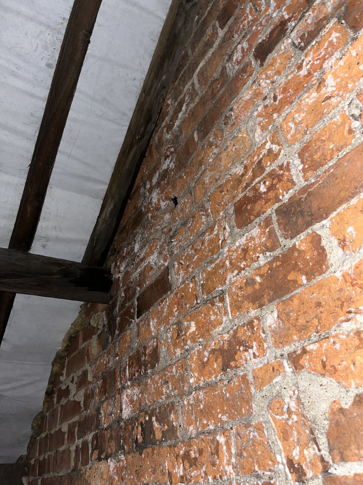

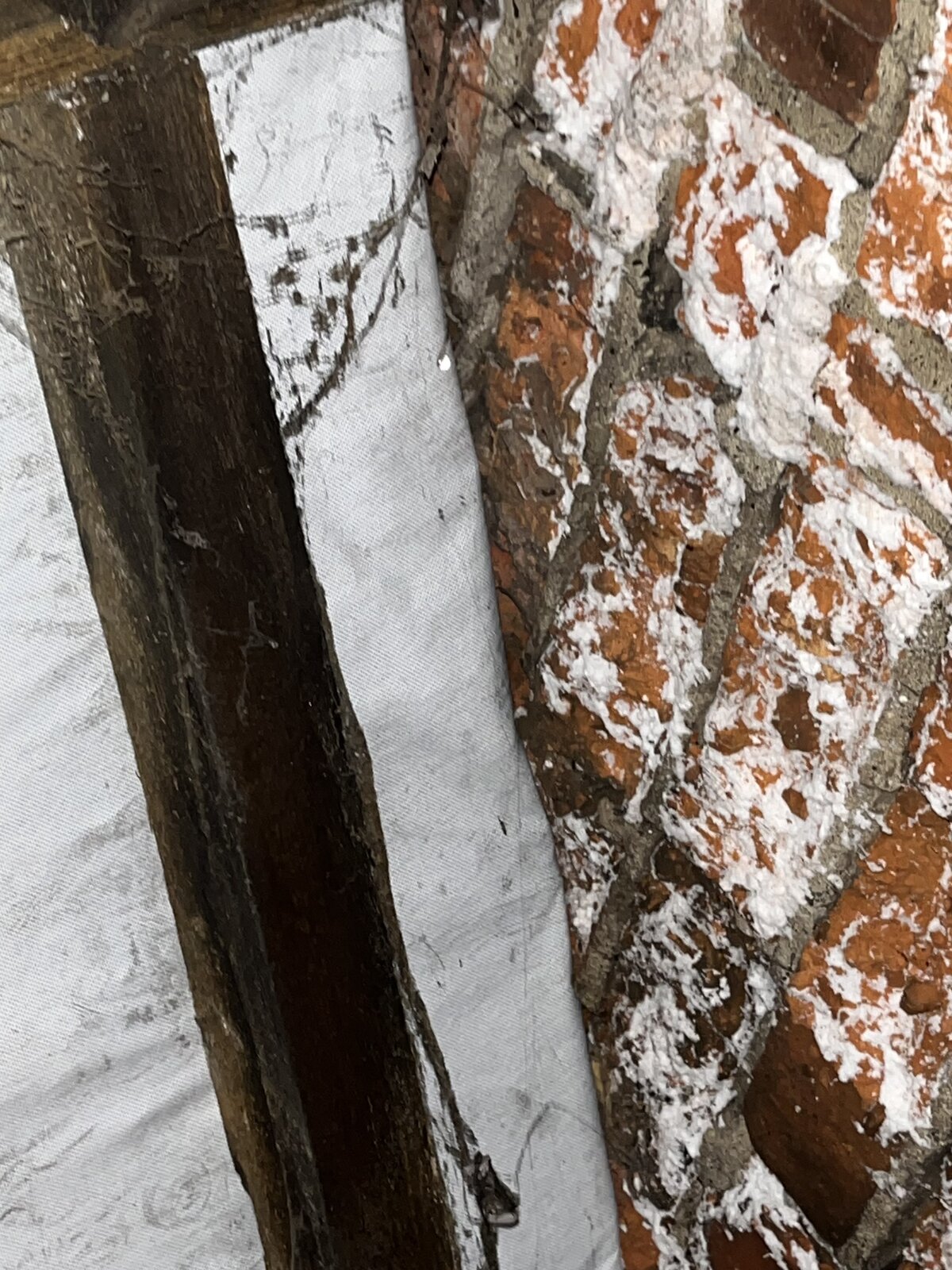

In October I noticed a leak on my bedroom ceiling. I had a leak that was running along the timber frame from the pitch of the roof/ adjoining neighbours wall and hitting my bedroom ceiling.

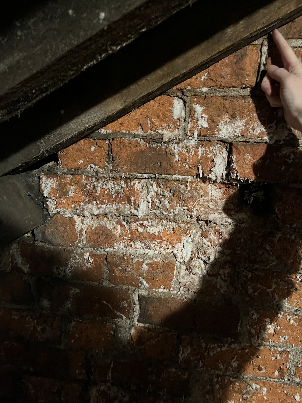

Original leak (wet patches on the timber)
New leak at other end of the roof

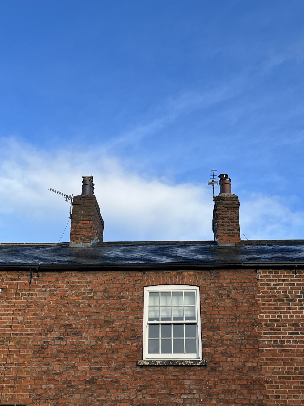

To me, it looks like it’s the original ridge running along the roof. Could that need replacing?

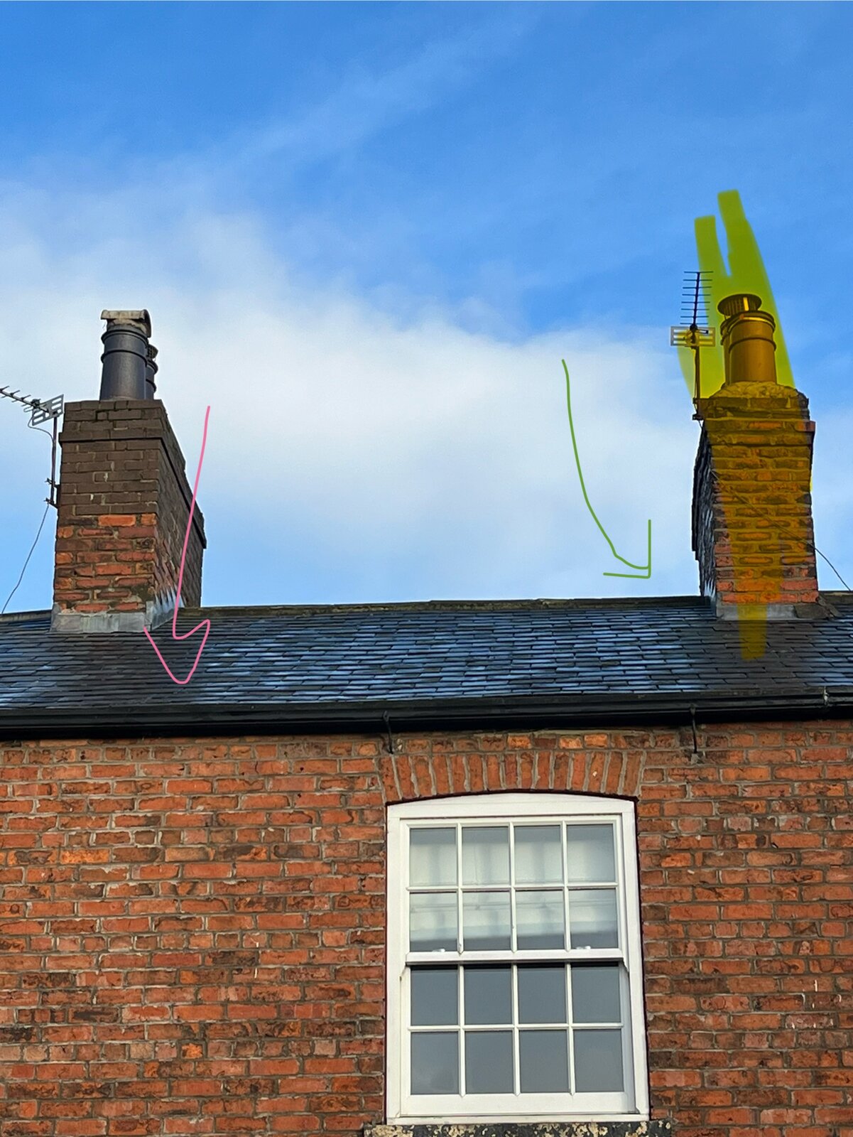

Outside pictures may give a clue

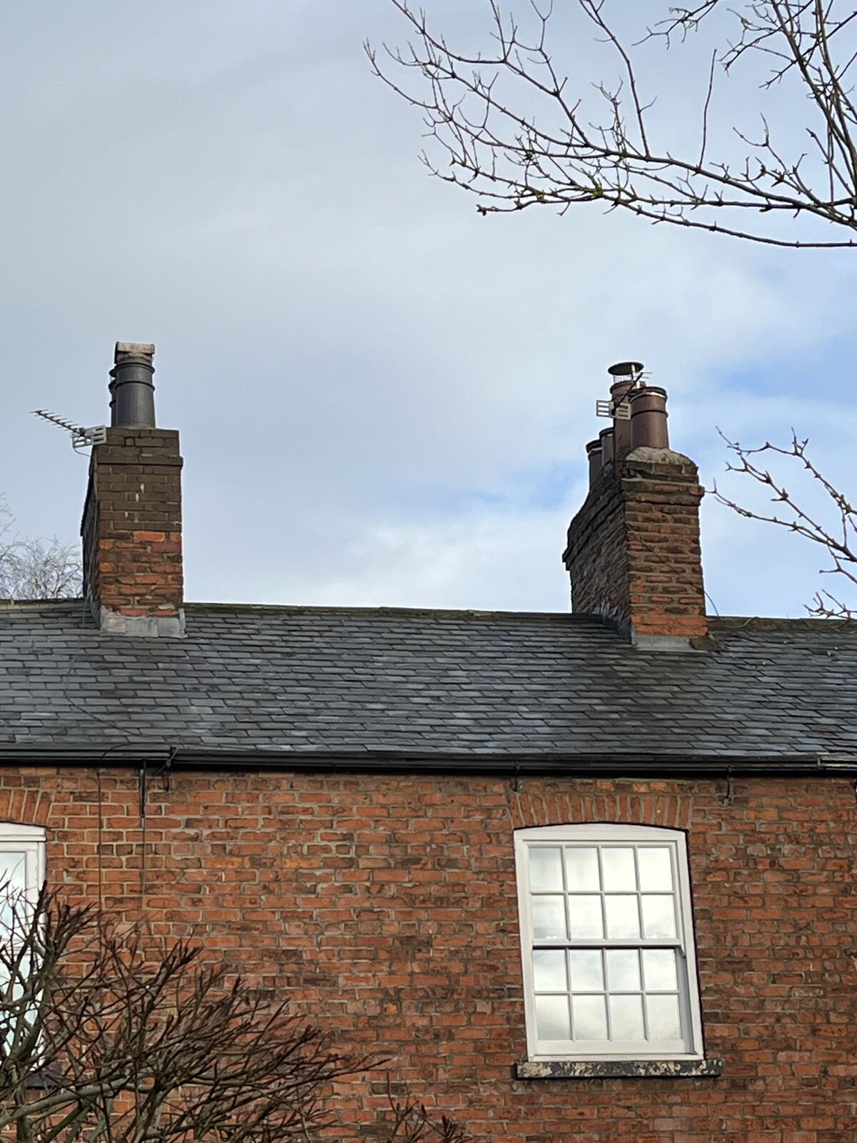

Hi @datarebal

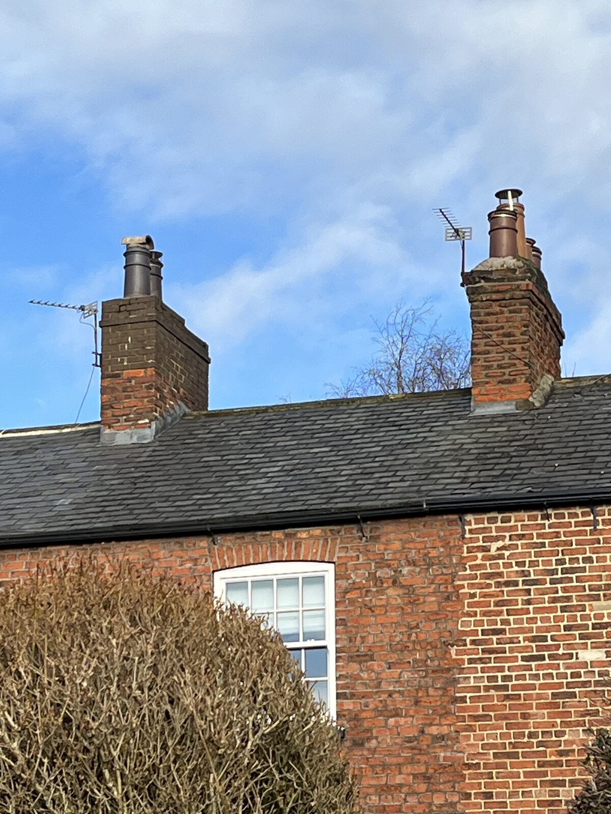

The left is where I’ve had the initial leak and the right is where I found the new one last night. The right chimney services my house (one gas fire)

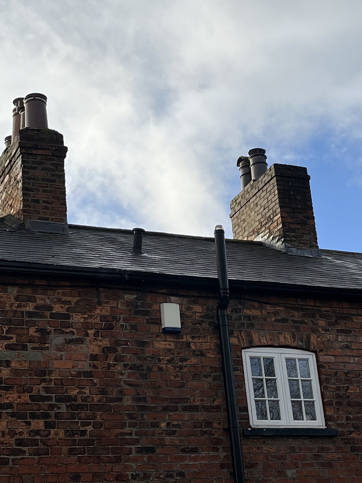

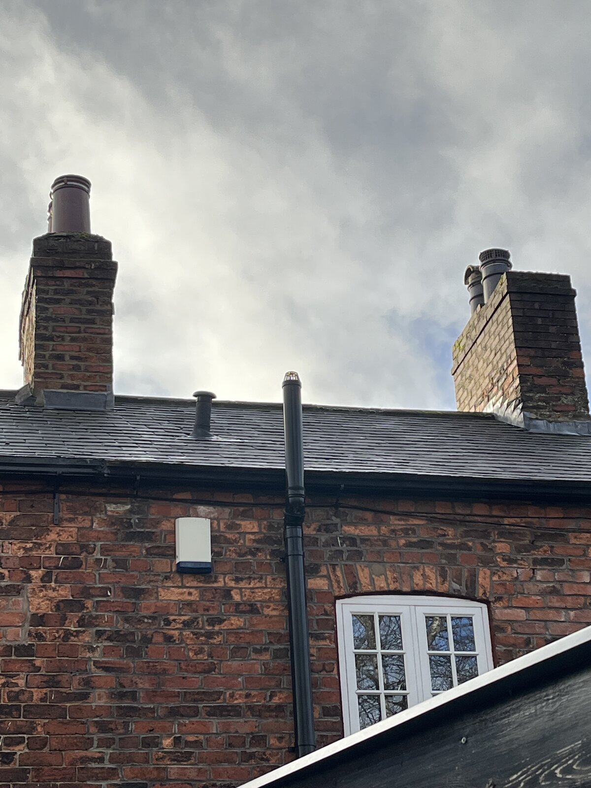

Rear photos

I always struggle when people post lots of photos, to try to work out what the photos are actually of, in relation to their problem. It help considerably if you annotate them, mark them front/back, and which is your property, which are your chimneys etc..
Yes, the ridge looks suspect, so does the cement flaunching, around the left of the chimney to roof tiles, on the chimney on the left, in your last photo. However, I am no expert on roofing issues.
The lead flashing doesn’t look to clever around either chimney.
I’m sure there would be soakers but can’t see any -pics probably too far back
Pink arrow is where the first leak is coming from. Running down the timber, but I can’t see where it begins from when I’m in the loft.
Last night, the leak began where I was pointing from and running down it and dripping onto the horizontal beam and onto the floor.
The green arrow is where the second drip was coming from, but I appeared to look like it was coming from the other side of the roof. Obviously, I know water can get in anywhere and come out from a totally different area.
Yellow chimney is mine. I did ask my neighbour why they only put lead around half of my chimney when they put the new roof on and not all the way round. He assumed it was because that side of the chimney that is (old looking cement) is his side ‍♀️ (his responsibility)
