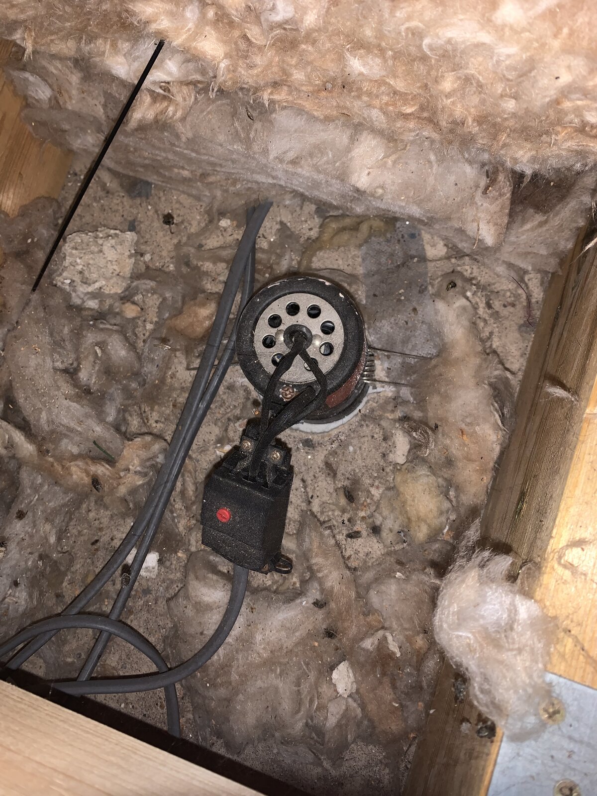

hi all,
Want to top up loft insulation. Current insulation leaves the lights exposed in loft. I read terracotta pots can be used over lights and insulation laid over the top.
From the picture, is it clear that I can do this? I hope it shows enough detail.

The weight of the pots causes plasterboard to bow over time.
Fire rated lights can be covered with insulation. Read the spec for lights for further information

Will need to see what the light spec is, they were installed 8 years ago now.

Just thought, do you think the light’s fire rating will be printed in the light fitting somewhere?
These are very light and can be covered in insulation

Yeah. Look at light markings for information
Thanks again for the advice. Thankfully not mouse droppings, they are dead flies! No dead mice or chewed cables seen I’m pleased to say.
Am I better to drop a light down into the bathroom to read what’s on it or look from above in the loft?

Those lights need covers over them imho

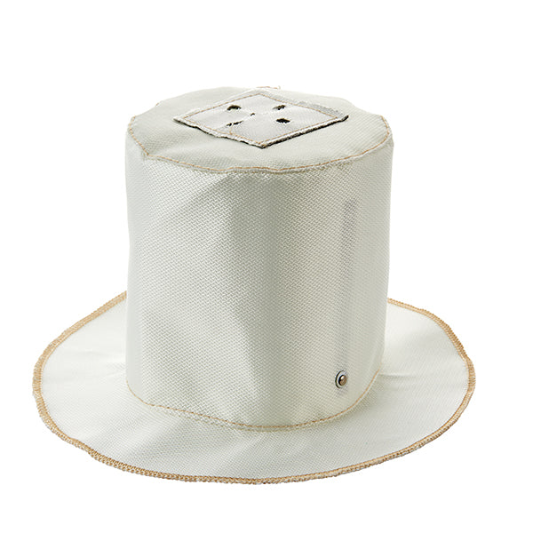

Looks like you have fairly deep joists enough for these. I wonder what the consensus is on these woven glass fibre hats:
Saxby FH150 Small Heatguard for Recessed Downlights

Bat droppings are not a problem, as they contain mainly insects, mouse is another story, with LED the heat from lamps is not so much of a problem, but it will likely reduce the life of the lamps, most LED lamps has an electrolytic capacitor inside, and these have a limited life, which is less if they are hot.
I covered mine with plastic pots. Was easy to make a hole for the cabling.
(All LED, so limited heat)
Those lights look like the back of mine - Aurora Enlite EN-FD101W
