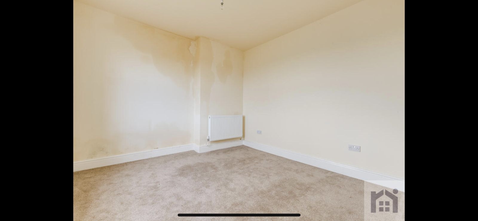

Looking at moving to our next project house and found one that’s a possibility, but it’s got a terrible damp problem.
Not been inside the house yet, but here’s some photos from the estate agents. It’s a 1905 brick farmhouse, so I assume solid walls.

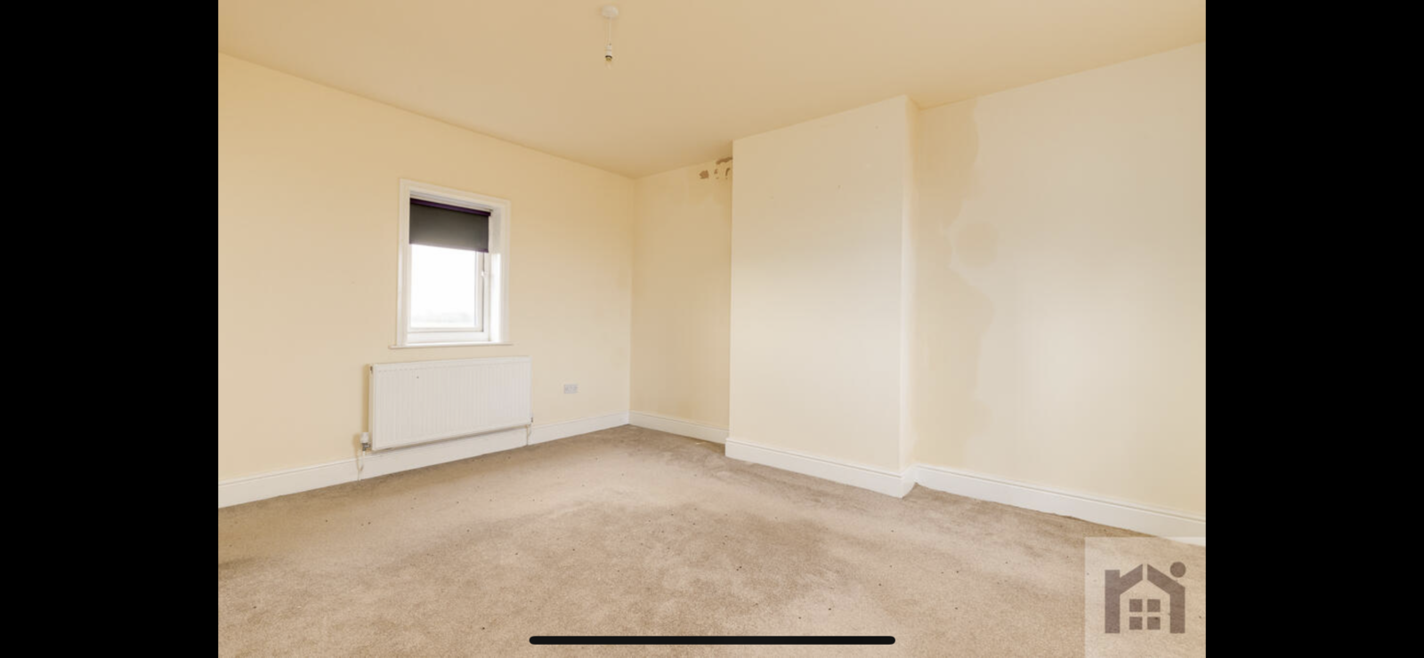

The worst of the damp is around chimney breast (both upstairs and down):

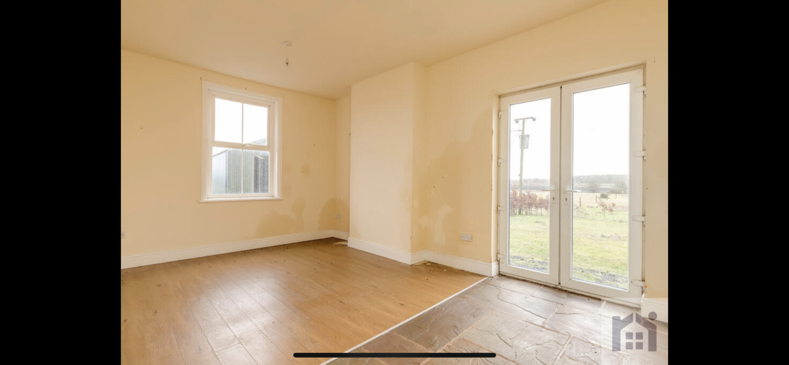

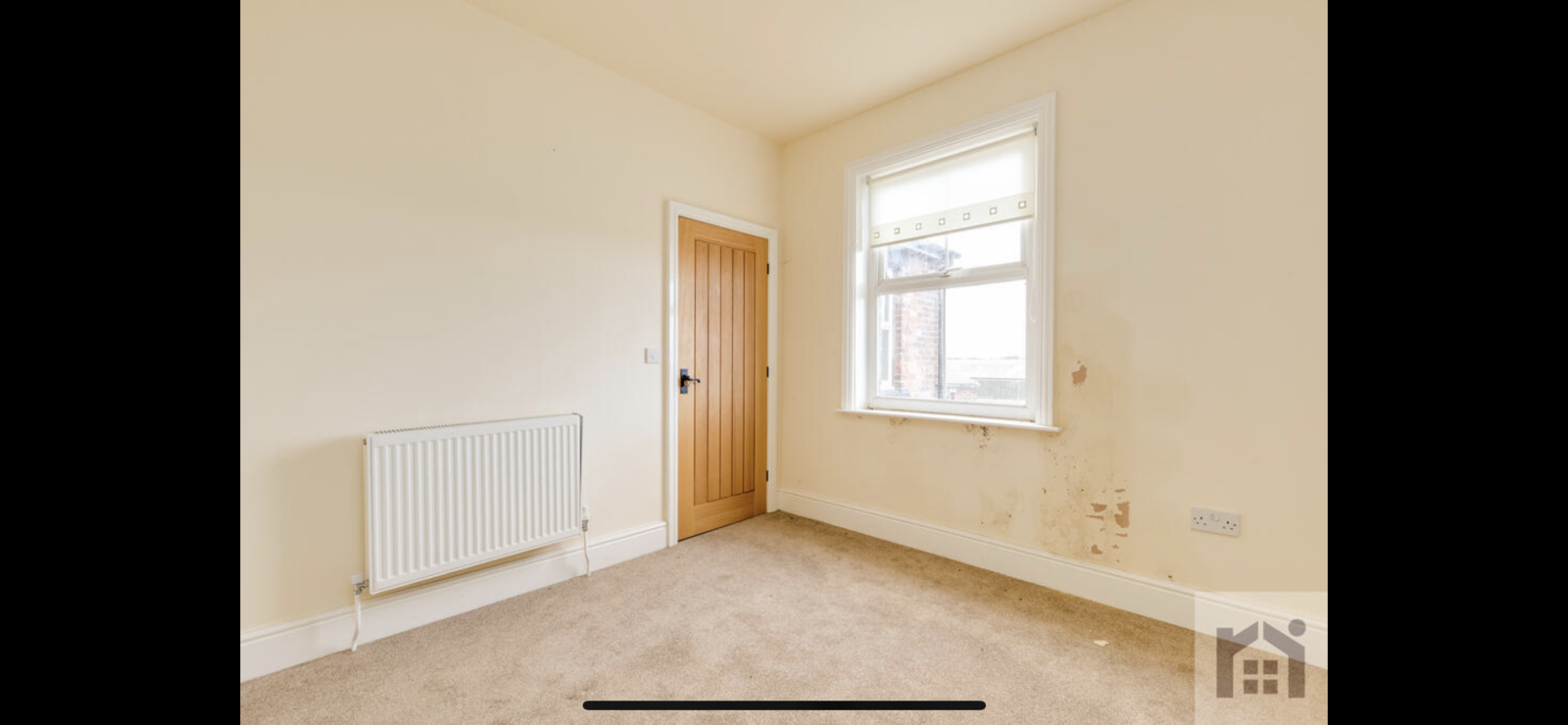

But also on an external wall with no chimney there’s damp all around the doors and around the sockets:

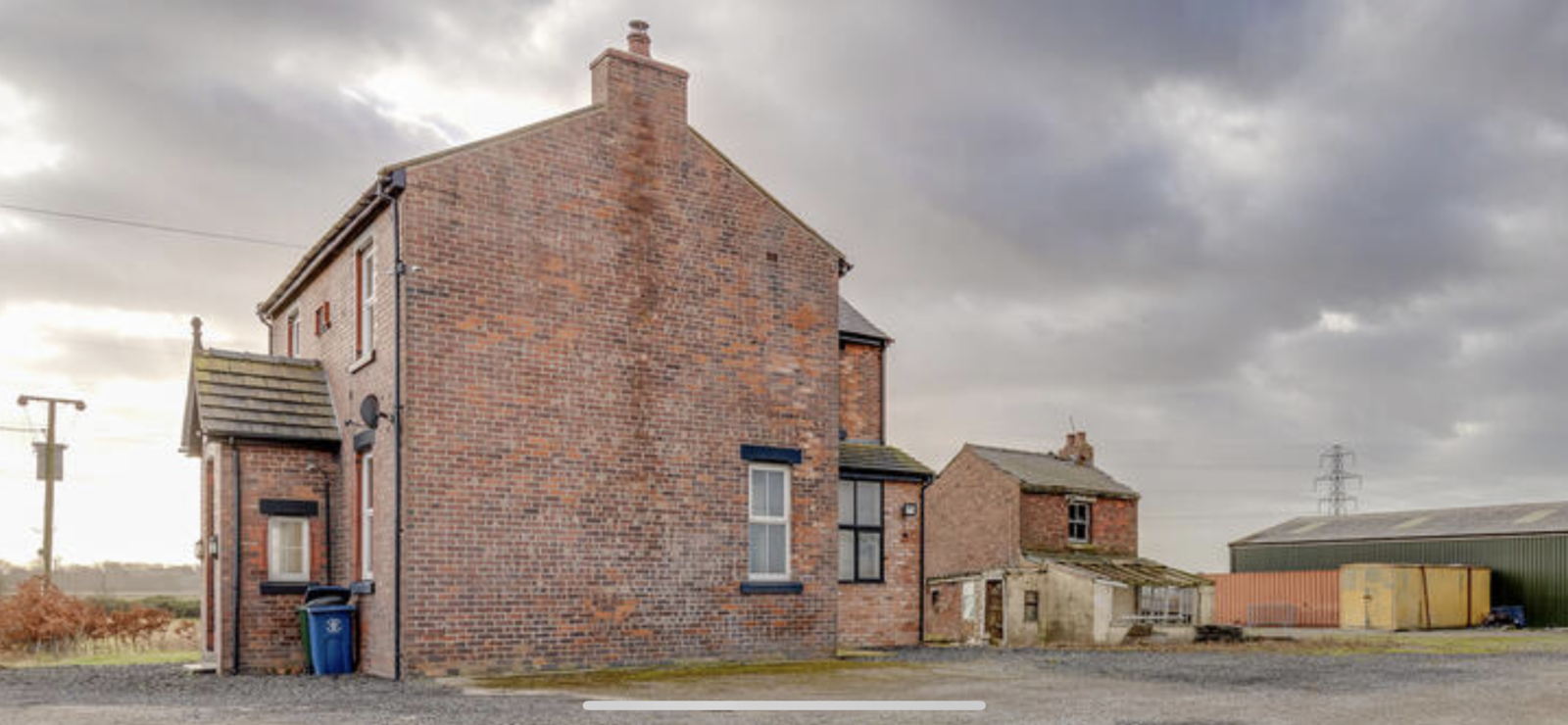

Only got one decent shot of the outside but, as you might guess, the damp corresponds to the discoloured bricks:

Would need more photos of the outside, if the external ground level isn't immediately problematic then your issues are comming from elsewhere.
Usually simple things like roof, gutters, drains.

First photo shows standing water algae outside? Is the drainage in the location that poor?

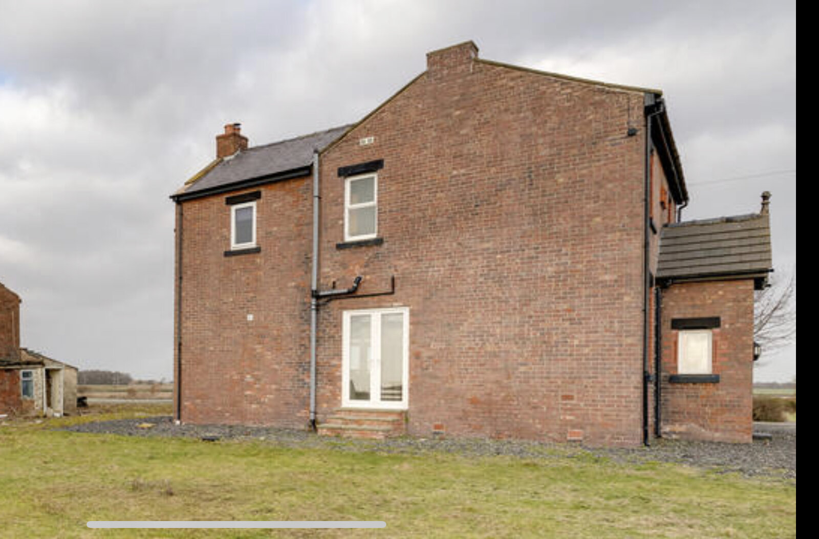

It could just be the photos but the last two show a dark patch around and behind the drain pipe and a diagonal line from a black box up near the roof on the right hand side running down to the waste pipe before it enters the downpipe.
I am not a builder or anything but it could indicate something or nothing?

Definitely seems to be algae as you point out, I didn’t look at it closely when I viewed outside but that’s the north facing wall so it could be moss. I think the ground was more like tarmac to that side of the properly, but the worst of the damp is on the south side (the one with the French doors).

Good eye Old Salt… that is a strange diagonal line. Re the patched behind the drain pipe, that pipe is to the right of the French doors when you’re inside the house, so is on the side of the room that doesn’t seem to be damp.

Only one visible pot on chimney , old farmhouse would have several so may be bodged sealing of the rest which explains all the chimney damp especially if left unvented.
Poor install of door frame would explain leaks around door , you can see it’s letting in moisture top left and spreading as it descends .
Second photo seems to show remains of a parapet wall ? or at least a poorly finished roof edge to the rear wall .
There seems to be nothing over the doors to cast off any rain running down the wall so tracks straight in around frame.

Yes good shout. Only a single chimney pot on each and closed up fire places in nearly every room.
Looks like a capping stone has been lots on that parapet wall too - good eye.
Chimney flashing, flaunching and ventilation all key suspects number one.
