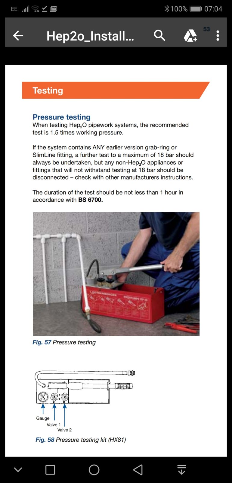

Well, for plastic pipe installation you air test from 1.5x the working pressure, up to 18bar (for older type pipe & fittings) :eek:
