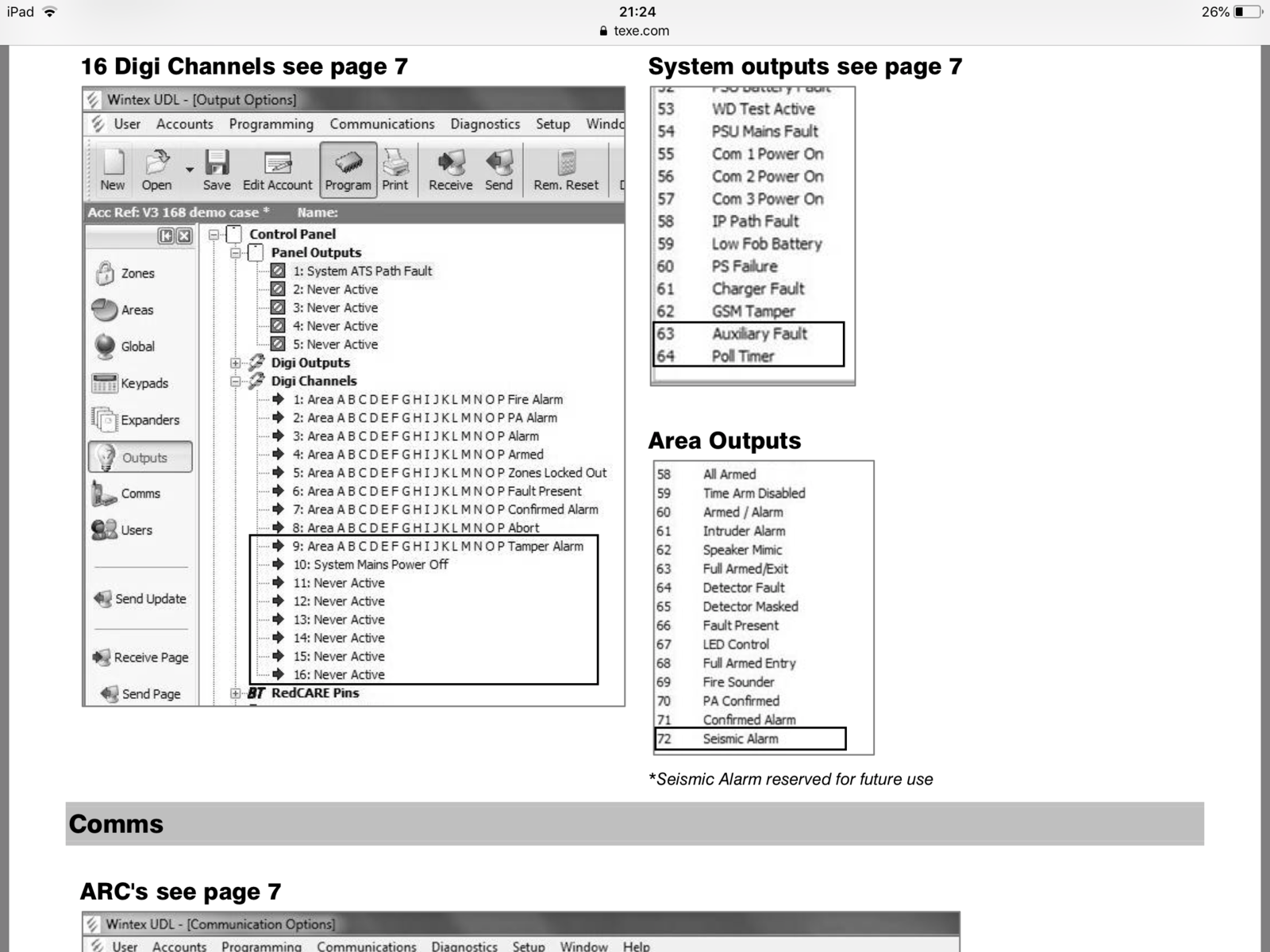

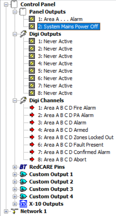

Copy all your settings to panel outputs ....digi settings are what the comm2400 use
oh I didn't know that!
So i've wired in the trigger wires to OP1 and 2 but the tests under eng utilities are now not working either.
Looking a the manual it seems the two panel outputs available to me (Elite 48 panel) are -ve switched, perhaps my device needs to work on a +ve switch.
Which bit have you used ? Panel outputs ( op 1 ,2 )
Digi outputs ( which are the set of connections on the board ) which you can use
Or digi channels ? This is for the comm2400 ( easy to program this by mistake to find the above (outputs don’t work )
Just reading further on your post eg mains fail ...what’s the mains fail delay set at ? As if there is a delay set it won’t trigger until timer runs out )

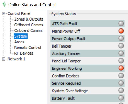

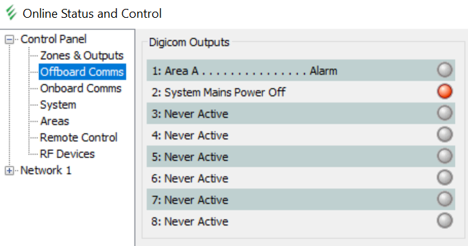

Bingo! @sparkymarka you are spot on. It was the AC mains delay!
I've just also learnt that Wintex diagnostics shows you whats going on with this too.
