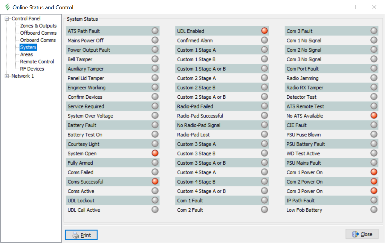

Texecom 64-W "No ATS Available"

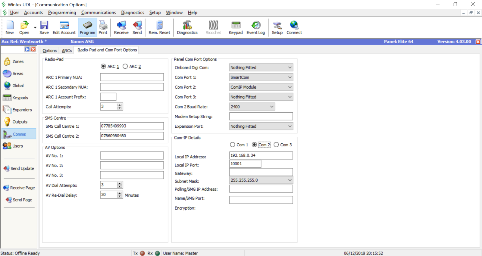

If you can connect via the smart com wouldn't worry about the comip connection for wintex.
This would be difficult to connect to as the comip connection is being used for notifications, so it may be busy.
Also given that smart com at default is encrypted coms and the com-ip access isn't, I would use the smart com.

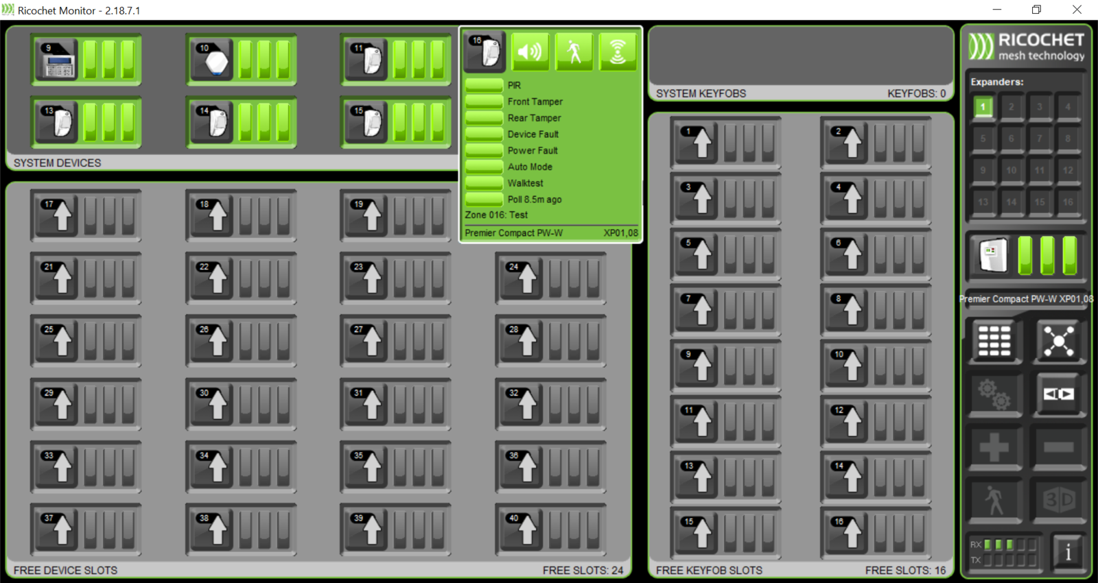

The next problem I have is that the wireless PIRs (4 off GBK 001) are really slow to respond - I can jump up and down in front of them and they don't respond - I'm using the "Chime" feature of the panel to test this. The wired PIRs (4 off ACF 001) work immediately as I wander around the room. Walk test displays the same behaviour. The wireless PIRs "Ricochet Device Mode" is set to "Auto" - I think this was the default when devices were learnt. Devices are mounted about 2.3m from the floor in the corner of a room. I hope its nothing as simple as using Premiere PIRs with an Elite panel....although this shouldn't be an issue as I just purchased a kit from Texecom.

Have you completed the commissioning mode, what signal security and signal strength do you have for your devices?

Ricochet Monitor (which I acceess through Wintex icon( seems to have changed what it shows me since replacing the commissioning link - I no longer get individual signal strengths and the little numbers showing me which devices are "connected" to each other. However what is does show is that everything is green, see below.

New device new mesh possibilities so yes it needs to be done.
To be fair that does not show me the mesh. With the panel(wireless expander) in commissioning mode, have ricochet monitor in network view and see how the mesh looks as its being built.
