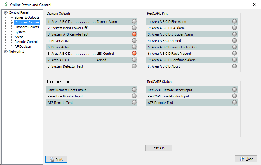

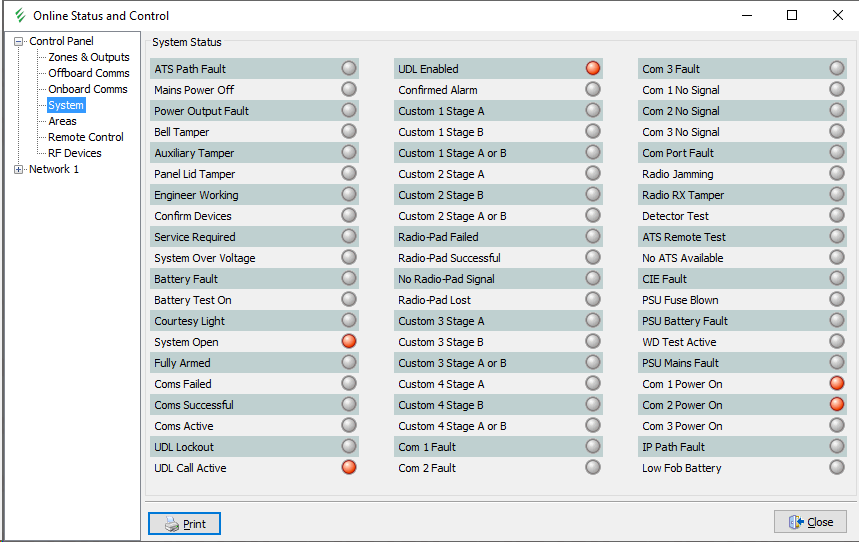

Hi, I hope I can resurrect this thread as I have (had) the same problem as Speedbird979...
I can confirm that swapping the COM1 & COM2 port options and the returning them to normal also fixed my "No ATS" available problem. Actually, I seemed to have an "ATS Path Fault" but on Wintex there were multiple ATS issues (perhaps that is normal if they are all connected issues).
Like Speedbird979, I am not a 'true' installer but I am reasonably competent in getting things working... but equally a little knowledge can be dangerous! On this occasion I thought I had resolved my issue, but I have the following errors that seem to remain on Wintex... please see screenshots. My keypad is telling me to call the alarm company to service the system!
Please let me know if my limited knowledge has reached the end of what I can do?
(Zones 1-8 as far as I know are not used... so not sure if I can ignore the first set of errors?)
