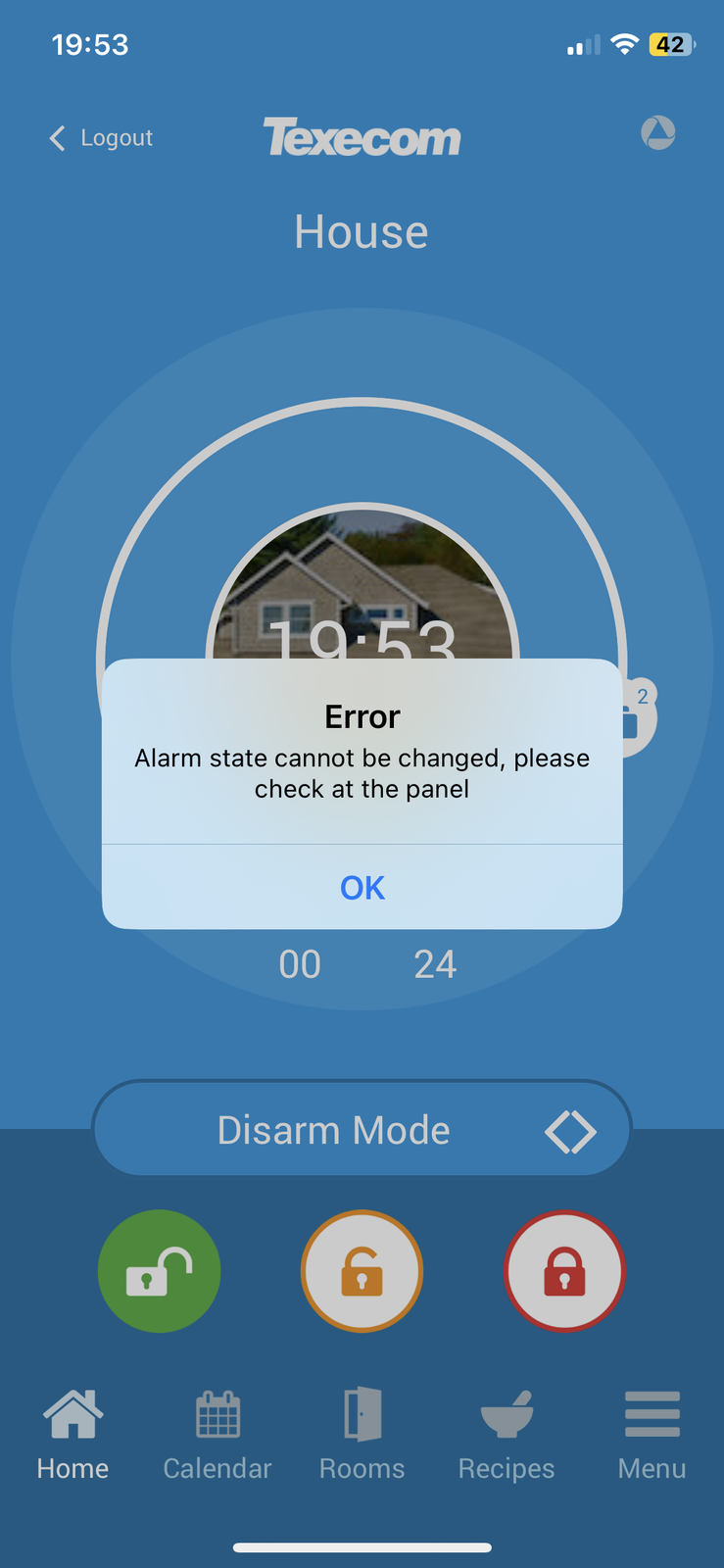

Can’t set my alarm from the app any ideas
Everything on the panel is on and working, the smart com is set up. It used to work fine but now it’s stopped, I’ve not changed any settings or anything. Just can’t seem to figure out what’s going on.

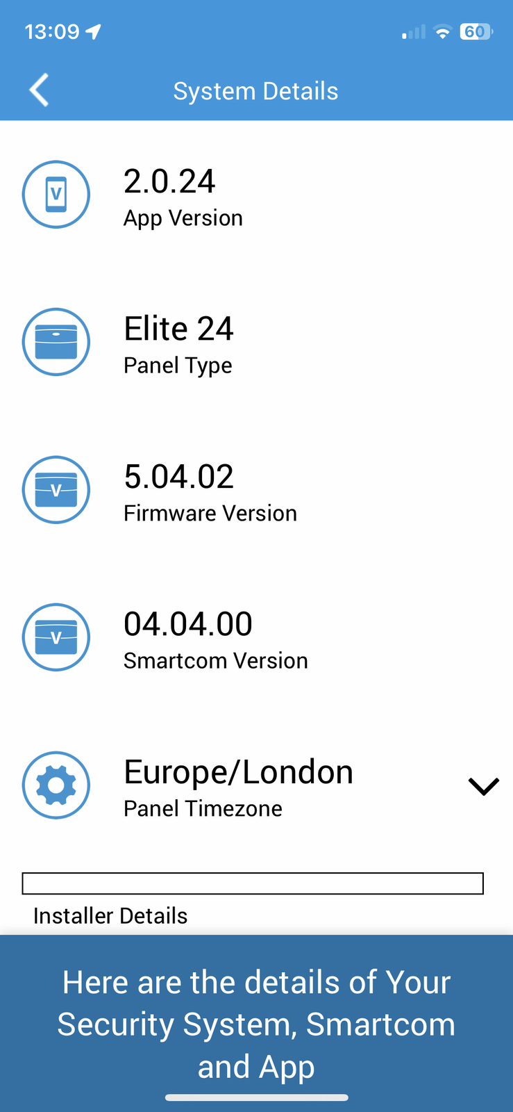

What Texecom connect version are you using V1 or V2 ?
What Smartcom firmware version are you using ?
What Smartcom is installed Wifi/Ethernet or 4G ?
Smart com version and app version etc etc can be obtained in the app by pressing Menu in the app and then system details

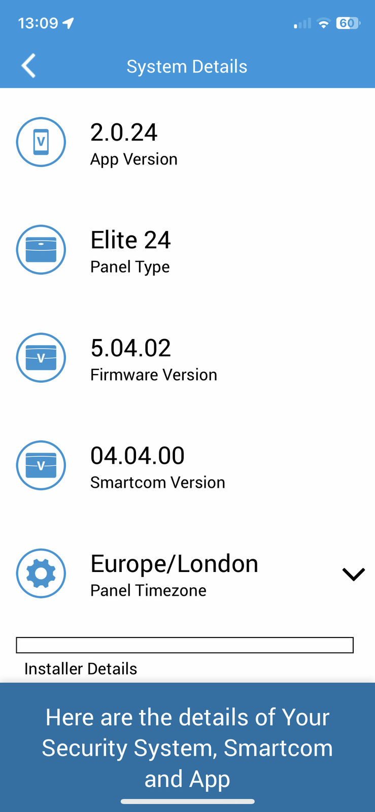

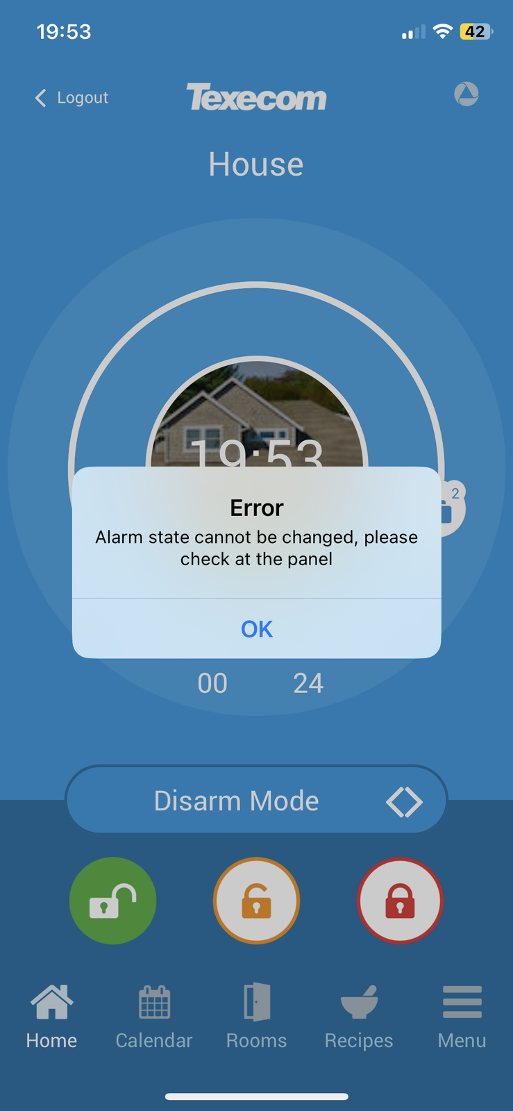

All sorted, on area programming, on area options I had the remote arming and disarming off not assigned.
