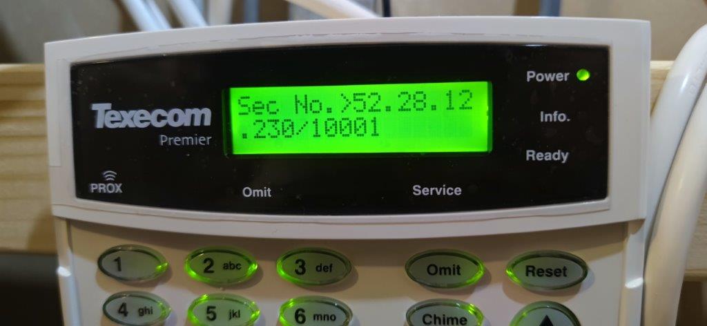

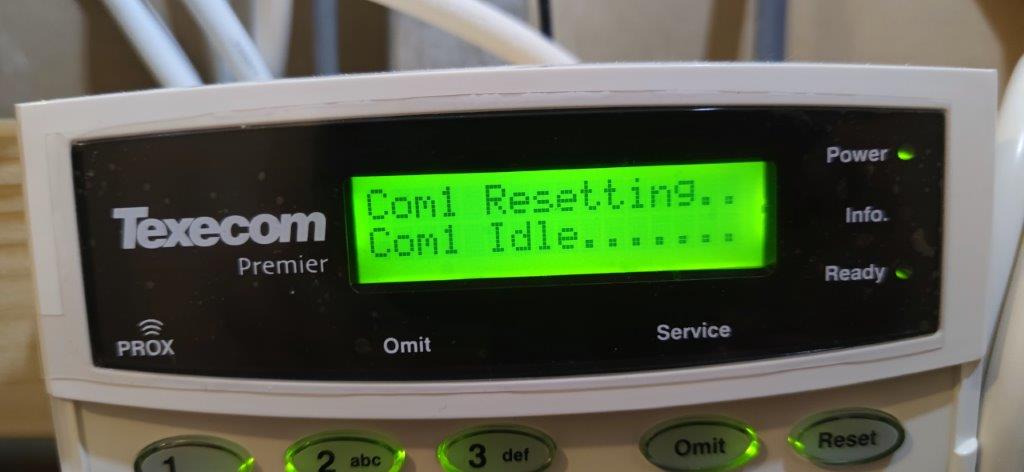

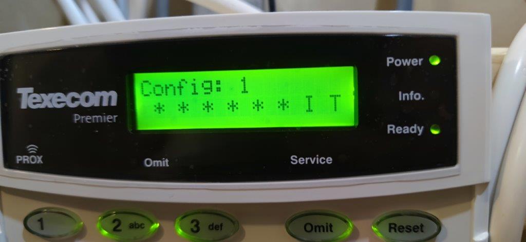

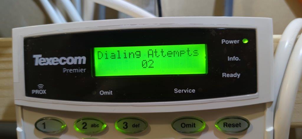

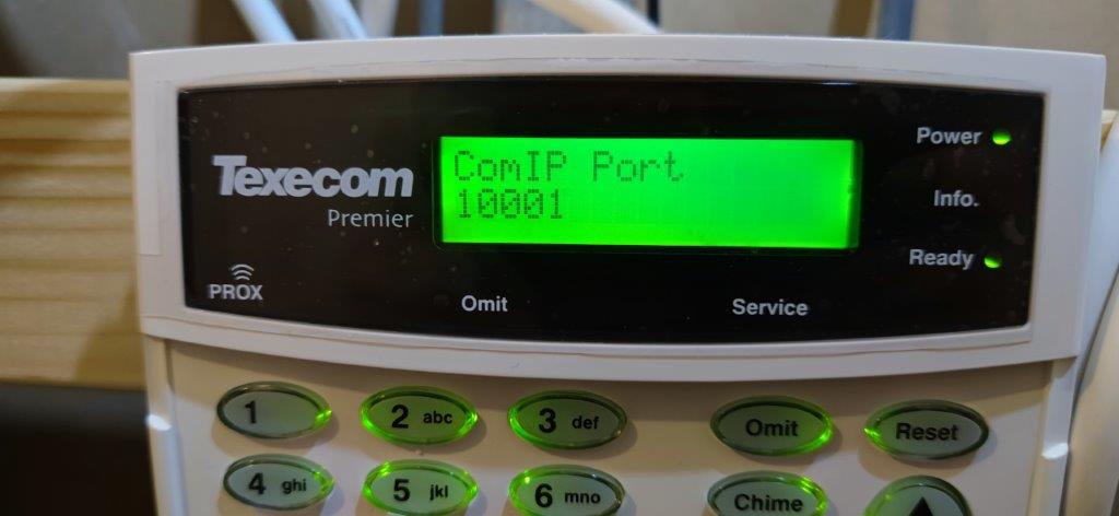

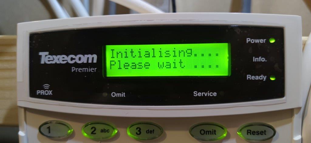

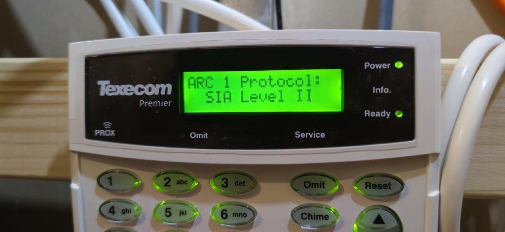

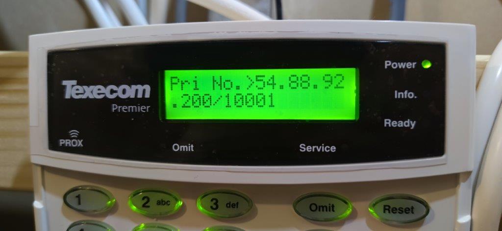

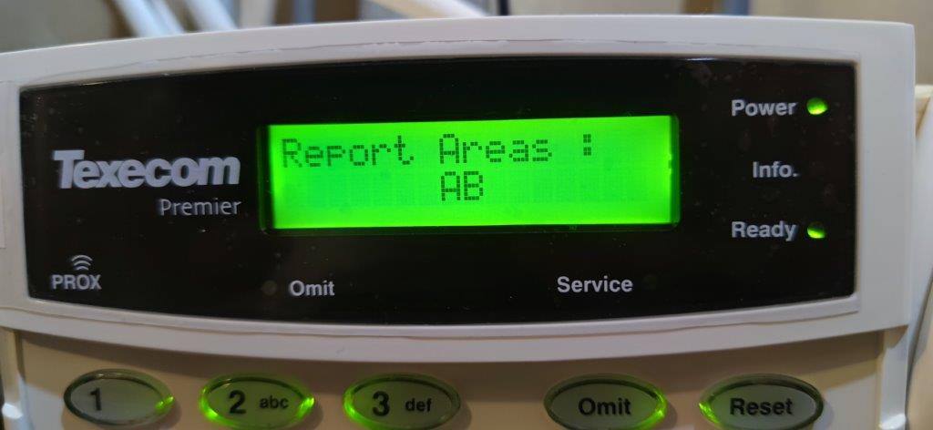

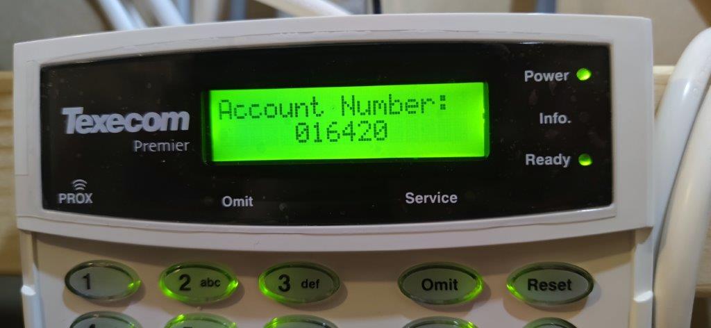

I have followed the COM-IP instructions to the letter and am not getting any notifications, and test call does not seem to work. I have the COM-IP on COM1 and can access both internally and externally OK on both the app and Wincom (so port forwarding is working - though I obviously had to manually set my external IP in the app).
I've taken a few photos of the keypad, to hopefully show that its correct.

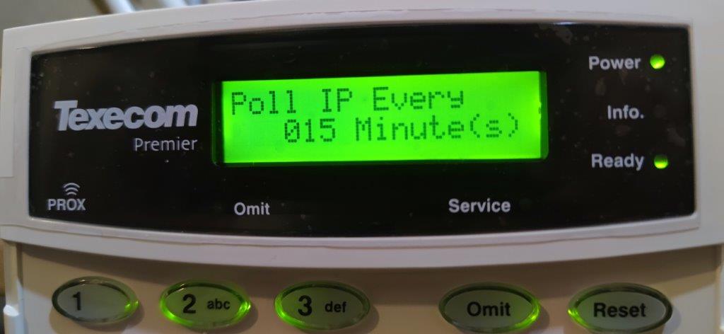

A couple of things I have read on here is to reset the Com port, and to set the polling to 1 min (because if its working it should eventually update itself to 15 minutes and therefore is working).
Any other suggestions would be much appreciated.

I did wonder if I could install Montex locally and at least see if panel does push anything out? I will try the Com reset first (when I get home)

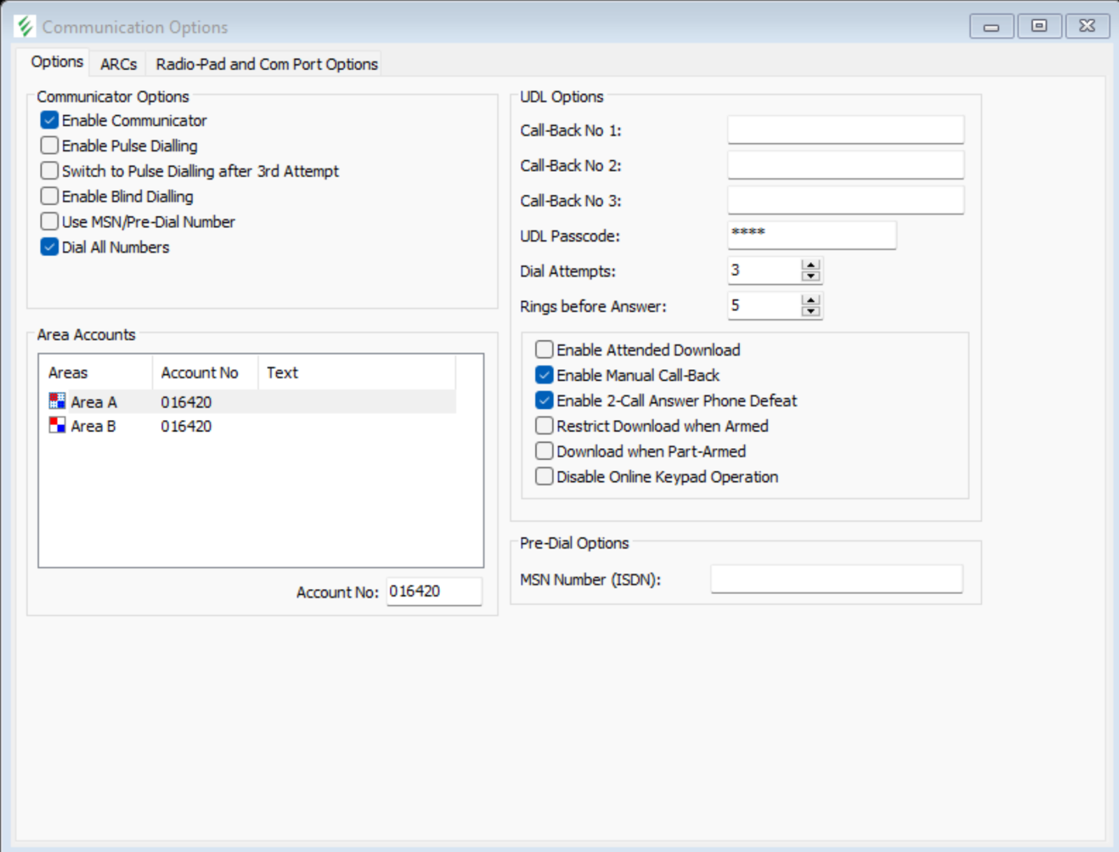

OK, got home and had a bit of a play. Compared my settings with a good friend who is very knowledgeable about this panel. In his config, within Wintex I could see that under 'Communication Options / Options' the area accounts had the account number under them (generated from the app). In addition, under 'Communication Options / ARCs' within the 'Protocol Options 2' all the ComPorts were selected. I changed this and did a test run and it looked like something was happening (could see traffic messages on ComPort 1 on the keypad). However, I still did not receive any notifications in the Android app or by email.

Firstly the comport in use should be the comport used for com ip module.
so sending data if plugged on comport 2 then comport to inthe second configuration in program digital would be set screen of keypad not shown.
the wintex profile shows all 3 comports in use which it shouldn’t but that won’t affect signal so much other than it tries to send on all 3 ports potentially,
note 1 way traffic at a time so connecting via app or wintex can stop out going messages.

I did wonder why he had all com ports enabled also, and did last night change it to just com port 1. That said, when doing a test call it still seemed to try all com ports when looking at the keypad...

when the smart com was introduced they changed the program digi to include which comports it send data through.
so 1 x comip module connected to comport 1 you would program to comport 1 for sending the signal out in config 2, your screen shots are up to config with ip mode and text selected.

As a test I did set the polling to 1 and a while later it was back at 15 minutes, so at least that is working...!
