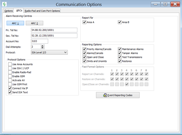

okay, if that's the case it sound like you haven't had the app setup for notifications properly. Assuming that the panel is setup correctly, from the screen shots it would appear to be, then if you have done the port forwarding on the router.

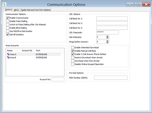

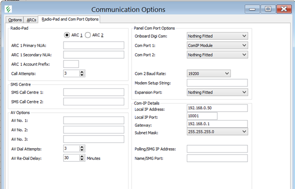

Below screens shot of Wintex :

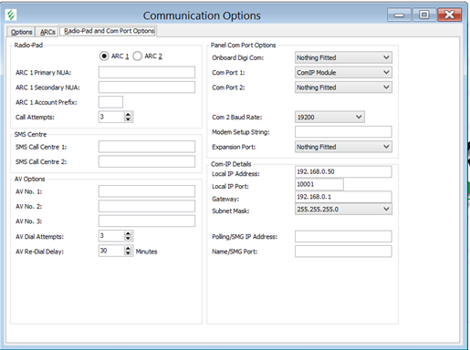

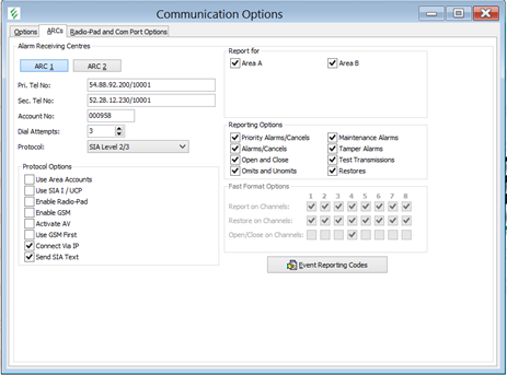

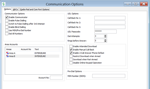

Hello,
I have make a mistake with screenshots :

Hello,
It's work :D:D:D
I realized my mistake.
When setting on the keyboard, I did not use the account provided by Application ...
Now I can leave on vacation quietly :whistle:;)
