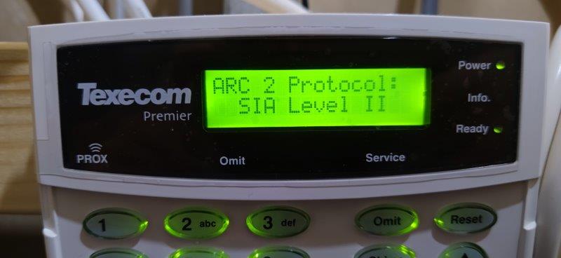

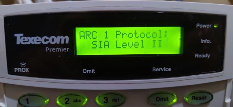

ARC1 programmed as
ARC2 programmed as

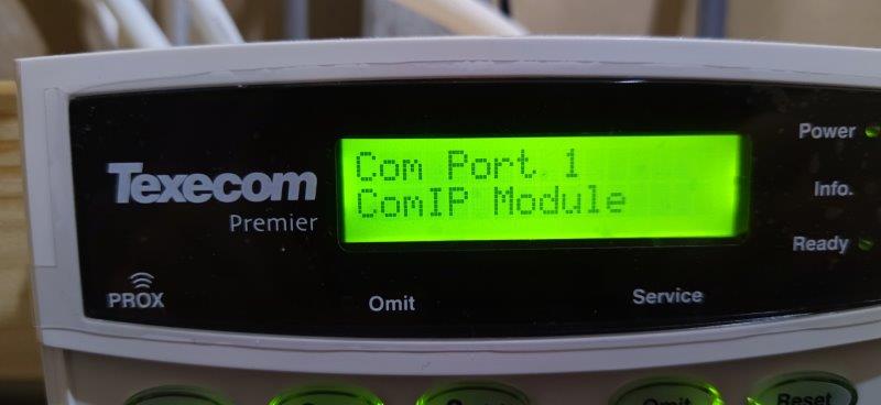

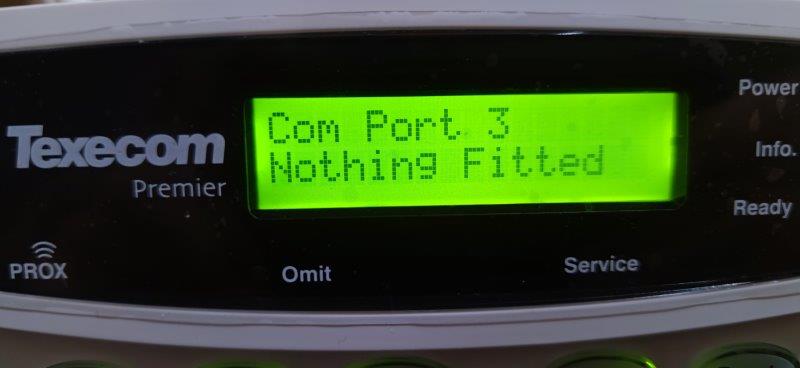

Physically, the Com-IP is attached to Com Port 1 and configured as such. In all three ARC configs 'Protocol Options 2' I have all ports toggled to 'on' (because when I had them as just 'Use ComPort1' I lost all messages going out).
that means your sending down all ports (1,2,3), so sounds like the system isn't right.
com1 and com 2 are next to each other on all panels 12W/24W48W/64W/88/168/640 except the 24, where they are at other ends of the board from each other.

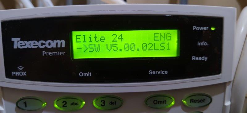

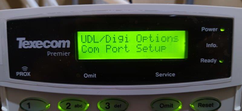

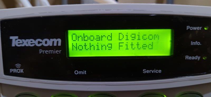

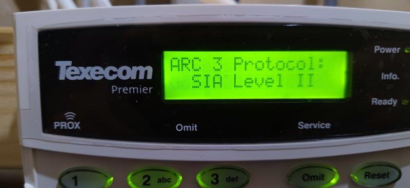

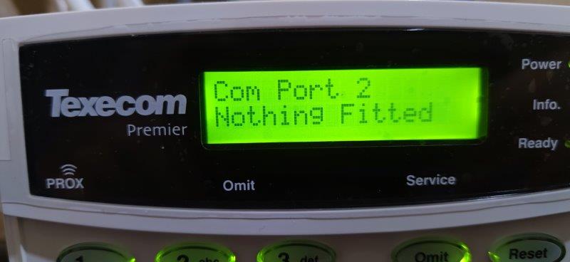

You also haven't sent the keypad screenshot of that setting or how the comports are programmed, what panel and version of panel are you on (menu 4 on keypad).
Will do... I'm away again this week. Will take screenshots as soon as I get back.
I seem to be in a position now where I get notifications on the app, but no emails. Emails are generated at Texecom end, so guess there is not a lot I can do from this end to fix that. I note that the more I dig around in the Digi menu I end up with ATS faults (which sometimes I can clear). When I get a chance will text alarm. As long as get notifications, then I can live with that setup.

but you should not send down com 2 and 3 if the comport in use is actually com1.
Looks like it is all working as should be so guess this is resolved. I still don't get emails, but I can live with that. I have totally removed ARC2 & ARC3 now, and have set ARC1 to Com Port 1 only.....
