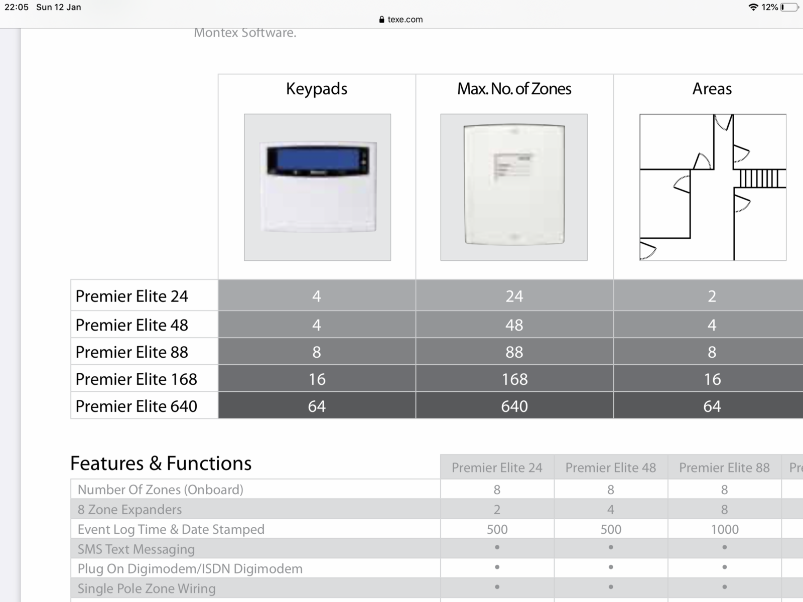

new to the forum and hoping for some help.
I have the Texecom Connect App and wondering how I activate the Panic Button as a 4th button. I have tried to enable the emergency button but this doesn’t seem to work?
You have to assign last keypad possible ( even if does not exist ) on the system the panic function
Last keypad
12 Keypad 2
24,48,64 Keypad 4
88 Keypad 8
168 Keypad 16
640 Keypad 64
