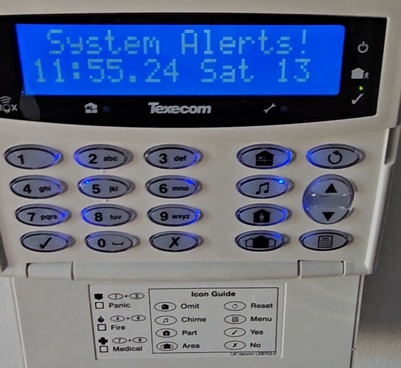

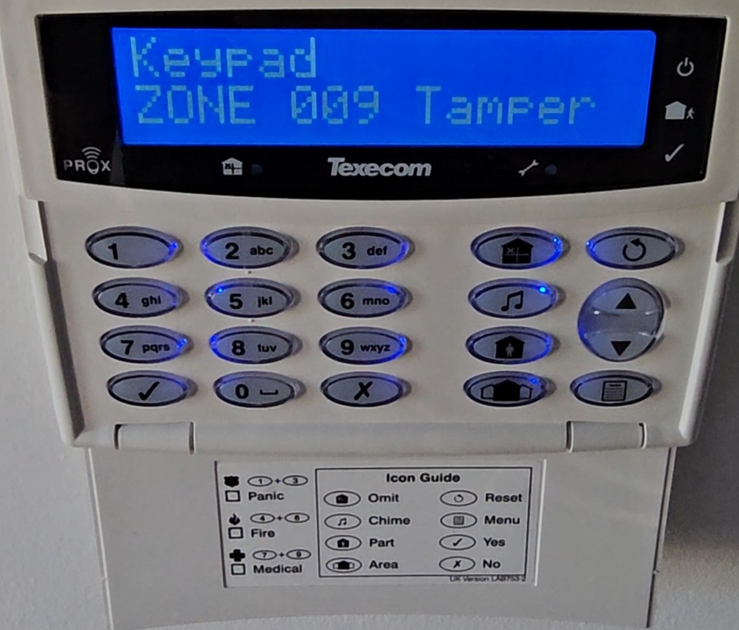

Hmmm... Had a few more keypad tampers recently... It looks like they might get triggered by changes in temperature in my hallway? Not sure... Do you think it's faulty (and needs replacement) and/or are there other elements I could check apart from the batteries? Thanks a lot :)
Also took a video if helpful... and attached a screenshot
I think its more likely that its not seated correctly and as the temperature changes the difference in expansion and contraction make the difference.
need side and top views and the back plate view.
