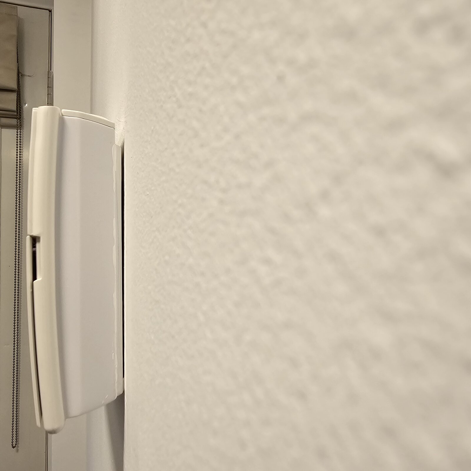

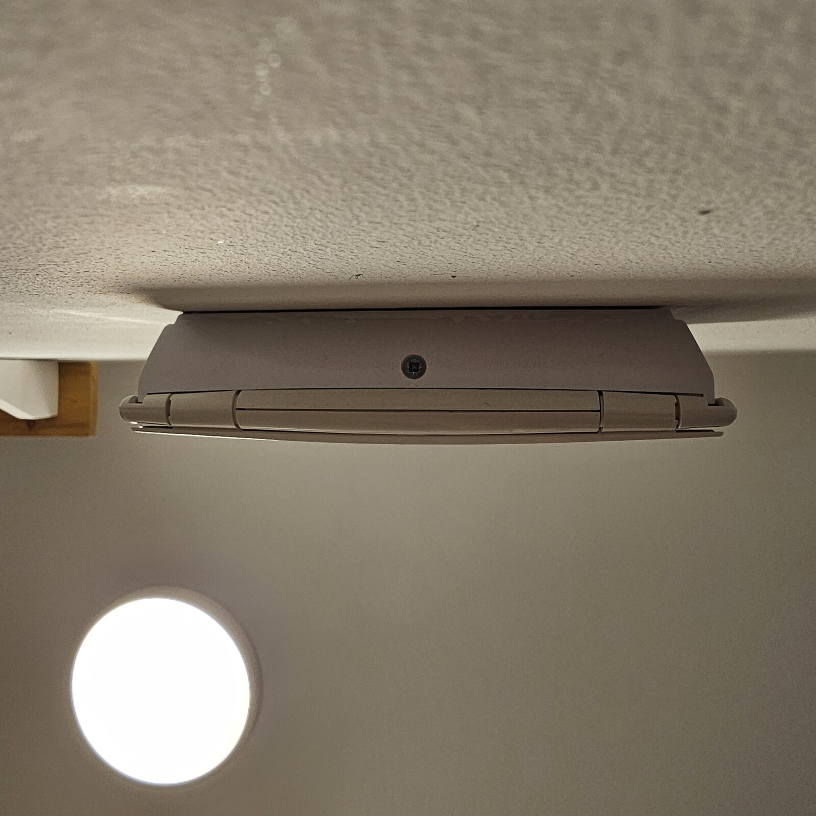

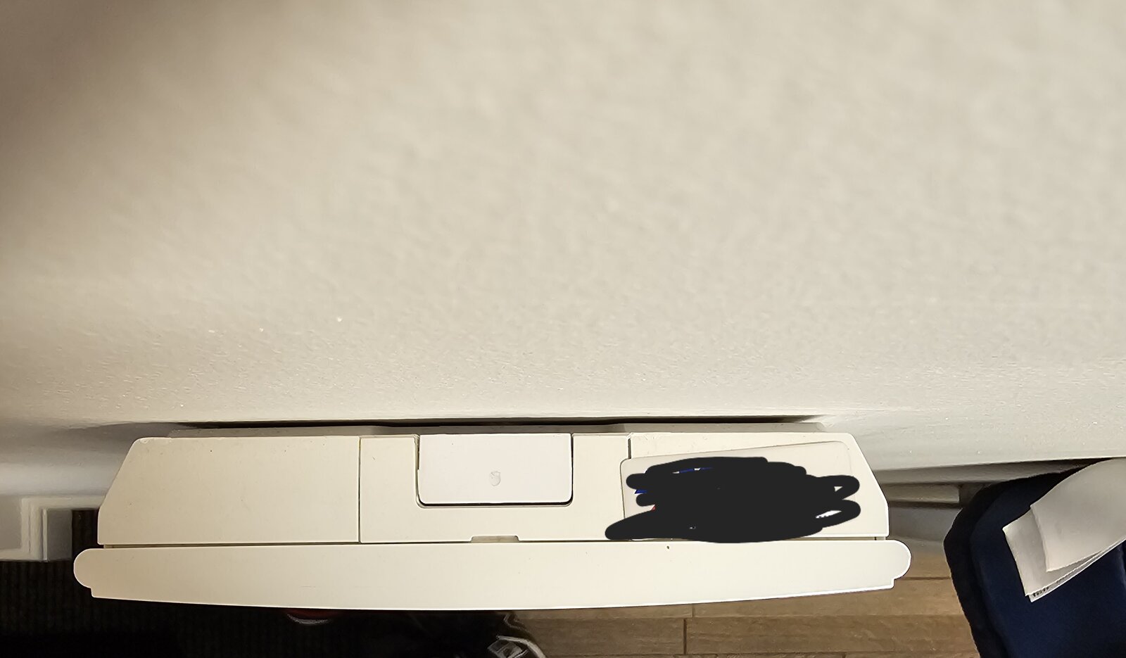

Texecom Elite 64 Keypad starts ringing - alarm stays silent
I think its more likely that its not seated correctly and as the temperature changes the difference in expansion and contraction make the difference.
need side and top views and the back plate view.
Cheers mate... Attached the pictures

i cant be certain but its the ,ot logical other thn ensuring others are tight
Thanks mate - will try and tighten them a bit. Also noticed that my charm settings were turned to silent since I changed the batteries I summer. Might be related - but not sure... Will keep you posted if the tamper alerts come back
Thanks a lot!

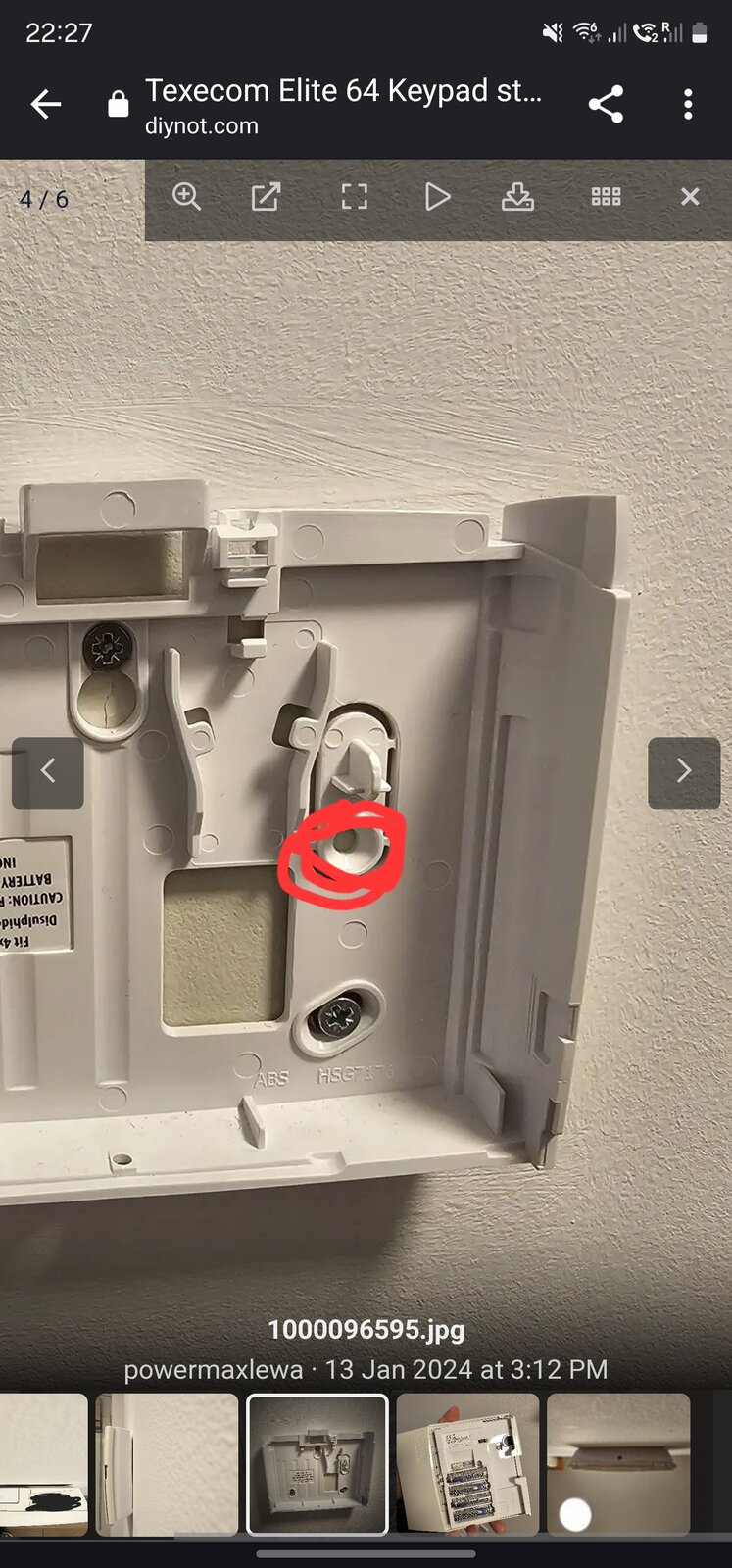

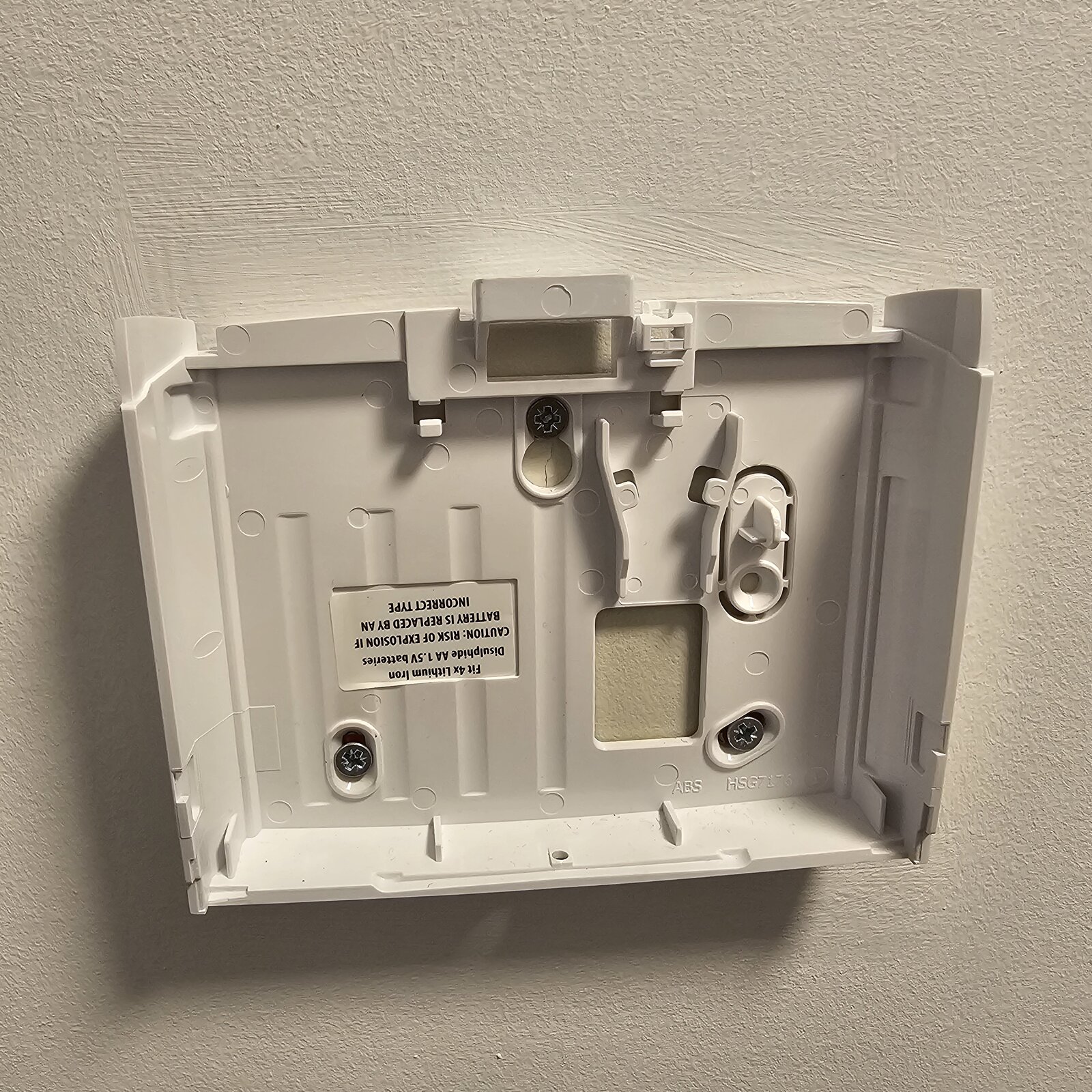

I don’t fit texecom wireless keypads BUT ….shouldn’t there be a metal lever ( as per normall keypads ) on that tamper switch ?
Not sure myself... But it worked fine all this time... Perhaps a general software or hardware issue
No idea on tamper switches they have been moving to sensors for tampers.
